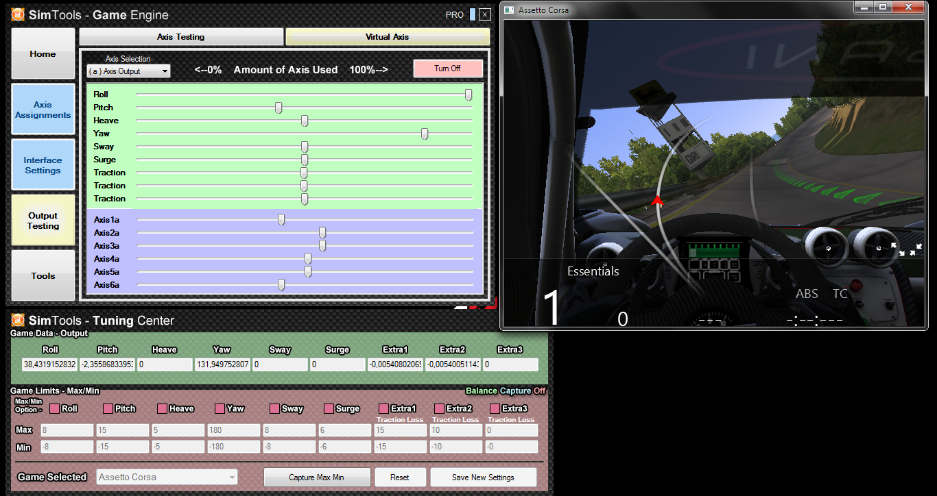

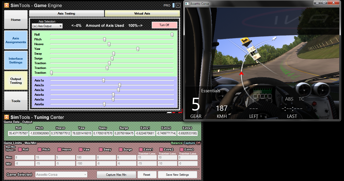

    Hi @value1 , I have a question.
    I built a simulator and started to ride assetto corsa and iracing. Is it possible to create a plugin that will also react to G forces ?? I mean, for example:
    when i stop car on this corner (speed 0km/h) my simulator is tilted to the right
    but when the I drive the same corner at 187km/h G-forces throw me out, its mean that the simulator would be tilted to the other side, but it isn't
    I can imagine that the pitch and roll value depends not only on the actual position of the car, but also depends by G-forces ????
    Thanks!! :)
  4. Historiker
    2,163
    9,212Coins
    +2,181 / 19 / -1
    When you are stopped on a bank the effect is roll (tilt to the side). The effect that pushes you toward the outside of the curve at speed is sway. You can adjust and play around with these settings in Simtools to get the effect that you want. The plugin already has these built in.
    Turn Roll down and Sway up, you can see from your pictures that you only have roll turned up.

    I have a slightly different feeling, in the beginning when I had a reversed direction roll and the sim tilting on the "wrong" direction my body felt like I was thrown out. I do not mean sway because this movement will not cause long-lasting feelings. Only when my sim will be tilted and I will slide from the seat imitating this way of throwing out of the turn. Sway gives only a short feeling.
    I know that sway in the real world is throwing out of from turn, but I think that this force should be simulated by the roll in the simulation
    I think the "roll" would be a very good supplement for "sway" for simulate this force on full length of curve. In my opinion "sway" gives the feeling only at the end and at the beginning of curve. Same pitch in acceleration and braking for surge.

    OK, my mistake, scratch what i said ;)
    I checked my theories and changed "sway" to "roll" and "surge" to "pitch" and it is very wrong settings ;) forget about it and forgive me, i'm still a newby simulator user :p
