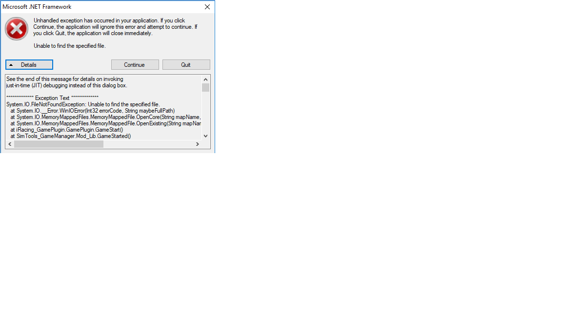

    @value1 We're seeing a new error that is preventing automated use of Simtools for iRacing:
    Machine:
    Windows 10 1803 17134.407 freshly installed on Nov 1, 2018.
    Only used for iRacing.
    1) Both GameManager /GameEngine and the iRacing web page launch at computer startup.
    2) When 'Test' is pressed and the iRacing application launches, GameManager reports a .NET error while attempting to access iRacing's shared memory file:
    System.IO.FileNotFoundException: Unable to find the specified file.
    at System.IO.__Error.WinIOError(Int32 errorCode, String maybeFullPath)
    at System.IO.MemoryMappedFiles.MemoryMappedFile.OpenCore(String mapName, HandleInheritability inheritability, Int32 desiredAccessRights, Boolean createOrOpen)
    at System.IO.MemoryMappedFiles.MemoryMappedFile.OpenExisting(String mapName, MemoryMappedFileRights desiredAccessRights, HandleInheritability inheritability)
    at iRacing_GamePlugin.GamePlugin.GameStart()
    (Full stack trace and an image of the popup are attached below.)
    3) Closing the window or selecting 'Continue' or 'Quit' will terminate the GameManger process, and SimTools will not function.
    This error occurs almost every time (>90%, but not always) for fresh restarts of the system.
    We have reproduced this failure on a second dissimilar machine.
    Workaround/Triage :
    * Re-running the GameManager application again after iRacing has completed successfully launches the application and does not repeat the error.
    Using this workaround is unacceptable, however, as the machine is in a client's hands, and they are not computer-native.
    * This error occurred after the latest Windows update, and we are examining rollback options, but no luck so far.

    If you launch Iracing after the PC boots is it a problem?
    (maybe the PC launches a exe that waits for X seconds and then launches the game?)
