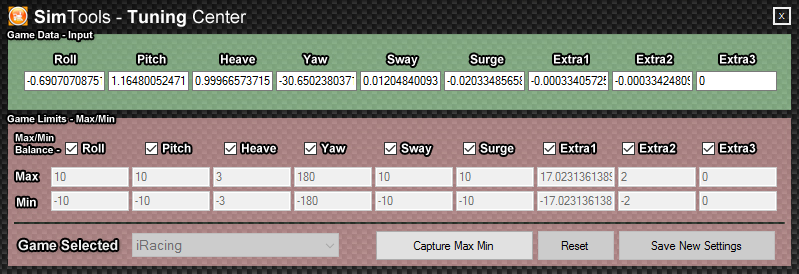

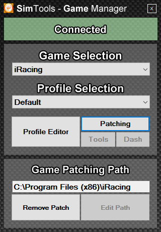

    hello everyone, I just updated my iRacing Plugin for SimTools and updated iRacing also with the latest version and now my Sim does not move! I thougth it was my Rig so I tested it with Dirt Rally and is working with Dirt Rally, I when back to the original document "how to set up Simulator" for SimTools and check on everything but still is not moving with iRacing,
    Anyone knows how to fixed?
    Thanks!

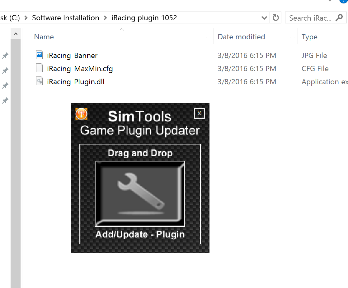

    Here is a picture of the plugin:

    You don't have to open the zip file. Just drag'n'drop the zip file into the plug in updater.
    I would be interested in a screenshot of your task manager details to see the iracing exe.

    Yes! I did drop the 3 files in to the center of the square, i got more info! I just notice something my old Axis force setting in SimTools Game Engine are not working anymore! for testing i change the force setting from 15% to 100% percent and the chair berly moves moves now. somehow the telemetry data is diferent.
    here are my settings:
