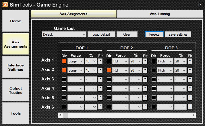

    This is my normal force setting:

    ok, i just did what you ask me i took the zip file and drop it on the plugin update square and when back to iracing and still the same, i fell the chair move at %100 force but is just a little bit not much.
    is there a way to rollback to old version?

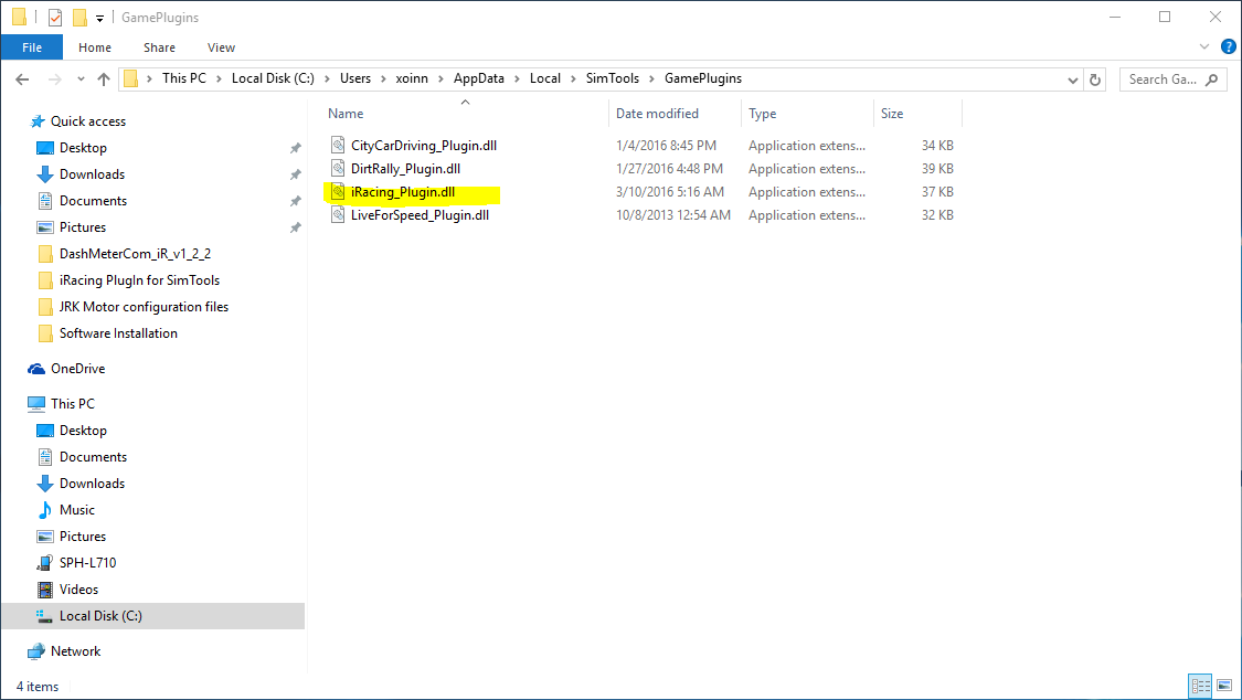

    I deleted the file call iRacing_Plugin.dll then open iRacing and when ahead to a track tested a car and still the simulation is behaving the same, I am now thinking that the issue is not in SimTools! it may be in the iRacing updates! I did a large updates from iRacing, I will call iRacing and ask them if I can Rollback or uninstalled the updates.
    Let me know if there is anything else I can try?
    here is the location of the file:
  6. Historiker

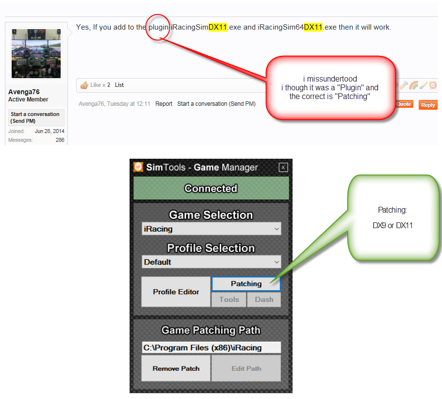

    The new update allows you to choose to run in either DX9 or DX11 (which the new update added) Try to run it in DX9 and see if motion works.
    Value1 released an updated plugin for the DX11 version of iRacing as well so you might try that also.
    Did you remember to unpatch and repatch the game in game manager as well?
    Everything I have mentioned is found further back in this thread, mention by several members.

    Question: I still do not know where in iRacing website I have the option of DX9 or DX11? what I normally do is I go to www.iracing.com and login select my car select my track and start racing, so the question is am I launching iRacing from the wrong location? should I be launcing from a shortcut?

    The patching process is in the game manager. What you are describing is the plugin installation process. After you install the new plugin you also have to unpatch and repatch the game via the game manager.

    Oh! it sock getting old, so the DX9 or DX11 should it be patch using the "Game Manager" that I did not do, I miss understood.
    look at picture:

    Somehow SimTools "Tuning Center" Min and Max parameters got replaced for a big number! i do not know how that happen but i recapture and recalibrate my sim to my liking, everything is good new!

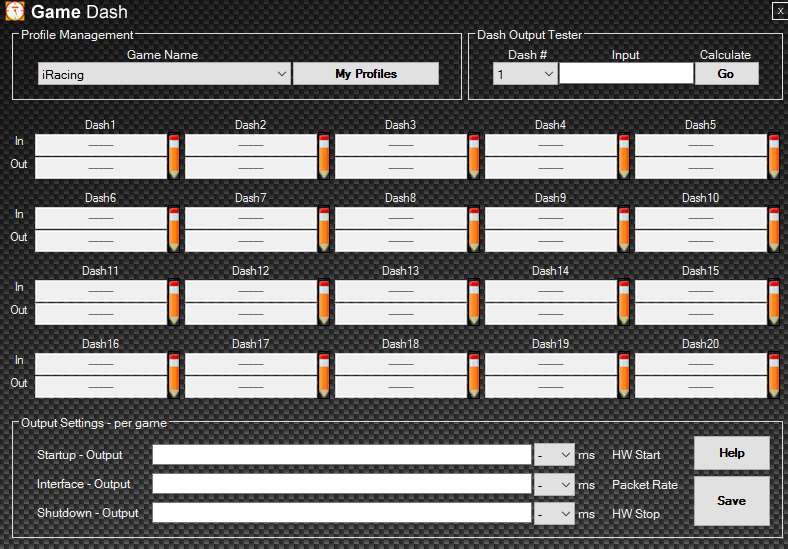

    Ho hoping you can point me in the right direction. I have downloaded the plugin, thanks to @Historiker for the donation. I have installed the plugin by dragging it to the update manager. I patched the game and I am still not getting game dash data. When I load game dash and select the plugin, the titles do not change see screenshot below.
    I built http://www.xsimulator.net/community/threads/simple-dash-on-arduino-lcd-with-gamedash.7029/ but can't get the data onto the screen. I think its at the plugin area where its breaking down but not sure.
