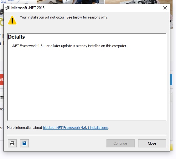

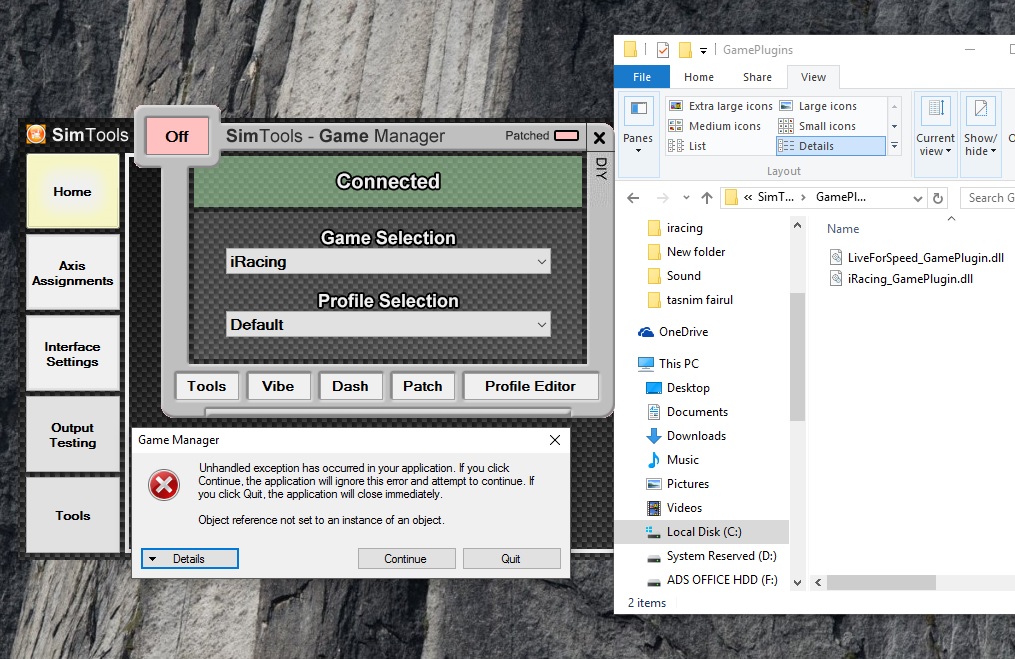

    Hello guys,
    i have problem and crash when im using this iracing plugin on simtool 2.0...i only have 2 plugin installed in my pc which is 1)Default Live for speed and 2) iracing plugin..
    everytime i turn it on im having the crash..can someone help me?
    this is the crash log :
    System.NullReferenceException: Object reference not set to an instance of an object.
    at SimTools_GameManager.Mod_Lib.Stop_MemMap_Output()
    at SimTools_GameManager.Mod_Lib.GameStoped()
    at SimTools_GameManager.frmMain.tmr_IsGameRunning_Tick(Object sender, EventArgs e)
    at System.Windows.Forms.Timer.OnTick(EventArgs e)
    at System.Windows.Forms.Timer.TimerNativeWindow.WndProc(Message& m)

    Have you updated .net framework?

    4.6.1 is the current version and can be d-loaded here

    there's an latest update 4.6.2..and i already installed it just now...same crash happen..what did i do wrong now..
    this is the current crash log after install the 4.6.2:
