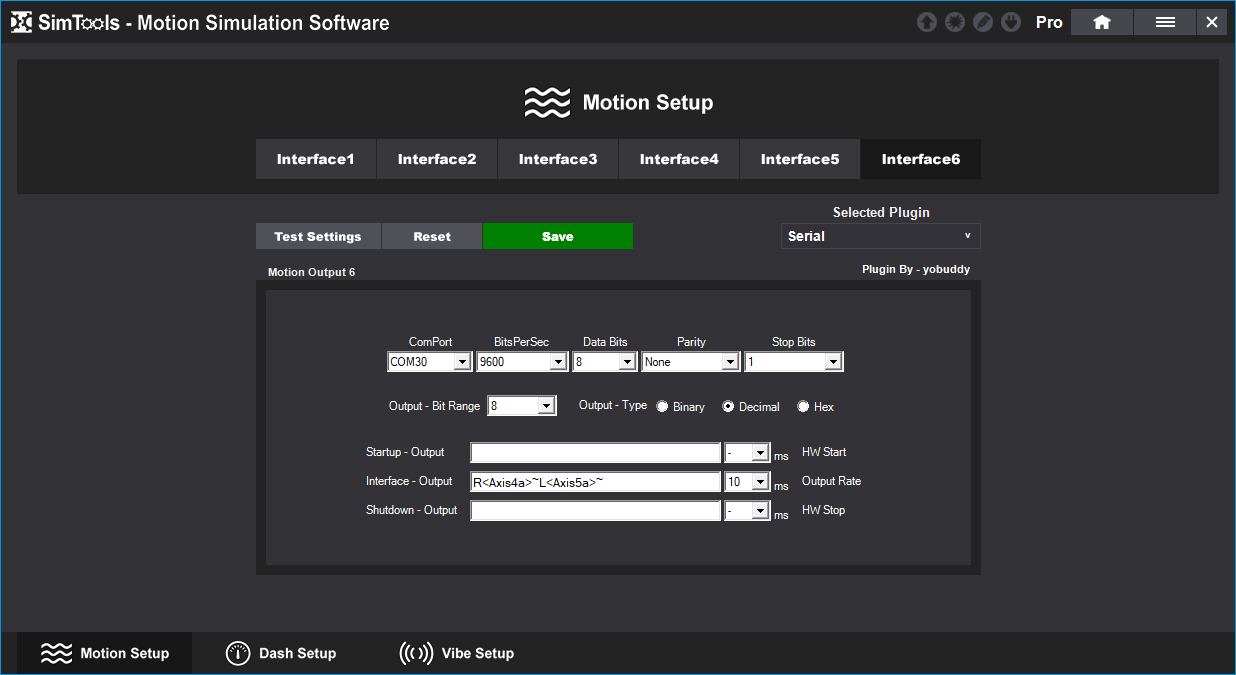

    @yobuddy sorry to drag you into this bud, but it's a bit of R&d I'm doing and we could do with your expertise!
    As stated, serial monitor works, but in interface testing using the settings in the post above, we get either none, or erratic behaviour from the stepper motor (which stops when testing is stopped).
    I'm not going back to V2.....
    Any ideas would be hugely appreciated!

    Thanks for your input.
    I'm using a clone Arduino Uno, which I've been using with Simtools V3 for multiple projects, always works perfectly. As you can see I've requested the help of the guru

    The code and the settings work perfectly fine for me...
    If what I told you above doesn't work, there's nothing more I can do for you. Maybe @yobuddy can solve your problem...

    This sorted the issue for me - thanks

    It's almost like the motors can not keep up with the positional data being sent to them. I am finding that if the scale is turned down to 1600 they work without issue. For my testing requirements this is ok, so a 2 motor version of the sketch would be fantastic. Thanks in advance

    To be clear, it wasn't changing micro stepping settings it was this
    Code:
    const int kActuatorScale[kActuatorCount][2] = { { -1600, 1600 }, { 1600, -1600 } };

    3DOF, Arduino
    Problem fixed!
    I'm so delighted that my actuators work!!!
    1. I added delay : no random movements anymore. Totally fixed! I'll share you the code.
    2. I tested Lebois' code, and with some modifications, it worked! The adventage of his code is that the motors are not noisy, because unlike the StepperDriver libray, it doesn't stop at each step. As we receive datas every 1-50 ms, the controller which is the library, moves stepper and stop it. Lebois' code doesn't work like that, it doesn't stop at each step. We could still modify the library in the "%USERPROFILE%/Documents/Arduino/libraries/" folder and remove the stop function but it is more complicated...
    Which one do you prefer?
    Best regards,
    Tintin Boulsard
