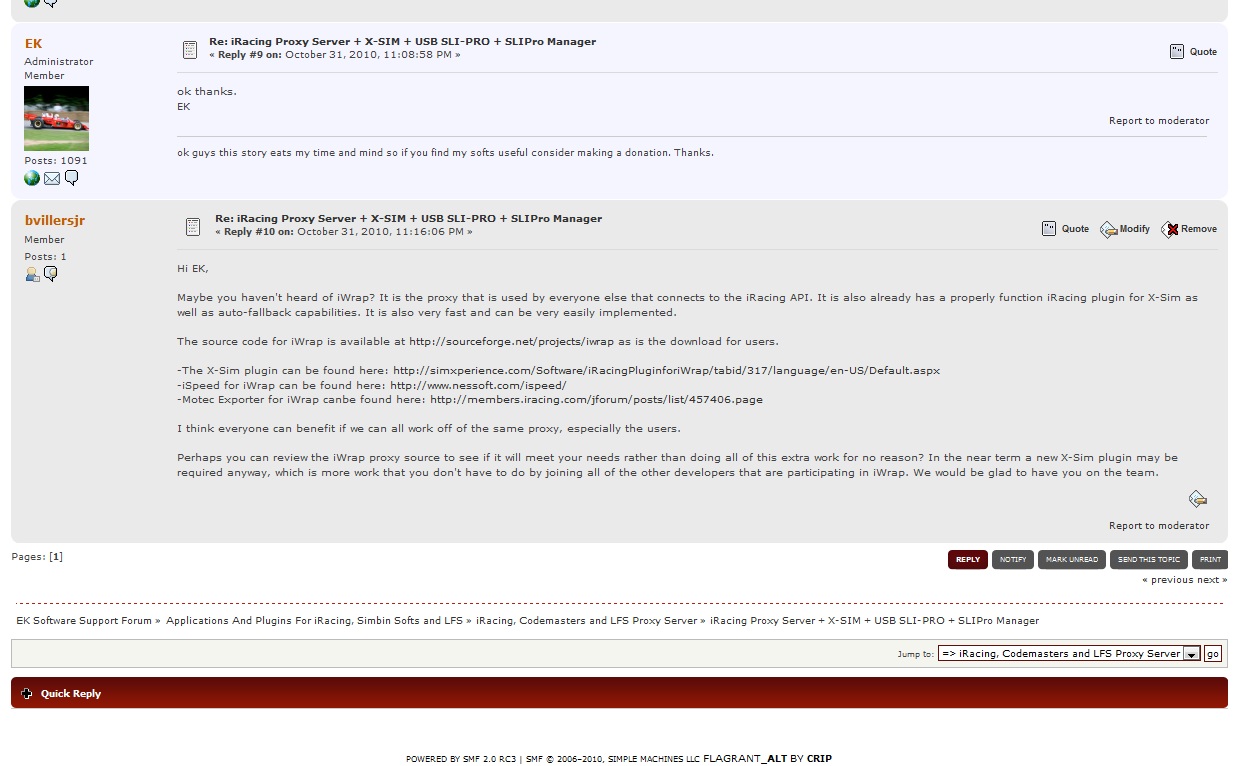

    EK has deleted all posts about iWrap and continues to refuse to join the rest of us. It is now against his forum rules to discuss iWrap there!
    The original claim was that he didn't have time so we built support for his proxy into iWrap. The new claim is that I offfended him. I have offered him a sincere apology because it was never my intent to offend anyone! Hopefully he will reconsider.
    I don't have the previous version SLI software. I cannot use an SLI for obvious reasons.
    Here is the post that he deleted:

    I think his signature gives away the highest level of professionalism....
    The software is eating his time away, yet he refuses to accept help from other developers who try to make it easy for him... and gets offended?
    I mean, WTF?
    He is probably pissed because Leo doesn't cut him enough and donations are not enough to make it worth it. He then decides to make it hard for everyone, begging for support so they all donate? I cannot come up with any better explanation to this.
