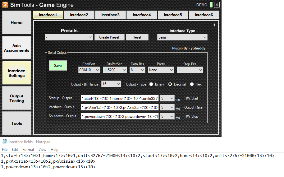

    Seeing your serial command, it wont work for the current version of the FlyPT interface.
    I have a new one that I will upload today, that allows sending commands of the type <#>.
    So before trying, wait for the new version (1.6.3). I need some feedback for that, specially because you are using decimal output and I have doubts it's working well.
    Great build!
    Hope you have no problems with bending ballscrews.

    Your update 1.6.3 fixed it for me. Cheers!

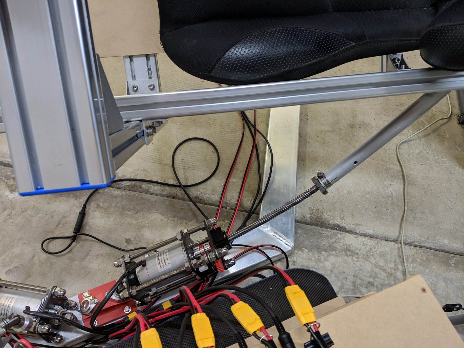

    I did stop for a while. Not enough Sundays. But have got back to it the last few weeks
    I got it together again with a replacement ballscrew.

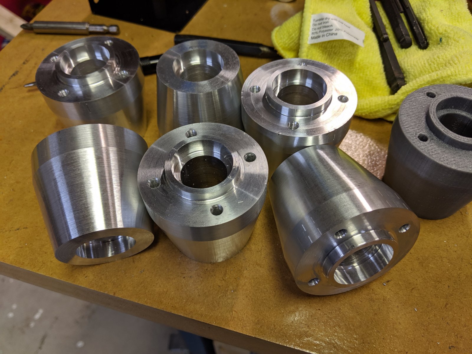

    Gave it another run all OK but I decided the bearing mount at the motor end of the ball screw was not suitable. With the two bearings stacked up against each other inside the bearing block, there is too much wobble and the screw can start to whip around uncomfortably at certain resonant speeds.
    I tried keeping the block and replacing the bearings with some quality name brand deep groove bearings but there was little difference.
    Next I tried angular contact bearings loaded up against each other but also not much improvement.
    So I have started making some custom bearing blocks (Aluminium) which separate the bearings around 50mm.
    This is only my second job ever on the lathe and it has taken me much longer than I care to admit.
    I had these finished yesterday.
    This coming weekend I'll be starting on machining the ballscrew to fit the new bearing block.
    Hopefully I can update again soon with a few completed actuators.

    Those bearing do look really nice. I hope you get much improvement.

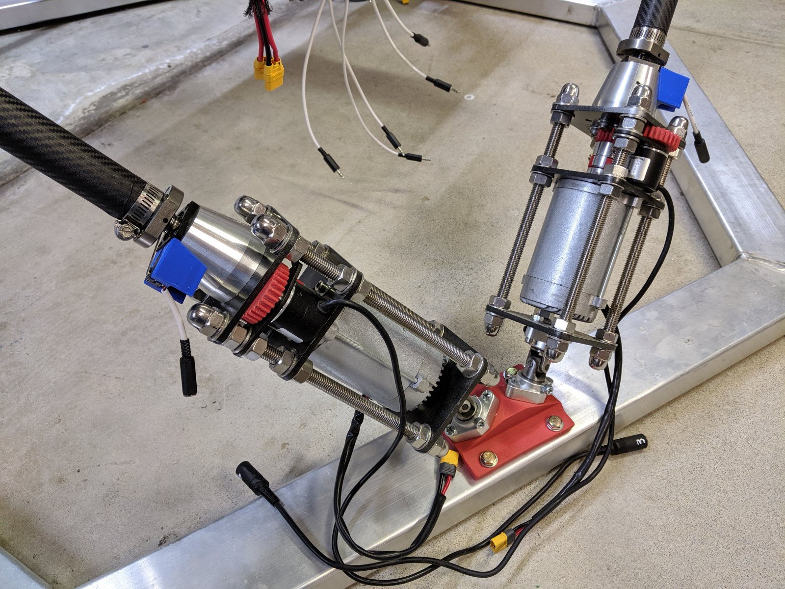

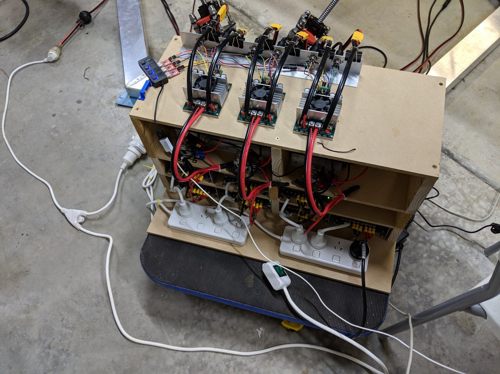

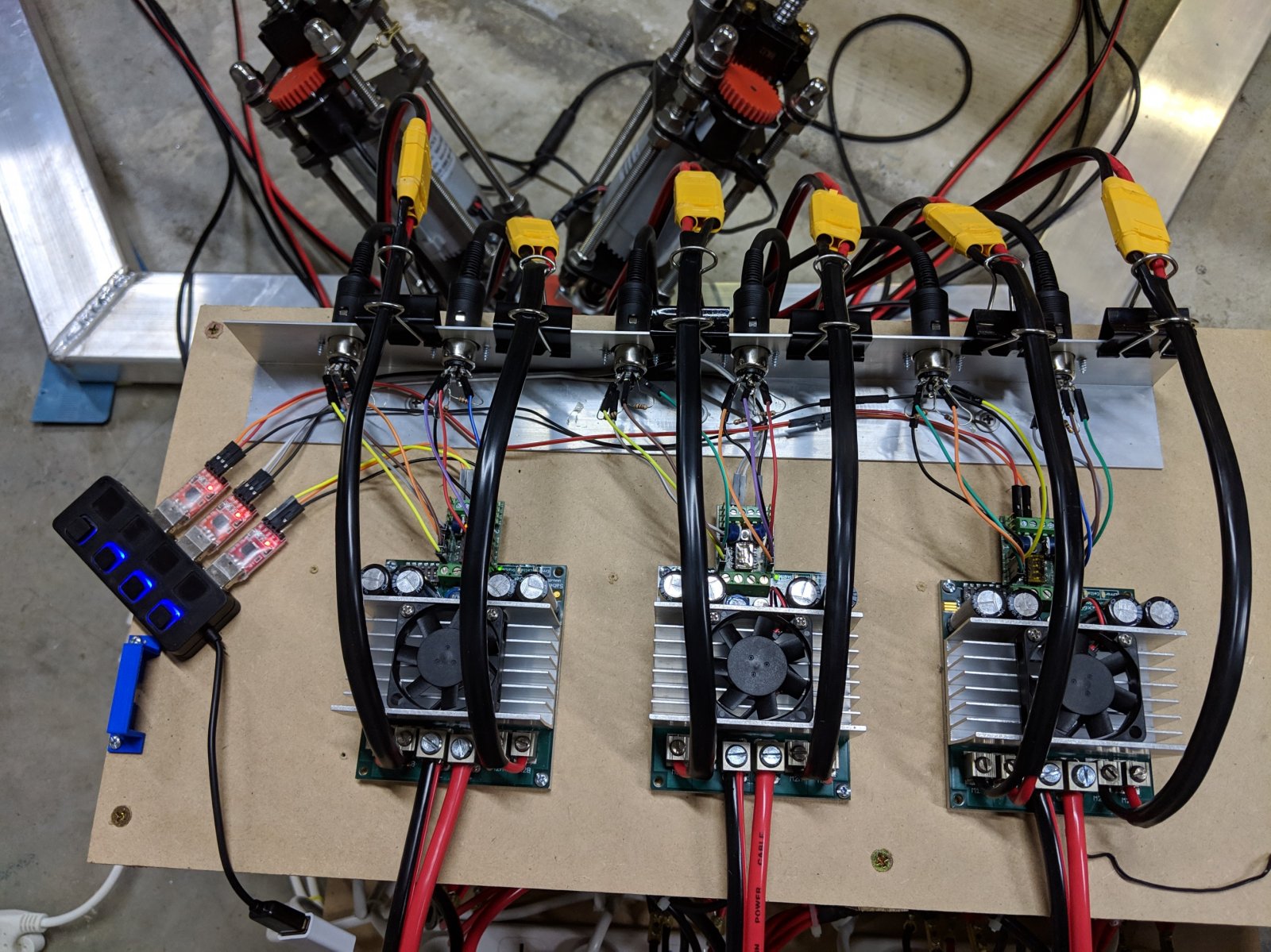

    Finally have something to show and can now report all the actuators have been upgraded with the new bearing blocks.
    I also added a bottom limit switch for homing when starting up the sabertooth/kangaroo.
    It was getting a little uncomfortable watching the start up routine perform the homing and calibration by crashing into the stops.
    I can cope with it crashing into the bottom limit, but I was clenching every time it would run the ball nut to the top limit inside the tube.
    And no, that's not an upgrade to carbon fibre tube, its just a vinyl wrap.

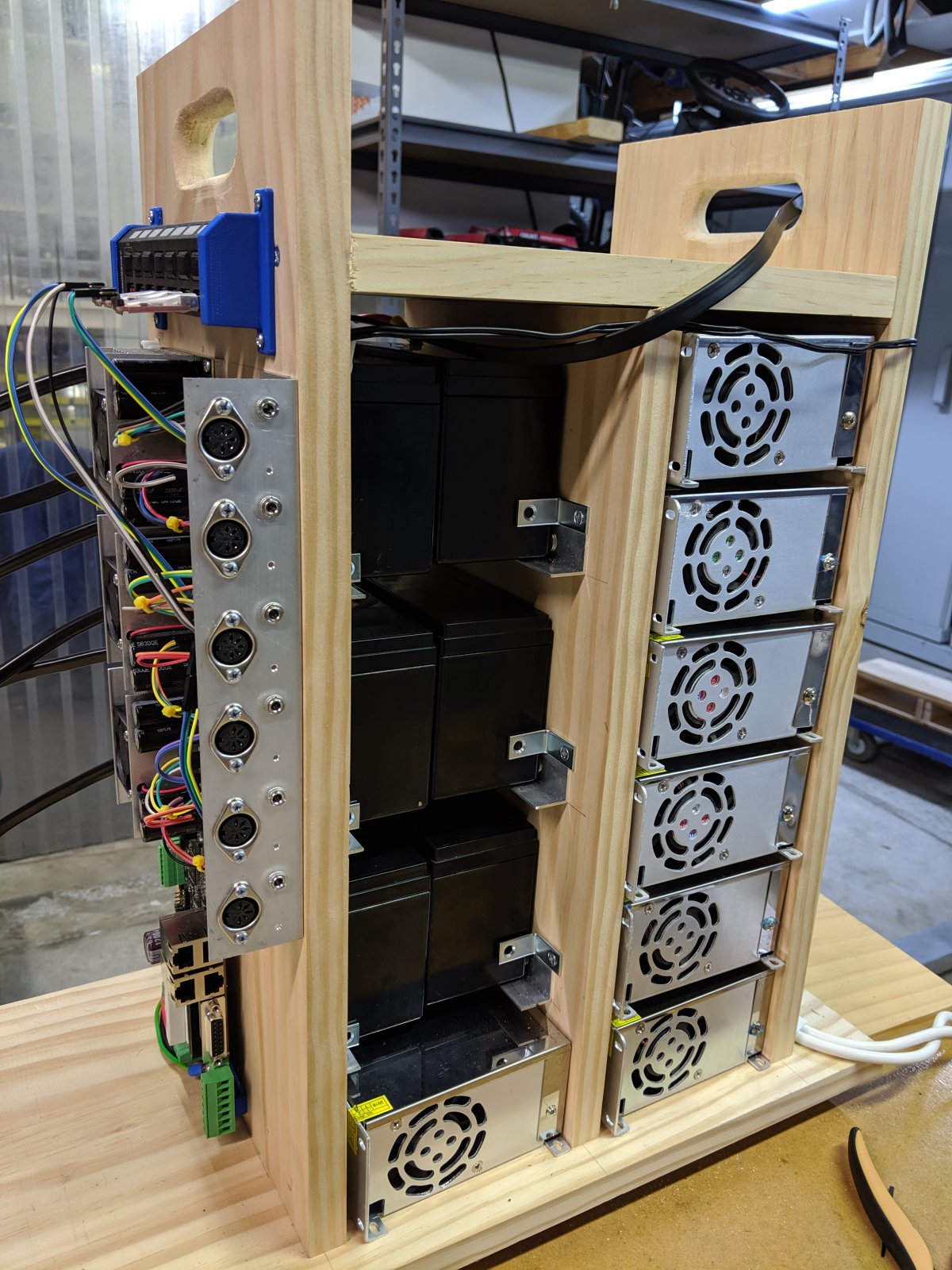

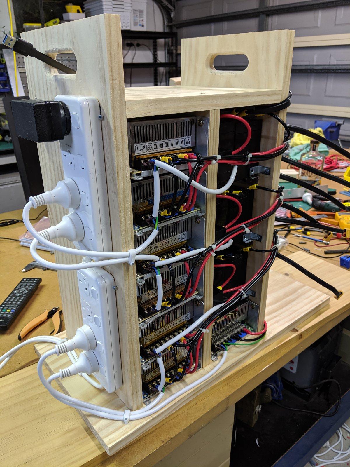

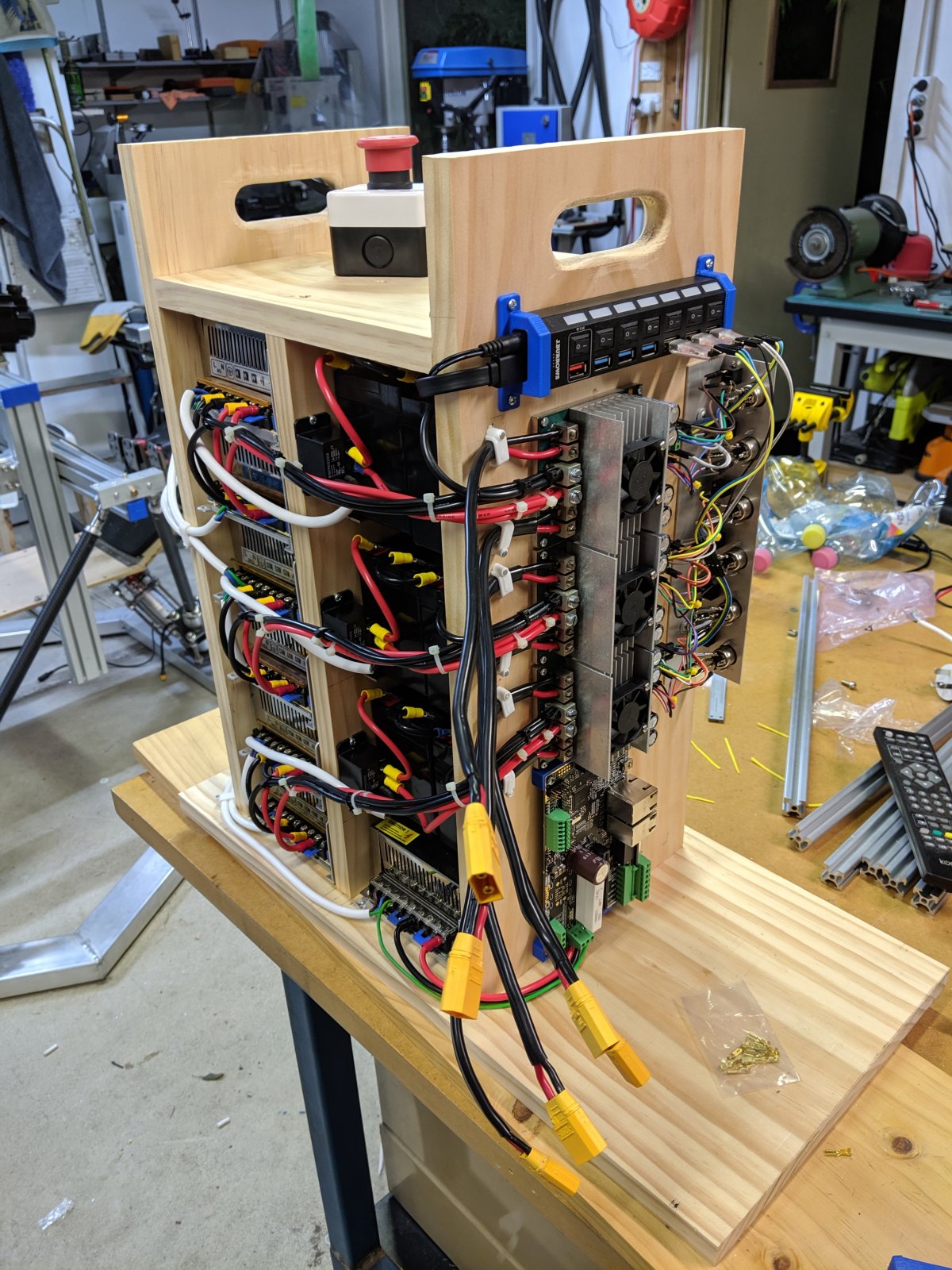

    I also took the time to redo the whole assembly of electrics.
    Its now easier to pick up the whole thing and put it on the bench to work on.
    I have a few small things to finish up before connecting it all.
    Hopefully next update will be the thing moving again.
