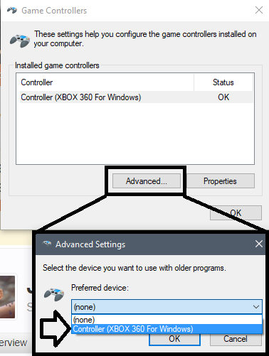

  19. jungletech
    jungletech New Member
    Jul 1, 2017
    California
    158Coins
    +8 / 0 / -0
    In case anyone else has a problem with getting the plugin to detect joystick movement when multiple devices are plugged in, I had to go to my game controller setting in the Windows control panel and select the preferred device. The plugin was detecting movement from my xbox 360 controller, but not my HOTAS. Changing that setting fixed the issue for me:
    Thanks for this plugin, it's been awesome!
