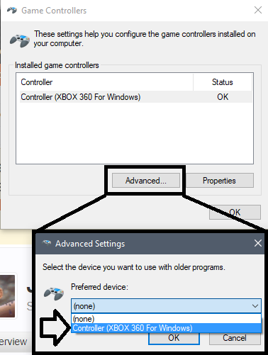

  5. SeatTime
    2,572
    +2,854 / 40 / -0
    Thank's @jungletech :thumbs. I have a Hotas/Pedals and other systems plugged in, so this also worked for me. Allowed me to select my Warthog Joystick for Elite - then it came up as the first selection - could not select/find it before that.
