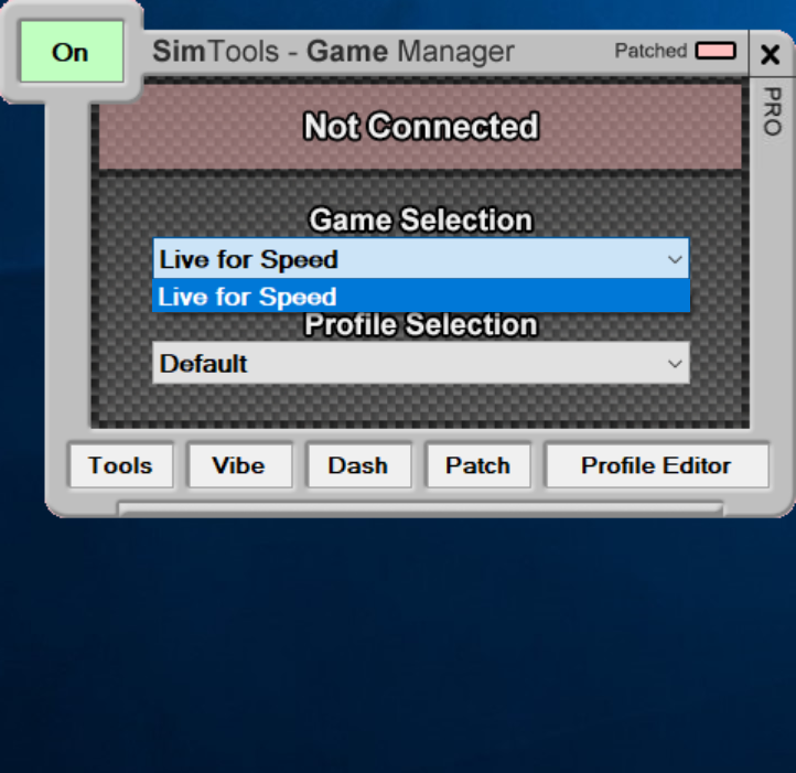

    I can only select "Live for Speed". What do I have to do to let the Game Manager know the

    Have you installed the plugin using the PluginUpdater?
  14. fuzzel4711
    fuzzel4711 New Member Gold Contributor
    Feb 17, 2019
    76Coins
    2DOF, 3DOF, DC motor, AC motor, Arduino, 4DOF, 6DOF
    Nope, this was missing from the instructions :thumbs
    Now it works.
    BTW the instructions say "Run GameEngine & GameEngine" I think it should be "Run GameEngine & GameManager" ;)
