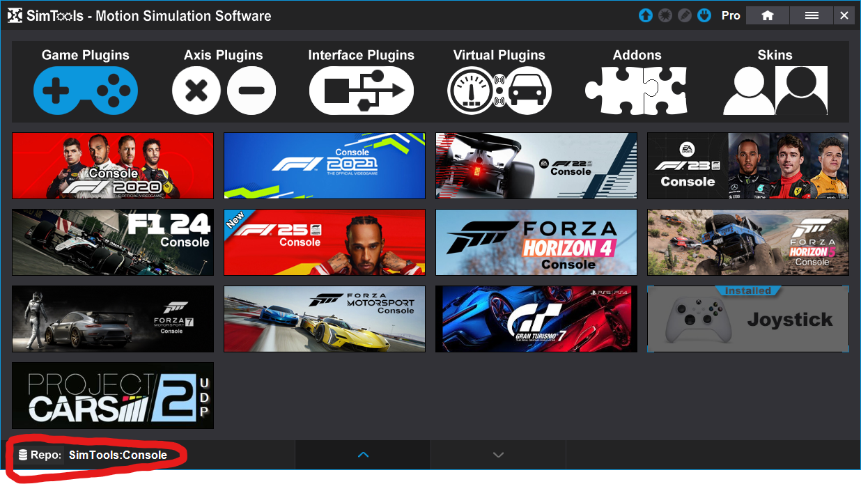

  10. Pastiijay
    Pastiijay New Member Gold Contributor
    May 19, 2022
    - 375Coins
    Yes, you need to go to Plugin Manager>Repo:>Community Repositories SimTools>Console>Joystick

  13. victor mario gomez
    victor mario gomez apprentice
    Nov 25, 2025
    military
    Colombia
    33Coins
    I'm new to this forum. I recently purchased a professional license for SimTools and I'd like to know how I can acquire this plugin to use with Ace Combat 7. I'm starting to learn how to use SimTools to build my own simulator and I'd like to be able to configure Ace Combat.
  14. victor mario gomez
    Nov 25, 2025
    military
    Colombia
    33Coins
    excuse me can you helpeme? i´d like to get the value1 plugin that deals whit getting telemrtry data form a joystick, I´m new to the forum and I don´t want to make a mistake and get kicked out.
  15. noorbeast
    22,225
    154,819Coins
    +11,226 / 57 / -2
    You do not need to use this older plugin, as you can install SimTools v3, which is both current and easier if you are just starting out, and access the new joystick plugin via the new SimTools v3 plugin repository system as @Pastiijay kindly explained:
