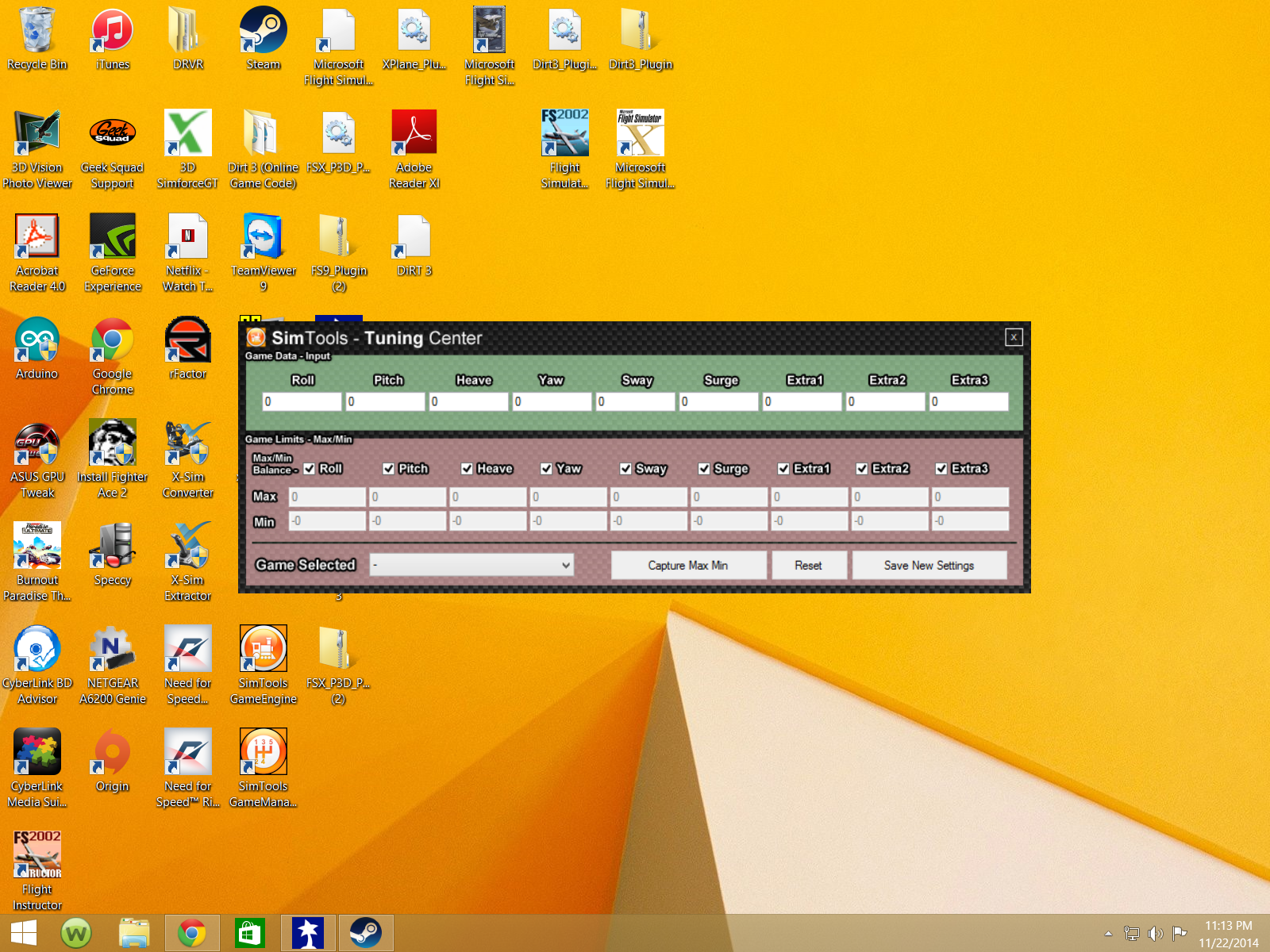

    here is my tuning center. I try the game, still moves very slowly. I'm not sure if I made any changes longtime ago that it might caused this issue.

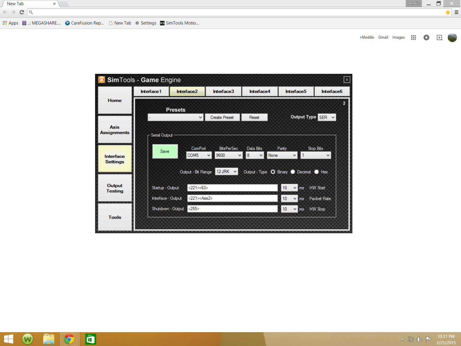

    Thank you, I did all that and still there is a long delay to respond. I'm not sure if there is bug in the Sim program. It was fine for the first 4 to 6 month. I didn't change anything before our conversation and all of the sudden the actuators not returning to neutral position. Can you help? Thank you
  4. bsft
    can you take and post a screen shot of the interface settings from game engine please

    i this what ypu asked. Please let me know if you need any other information. Thank you,

    I hope these screen shots help. Please let me know if you need any other information. Thank you,
