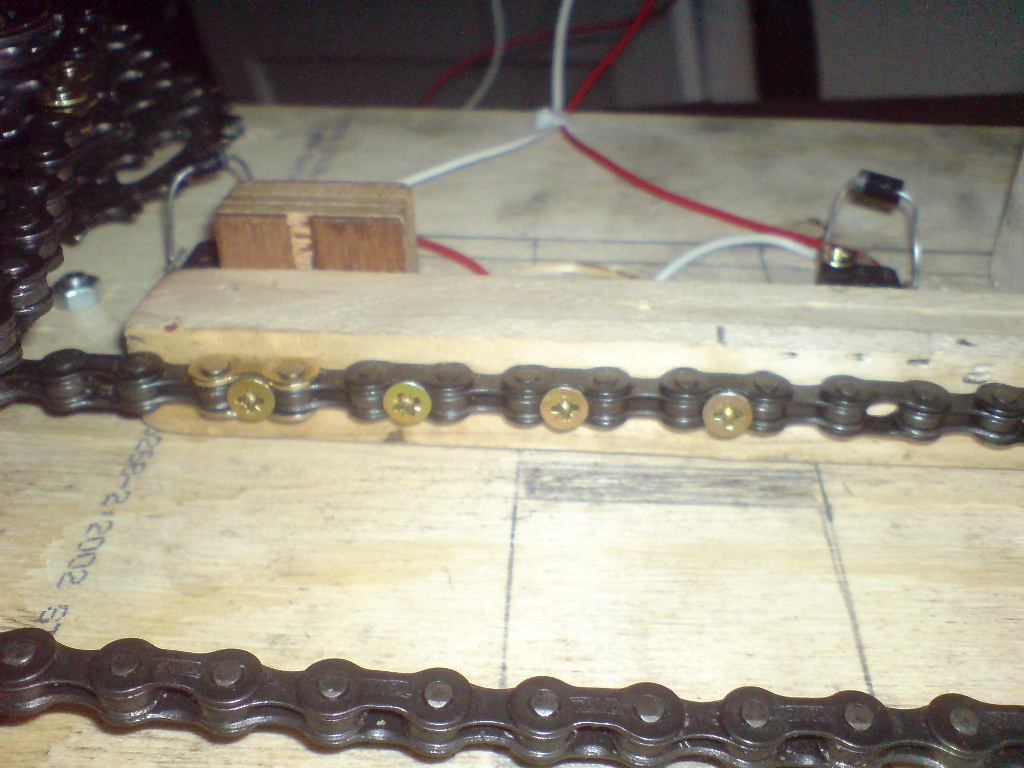

    Tim,
    Have you thoght how you plan to attach an actuator arm using the chain?

    Hi Shannonb1
    Yes I have - and you have already seen it being sucessfully tested in prototype! 8)
    The method I will use is simplicity itself - which is really important for my build as I'm trying to keep it possible for complete beginners!!
    I simply have a wooden arm, and use screws between the links in the chains:
    This method can definitely take the forces involved - the picture above shows the prototype that I used in the rocking couch stress test which went way beyond any stresses that will be experienced in a ballanced platform!
    (here it is again for anyone joining the thread at this point):
    http://www.youtube.com/watch?v=grfrH1DTS20
    It is also extremely easy to disassemble for maintenance such as replacing or tensioning the chain.
    Tim

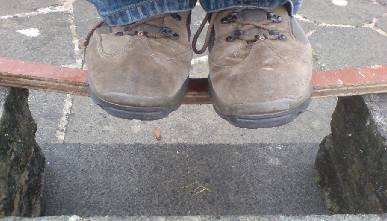

    Hey Tim, i know the motor can handle, chain can but my concern was for the wooden arm, I would us a rod welded or some steel with bolts through the chain....am i thinking about that right? your design, just something I thought about knowing how wood can break
  9. bigtalltim
    bigtalltim New Member
    Sep 10, 2010
    189
    Belfast
    361Coins
    I'm not worried - yes wood can break, but plywood is stronger. This is because the thin layers of wood (or plys) are arranged so that the direction of the grain alternates with each layer. This means that there are far fewer weakness between the fibres of the wood that can be exposed.
    I am 6'11'' (about 210cm) and about 17stone (114Kg)... I can stand on the middle of a 25mmx18mm square strip of plywood held up on two blocks with no problems... it could bend, but it wont break! :lol:
    The bending wont happen in the build anyway as most of the load is compression along the grain, and this is where wood is at its strongest (think of the force acting on the trunk of a tall tree).
    If you want to use metal - and that is a fine idea and probably better (but more expensive and less convenient),
    I would go with bolts through the arm rather than trying to weld chain onto a bar...
    Welding could weaken the chain and would never be a satisfactory join... and difficult to maintain
    The forces involved in lifting that sofa are way more than you would experience in a build with a ballanced platform - and half of the actuator housing was missing so that you could see what was going on! - I wouldn't worry about it ;)
