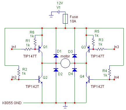

    I just had a thought... it's quite a good thought! 8)
    Maybe we can get a single K8055 to drive 3 motors after all!
    I will explain my thinking:
    Using the relay solution we are unable to achieve the control of more than 2 motors.
    This is because each motor requires a PWM output, and there is only 2.
    Likewise, each axis requires a pot for feedback and there is only two analogue inputs.
    This leaves 6 digital outputs unused... and it is these that I have been thinking about.
    The original profiles for the K8055 featured pulsing routines - each H-bridge requiring 4 outputs.
    Before starting with the relay circuit, I tested the circuit below, and it did work - it can even be tweaked to use PWM, but it uses both channels on one motor... this is one of the main reasons I invested so much time in the relay setup, as it allows PWM control of two motors from one K8055!
    I am still considering a way in which the extra motor could be usefully used without feedback controls, but technically, the following setup should work:
    Wiper motor 1, PWM1, D/O 1, Analogue in 1
    Wiper motor 2, PWM2, D/O 2, Analogue in 2
    Wiper motor 3, D/O 3,4,5,6 - H-Bridge setup with pulsing routine
    I'm gonna throw this one open to everyone out there: Any ideas about how the extra motor could be used?
    I was thinking either as a kicker to simulate traction loss on the back of a 2dof frame setup (though that would really need feedback)
    OR (and this is my current preference)
    not to use a wiper motor at all, but instead a powerful 12V motor with an offset weight to create maximum quantities of vibration through the frame to improve the off road experience in GRID and so on!
    The circuit to use the extra digital outputs is as follows:
    Just using a fast motor for vibration, fans etc, you wouldn't need such a complicated H-Bridge - in fact, a single pull down resistor and transistor would do the job, and allow the connection of up to another 6 similar motors!!...
    BUT if somehow multi directional control could be useful, the H-bridge makes it possible... and still leaves you two outputs for vibration motors! :thbup:
    Tim

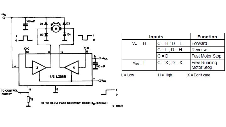

    So... if I read this correctly we could use the spare 6 digital outputs from the K8055 to drive another 2 low current bi-directional motors (using 3 outputs each) in addition to the 2 high power ones that the relays handle? - keep me right here... that seems almost too good to be true!!
    Cheers once again Frakk - I will order some of these and have a play! :cheers:
    Tim
  16. Frakk
    Frakk Active Member
    Apr 15, 2009
    1,144
    328Coins
    That is correct, as long as the digital output can generate PWM for speed control.

    Hi Frakk
    Now I'm really confused...
    The diagram and writeup make reference to High and Low - I had taken that to mean on or off... is that interpretation wrong?
    The available outputs definitely do not support PWM - the k8055 only has 2 outputs that do that and the relays will use them up...
    Based on my assumption that High means on and Low means off, my understanding from the writeup and in the diagram was that if we have 3 outputs 1,2 and 3, they would be used as follows:
    1 controls the motor on or off.
    2 and 3 govern the direction or the stop
    If 1 is on:
    2 on and 3 off means forwards
    2 off and 3 on means backwards
    2 on and 3 on OR 2 off and 3 off means fast stop
    If 1 is off, any combination of 2 and 3 means free running stop
    The writeup seems to suggest that if we rig up the digital outputs with 1k resistors as with the relay solution, that the straight digital on or off will do the job... (figure 6 with application writeup on 7/13)
    Am I on completely the wrong track here?
    Tim

    You seem to know what you're talking about.
    If you only want ON/OFF control of the motor, you don't need PWM. In that case you can hard wire it to enable, then control Direction/Brake with 2 and 3. 6 outputs can control 3 bridges.
    Now I'm trying to think of an application for this. :)
