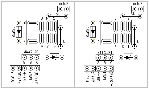

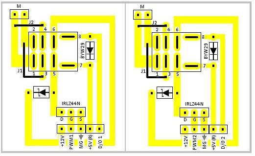

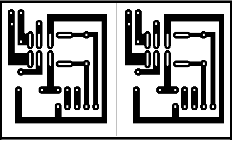

    I've taken some time and, using windows paint, transferred the mosfet relay circuit design to a pcb board layout.
    I think I got everything correct, but if someone has time, perhaps they can confirm it for me.
    The one I don't know is what type of Schottky diode I should use.

    Here is the board back (This is confirmed to be to scale):
    Here is the board front (silkscreen) (This is also confirmed to be to scale):
    I plan on etching them soon... :)

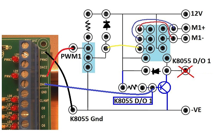

    I think this is how I would connect to the K8055 to the relay circuit.
    Is this correct?
    Second question:
    In the upper right of the board you have a 12V. On the bottom right, you have a -VE.
    I know the 12V would connect to an external 12 V power supply.
    What does the -VE connect to?
    Thanks.
    Kevin

    Hi Kevin
    Q1. In a word, no...
    K8055 D/O1 is Digital Out 1... At the bottom of the right hand edge of the board, not shown in your diagram and labelled 01 (though you can see D/O8, D/O7 and D/O6 on your diagram (labelled as 08, 07 and 06 under clamp)
    Also, I use the Gnd directly above clamp though this is less important.
    That would be the negative terminal of the 12V battery - or in my case, the black wire in the molex connector... the yellow wire is the +12V
    Hope that helps - anything else, just drop another post! :thbup:
    Tim

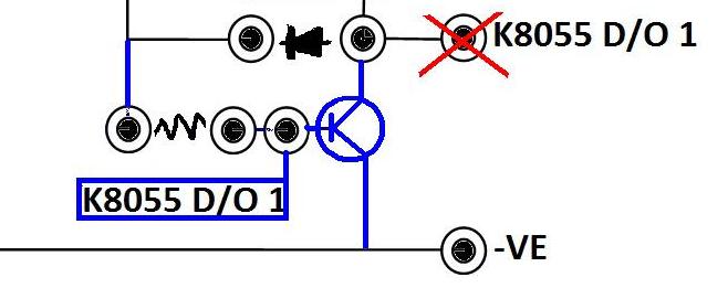

    Thanks for the clarification.
    I have one (actually two) more questions.
    1. What type of transistor could be used here?
    2. What ohm value of resistor should be used?
    Sorry for all the questions, but once I have this info, I'll upload another pcb image for this layout :D

    Hi Kevin
    check out Page 12 post 9 of this thread where both are specified :thbup:
    The diagram you are looking at is my illustration of how the circuit layout differs... its intended use is for 24V, or relays that draw more current through the coil than the K8055 inputs can take... you may find that the leg layout for a suitable 24V DPDT relay is different - I have not used this circuit myself as I am sticking to 12V for PCU power unit convenience!
    All resistors are 1K, and the transistor is a PNP 2N3906
    If you are going to design a PCB for this circuit, you will need to specify also a suitable relay for the 24V, download its data sheet, potentially redesign the leg layout and after all that, if the coil current is within tollerance, you may find that the extra transistor is not needed!
    (the K8055 contacts are rated for a maximum of 50V @ 100mA...)
    Breadboard for prototyping first is probably the way to go ;)

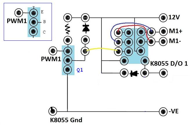

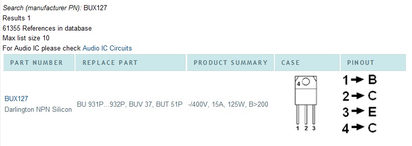

    I have a couple questions:
    1. In the image below, I am inferring that the Collector, Base and Emitter are as I show with C, B and E.
    Is this correct?

  19. bigtalltim
    bigtalltim New Member
    Sep 10, 2010
    189
    Belfast
    361Coins
    Hi Kevin
    The leg layout you showed in your diagram was wrong...
    the most important detail is that the K8055 PWM connection (and resistor) connect to the base of the transistor.
    Check out the description on Page14 post 9, where I explained how the solution works - that will help you to understand how the K8055 contact controls the base of the transistor to switch the power on and off
    Off the top of my head, the leg layout of the circuit from top to bottom (using a BUX127 ) should be B, C, E... your diagram (shown below) shows E,B,C... it should be easy enough to find the data sheet on google to confirm this
    Tim
