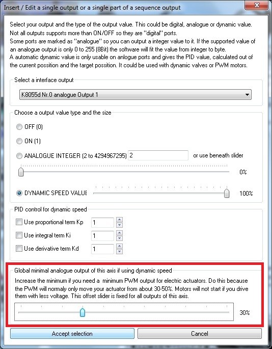

    My motors don't start spinning until slider position is more that 50% (more toward zero that is) in the K8055_demo software.

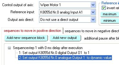

    To control how much power is needed to drive the motor, I've found an option in the Output setup section:
    Right-click on the Set Analog Output dynamic value and select Edit.
    In that dialog, move the bottom slider to the right:
    That seemed to work for me at least.

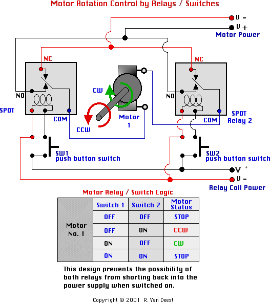

    As a control unit for a sim?... no - at least, not satisfactarily...
    as a motor controller?... - well... R.van.Deest thought so enough to copyright it!!
    Your problem is going to be lack of control - because you do not have variable speed, the motors will constantly hit maximum and minimum position, leading to a very unrealistic motion.

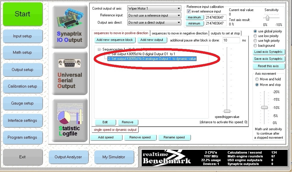

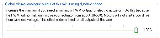

    If you are using PWM, it could be that you need to change the settings in the dynamic out section - your motor may not turn until it reaches a certain value... this setting change will compensate for that slow start.
    to change the Global Minimum Analogue Output settings do the following:
    (this fixes all outputs within the axis in one operation)
    Double click on the Analogue output (highlighted in red oval) in your output setup section:
    Change the settings (highlighted in red box) and click accept:
    Experiment with that...
    As you already have variable speed working, I think that may be all it takes to crack your problem :thbup:
    Tim

    Change these values for 25 (lateral force) and 27 (longtitudinal force) and you may be getting somewhere, as these values change significantly when you play the game.
    To see the difference in effect assignments between the plugins, try the following:
    click into force sender and select the test developer plugin.
    Then switch back to force profiler and click on the input setup button.
    Note the values of 21 and 22 (no description)
    Now switch back to force sender, and choose the life4speed plugin
    When you switch back to force profiler, you will see the values have changed.
    Do the same for what ever game you are playing, and note the effect numbers you need to use.
    You then need to change the value in the maths setup area to use your new selected values:
    To change a value, go to the maths setup screen.
    double click on the value number (or anywhere else in the line that contains it in the calculation table)
    Chose your alternative value from the drop down list, and click insert in maths list and continue
