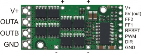

    Why you need a Relay when using a motor driver?
    My hardware is 2 motors with 24V and 10A .
    Please can anybody post me a circuit with exact names of the parts i need?
    which Diode and which Relais are working?
    thx alot
  3. Frakk
    Frakk Active Member
    Apr 15, 2009
    1,144
    328Coins
    Why do you want a relay based motor driver if you have that MOSFET h-bridge already?

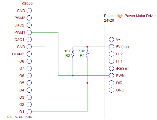

  5. Menix
    Menix Member Gold Contributor
    Mar 8, 2010
    78
    117Coins
    Ok
    i got an answer in the Vellemann Forum.
    Here is how to connect the K8055 with motordrivers.

    Hi Menix
    Thanks for this connection diagram - very useful for anyone looking at K8055 options! :cheers:
    To answer your original question, the relay in my setup simply changes the motor direction - like the DIR input on your board.
    I did look at these little boards - the reason I chose to go with the double relay based speed controller was simply the cost.
    The Pololu boards work out at about 4 times the price, and of course you need 2 of them...
    Something that might be useful for you if you decide to try this, is that the profiler configuration I use should work for you as well.
    The digital channel in both solutions is used to set the motor direction, and the analogue channel is used for PWM data.
    You can download it from the first post in this thread :thbup:

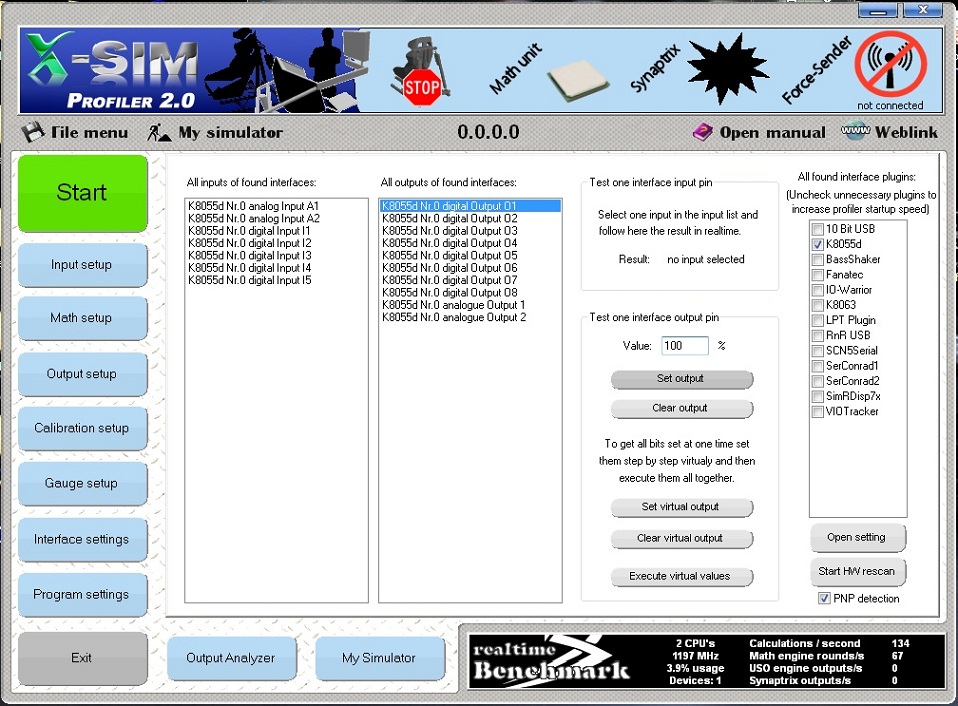

    All this dont work for me.
    theres no Tutorial for X-sim with a K8055 Board
    My K8055 dont work under x-sim.
    i want only to control 2 wiper Motors with a Joystick and the K8055
    im so frustrated.
    nearly 1/2 year of trying.
    is there no other Software like X-sim??
    Or can anybody help me?
    My System
    Win7 Ultimate 64 :
    Vellemann K8055
    2x H-bridge
    Connected like the circuit 2 Posts above.
    when trying in x-sim, nothing happens with the vellamnn.
    which x-sim version should i use?
    How can i test if the K8055 works in x-sim?
  8. Nima
    Nima Member Gold Contributor
    Nov 8, 2006
    413
    Glaser
    Bad Zwischenahn
    532Coins
    hi,
    you can see in the interface settings in the profiler if the 8055 are find with x-sim.

    Hi Menix - I would like to help, but I speak very little German... from web translation I am able to understand some but not all of your posts.
    I have never used the controller boards you suggest, but you should at least be able to see the K8055 working, as the lights for the digital outputs will flash on and off.
    I suggest you forget about the outputs controlled by the Velleman board for now, and get the K8055 working first.
    I guess your problems are similar to ones I had in the early stages - the most likely problem is the version of windows you use.
    I think the error message you report is the one you get if the interface board referenced in the profile is disconnected/not available - I think that this is your biggest problem... Win7-64 just doesn't appear to like the K8055 for plug and play! You may need to download a new driver or reinstall the one you have... I am using win7-32bit myself and it works ok as plug and play.
    The velleman provided test interface definitley does not work with Win7 for me - however you CAN test the board through the interface tab in profiler (explained below).
    My profile is built in Force Profiler-2.
    One other very important thing you should know, is that the outputs on the K8055 do not provide any power - they are pull down inputs... If the 5V output on your pololu card is not powered, the setup provided on the velleman forum cannot not work.
    I had a lot of frustration myself in the early days!!
    Let me know if you can see the velleman K8055 in your interface tab in Profiler - if you can, check the box next to it...
    If you cant, there is your problem!
    To test an output, select the output you wish to test, type in a % value, and click on set output.
    In the picture below, clicking Set Output would set Digital output 1 to 100%, and the corresponding LED will light up. Clearing the output will make the LED go out again, so you can see easily enough if the board is working.
    Profiler allows you to test all of the outputs and inputs in this way - this is covered in good detail in the X-sim manual.
    The test tablet is one of the developer plug ins in force sender.
    This is where I got the sine waves output going that I show in most of the videos in this thread.
    The starting point is to find the K8055 in your Profiler interface tab.
    Let me know when you have that sorted, and I will post a video showing how to do the rest.
    The interface tab should look like this:
    Tim

    my Vellemann works, but i think i destroeyd my pololu drivers. There is no more output at the 5V Pin.
    it works for about few minutes. But 1 of the h-bridge dont work. So i checked out on the working one were is power and were not.
    And so i think i made a shortcut and the working one is now also dead.
    That means i need two new mosfets.
