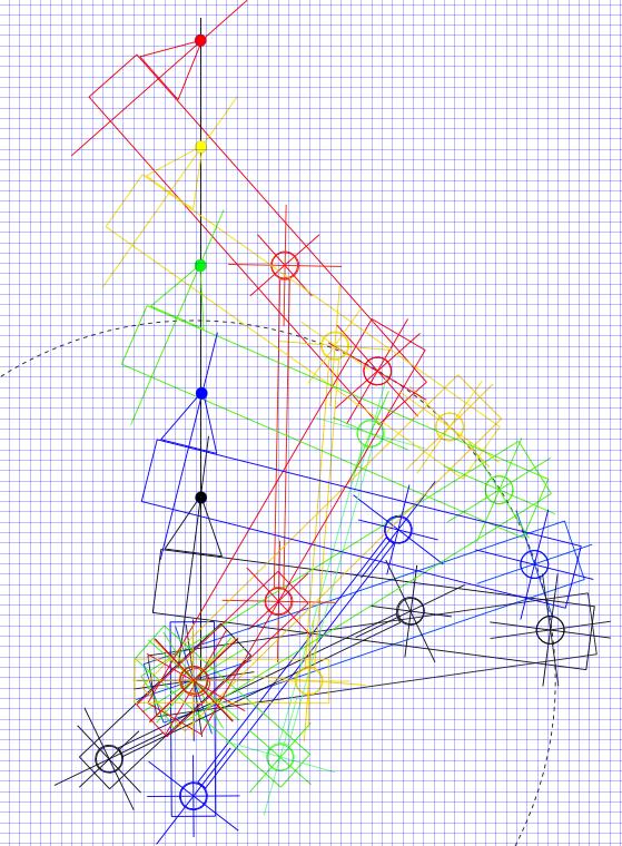

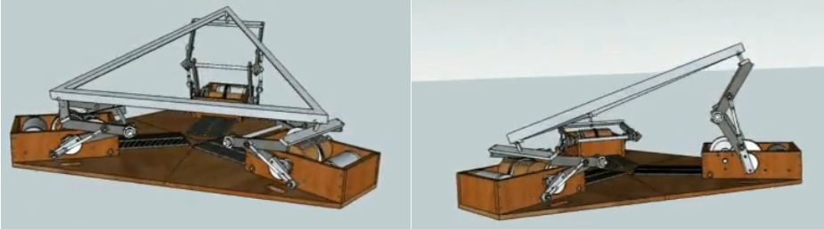

    Hi Frakk - it's back to bungees after all with this design!

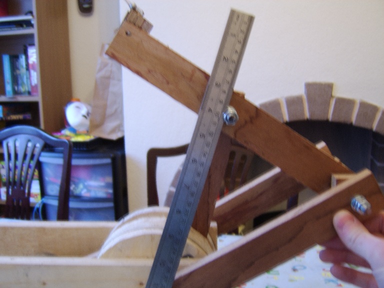

    When measuring to identify the correct spring rating and overall dimensions, I have discovered a problem that I had not anticipated!
    I have designed a spring mount that would be absolutely perfect if the frame was fixed and the joint was to operate only in the vertical range, or if the horizontal arm was fixed... however...
    as the design of this actuator is to be used as one of a set of 3 arranged in a triangle, and the movements of either of the other two actuators will affect the vertical position of this one relative to the central spindle, springs aren't going to work quite as expected... this picture illustrates the potential range of movement:
    (the screenshots come from Rolandvanroys video as linked in the thread earlier)
    There is a suprising amount of variation in the position of the top and bottom actuator arms - the springs I would need to be looking at would be significantly affected by a 2cm variance in position, meaning that the frame would move disproportionately in the vertical range. These pictures show the range of movement over quite a small horizontal range with the motor fixed in the same position
    Because the bungees are fixed to the central spindle which is not moved by input force from the other actuators, they are able to support the actuator in a fixed vertical position regardless of the movement of the rest of the frame.
    I am still looking at other designs for linear actuators that will be able to make use of the spring mount though, so will keep that one in the bag for now ;)
    Tim

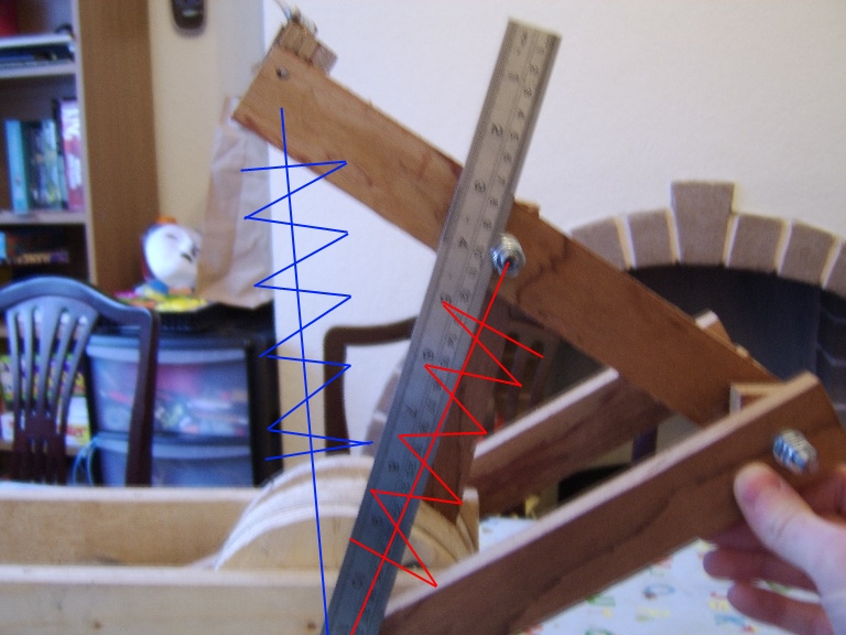

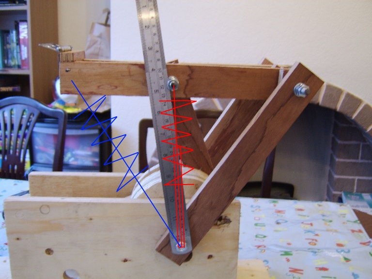

  19. Frakk
    Frakk Active Member
    Apr 15, 2009
    1,144
    328Coins
    I don't see any problems here. :) The spring/shock cannot be fixed at a 90° vertical, it has to pivot with each actuator.
    Red and Blue are two options to mount a spring shock. The spring rate can be easily estimated. Ex. you have a 300lb upper platform = 100lb on each actuator traveling 4.
    Travel/Weight = 25lb/in = Spring rate. Adjust the preload to set neutral ride height and away you go.
    The biggest problem might be finding the right parts as the shock has to be matched for the actuator geometry. An other solution would be to use air loaded pistons, in that case you only have to worry about the size, the spring rate can be adjusted by air.

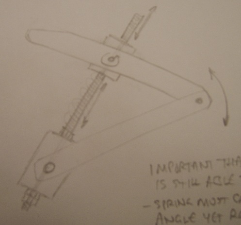

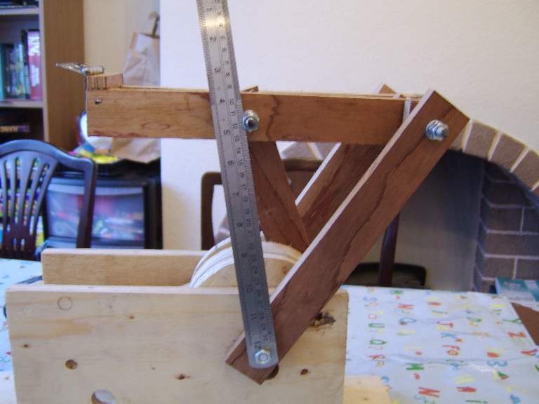

  20. bigtalltim
    bigtalltim New Member
    Sep 10, 2010
    189
    Belfast
    361Coins
    That was my first thought too... we are totally on the same page here!
    The problem is that the actuator arm works like your arm - As you flex your biceps, your wrist moves closer to your shoulder... as you flex your tricep, it moves further away. Locking the position of the wrist relative to the shoulder compromises both bicep and tricep (depending on which way you want to move your arm).
    The following pic goes some way to showing just how much movement comes from the arm in use:
    My spring mount design is simple: it has a central shaft fixed in position, and a top connection through which the central shaft passes -just the same as the suspension leg in a car. It connects just as you suggest (except not to the very end... instead, to halfway along):
    The problems come with trying to find a spring with enough power to support the frame, that will allow a 20mm variance
    Please correct me if this calculation is wrong, but as I understand it, if the spring (linear) has a free length of 100mm and needs to compress to 50mm to support 50KG, the loading is approximately 10kg per 10mm of movement. this means that the 20mm of movement is like changing the weight on the platform by 20kg, and also that the wiper motor arm is going to have to produce huge forces to be able to further compress the spring to move the platform up or down beyond this central point - the range of movement of the wiper arm gives about 40mm movement in either direction... with the amplified movement of the disc, and adjustable position of the vertical arm on the horizontal one, this becomes 50mm or more. Working still on 10Kg per 10mm, I think a sustained 50Kg force or more would be beyond the wiper motors I have...
    I am still looking into springs for linear applications, but for this actuator, I dont think I will find a commercially available spring that would work out.
    That said, because you are so sure this will work, and I am not 110% confident that it wont, ...I'm going to try it anyway! :D
    Because I have no springs yet, I have been working on a way of minaturising the bungee arrangement this afternoon - kind of like a compound bow...
    I will be catching up with my bike mending mate over the next couple of days to see if any of his old parts will fit the bill ;)
    Tim
