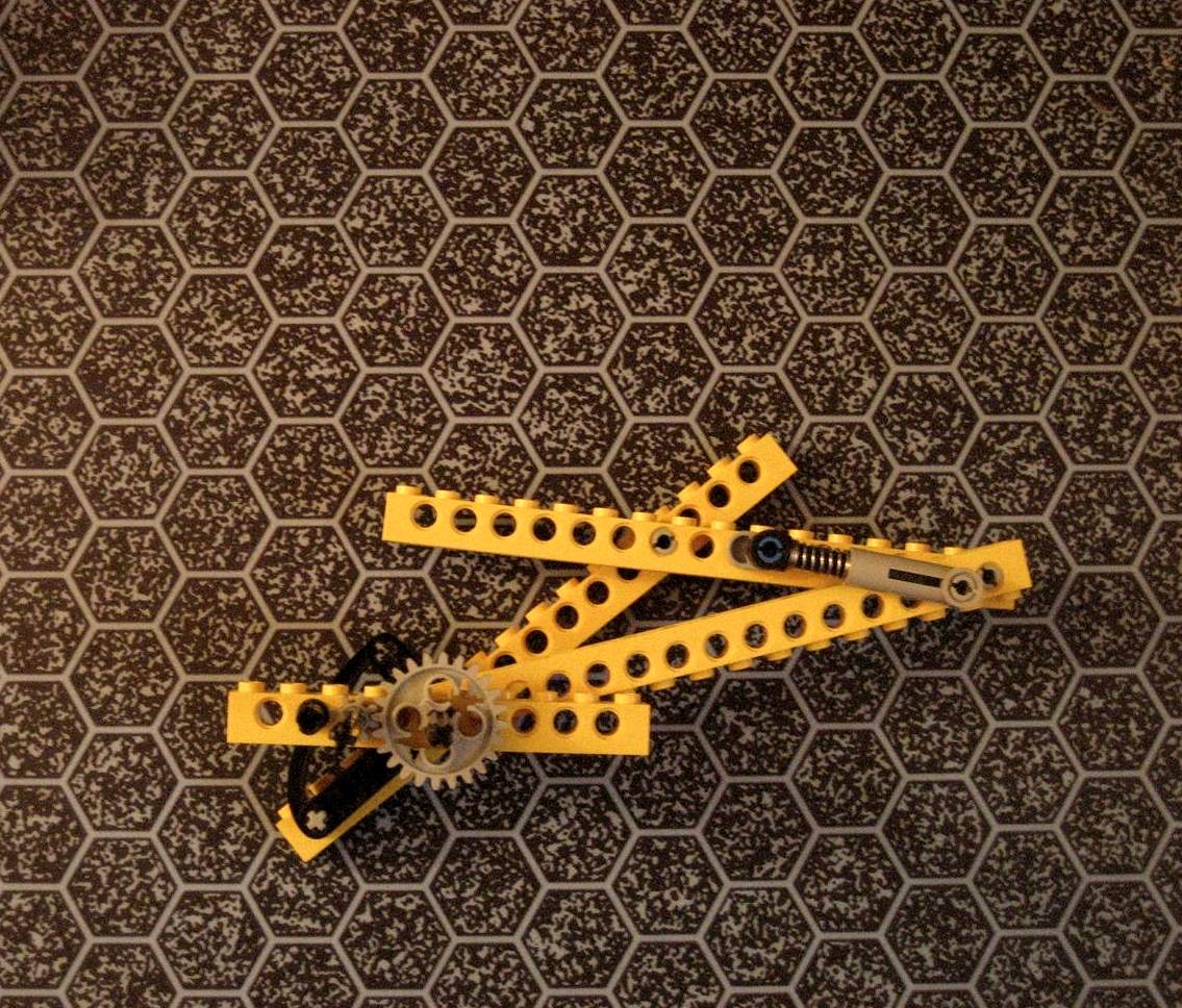

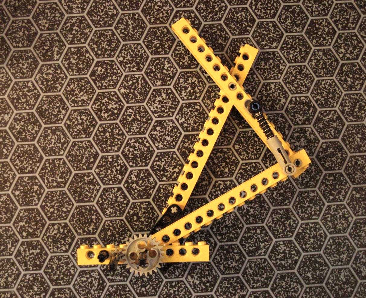

    The AMC motor connector has 6 control pins + 2power. You need a PWM and only one direction pin for one relay circuit, x2 for the 2 axis.
    Tim: On the spring calculations you might be right, a softer spring with more preload will work better. After all, the bungee cords are the same way too...
    The pictures say it all:
    15 minutes playing with the geometry I could arrive at a very reasonable solution, even with the very limited spring travel. The black servo arm is free to rotate in case of runaway. I could not take a picture at 50% because the spring just kicked it out.
    I think this proves my concept. GREAT SUCCESS! :cheers:

    Superb - thats different to both of our initial concepts too! :clap:
    (for anyone who hasn't been following this thread: In both of the original designs, the spring connected to the same central axle as the discs - in the lego pictures they would have connected to the axle of the grey cog)
    Many thanks Frakk - I will have this made just as soon as I can get some springs!
    With the spring so close to the hinge, overloading the wiper motor shouldn't be too much of an issue...

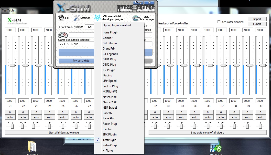

    Hi Menix
    Open the Force sender, and click on Choose official developer plugin
    That will produce the list as in the picture below...
    ...selecting TestPlugin in this list will open the TestTablet window :thbup:
    Remember to click on the Try Send Data button in force sender, or the signals from the sliders will not be available in Force Profiler ;)

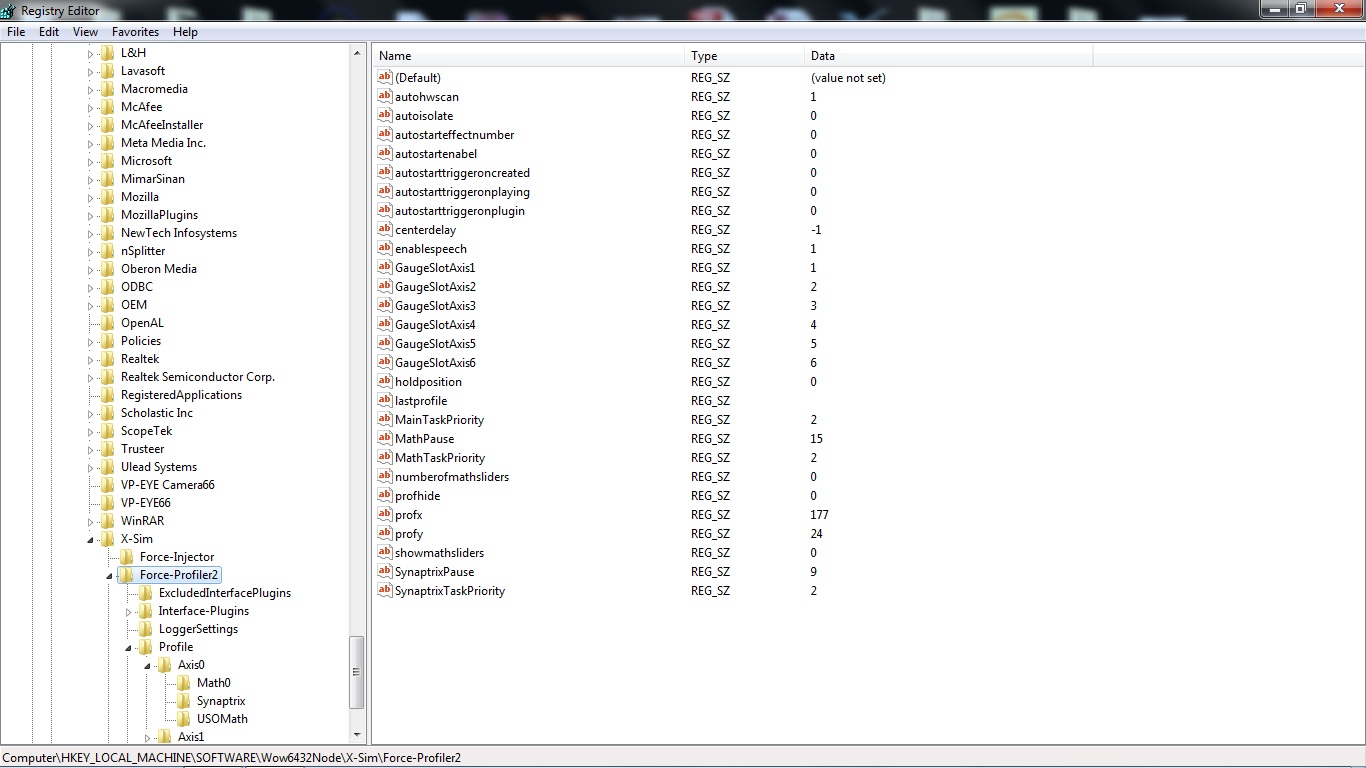

    Heres a quote and a question from a really old thread...
    I have been looking for some time now to discover how this is done - which registry key do I need to change?
    The picture below shows the ones available to me - am I in the right area?
