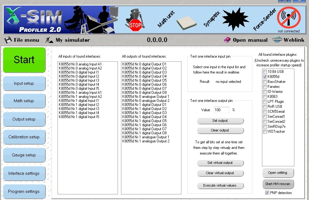

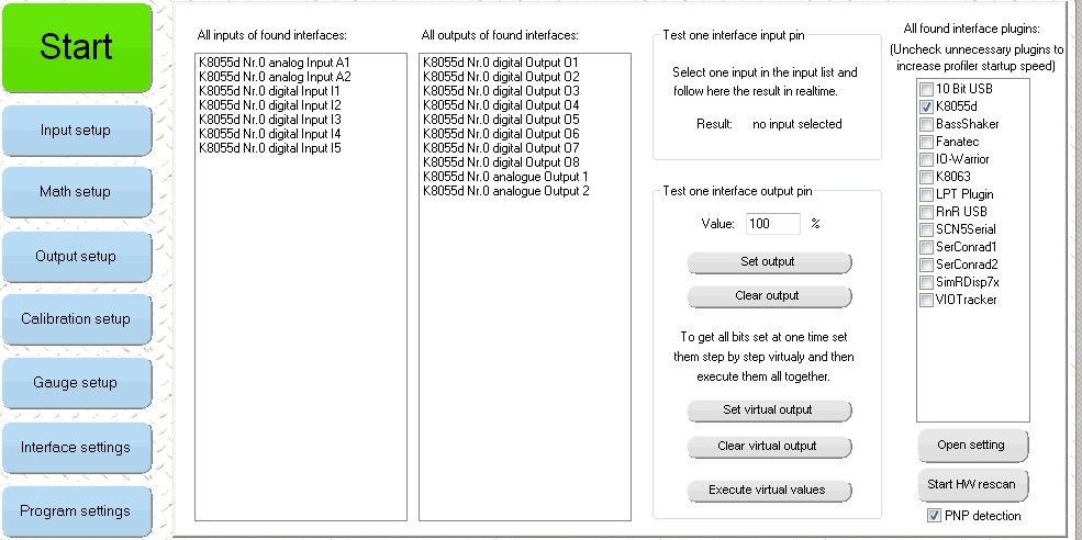

    It's another jumper issue with the K8055! - if anyone has never set jumpers before, let me know and I will post a short video...
    For those who are familiar with jumpers, all you have to do is set the card address using jumpers SK5 and SK6
    (you cant miss them... they are right in the middle next to the table printed on the pcb giving the settings for the card addresses :blush: )
    The following combinations of settings give up to 4 card addresses:
    For address 0, Set SK5 to ON and SK6 to ON (This is the manufacturers default for the prebuilt board)
    For address 1, Set SK5 to OFF and SK6 to ON
    For address 2, Set SK5 to ON and SK6 to OFF
    For address 3, Set SK5 to OFF and SK6 to OFF
    The pictures below show what happened when I plugged in both of my K8055s set to 0, and then changed the jumper setting to 1 for the second board... (unplugging it first of course ;) )
    A quick click of the Start HW Rescan button, and as if by magic, the second set of inputs and outputs appeared! :D

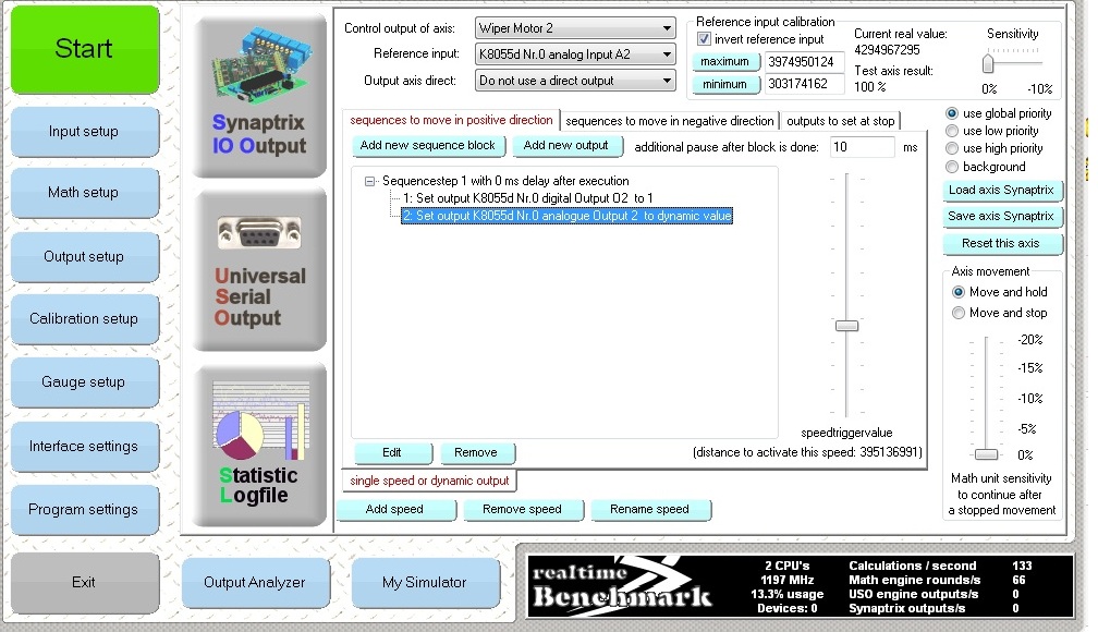

    I am going to do some reading into the sabretooth boards to try to understand them better... in the mean time, try adjusting your sensitivity and speed trigger value - this screenshot below shows the setup I was using for the actuator in the last video... I had to turn the sensitivity right down to stop the platform being jumpy
    One other thing - have you set to Move and hold, or Move and stop?
    If move and stop, what does your stop routine say? mine just sets PWM to 100%... that may not be enough if you are able to turn your motors by hand or under the weight of the platform... I believe that move and hold will continually adjust the position rather than just getting there and turning off!... Move and Hold might work better for you...
    Let me know if any of that helps... I'll see wht I can find from Sabretooth ;)
