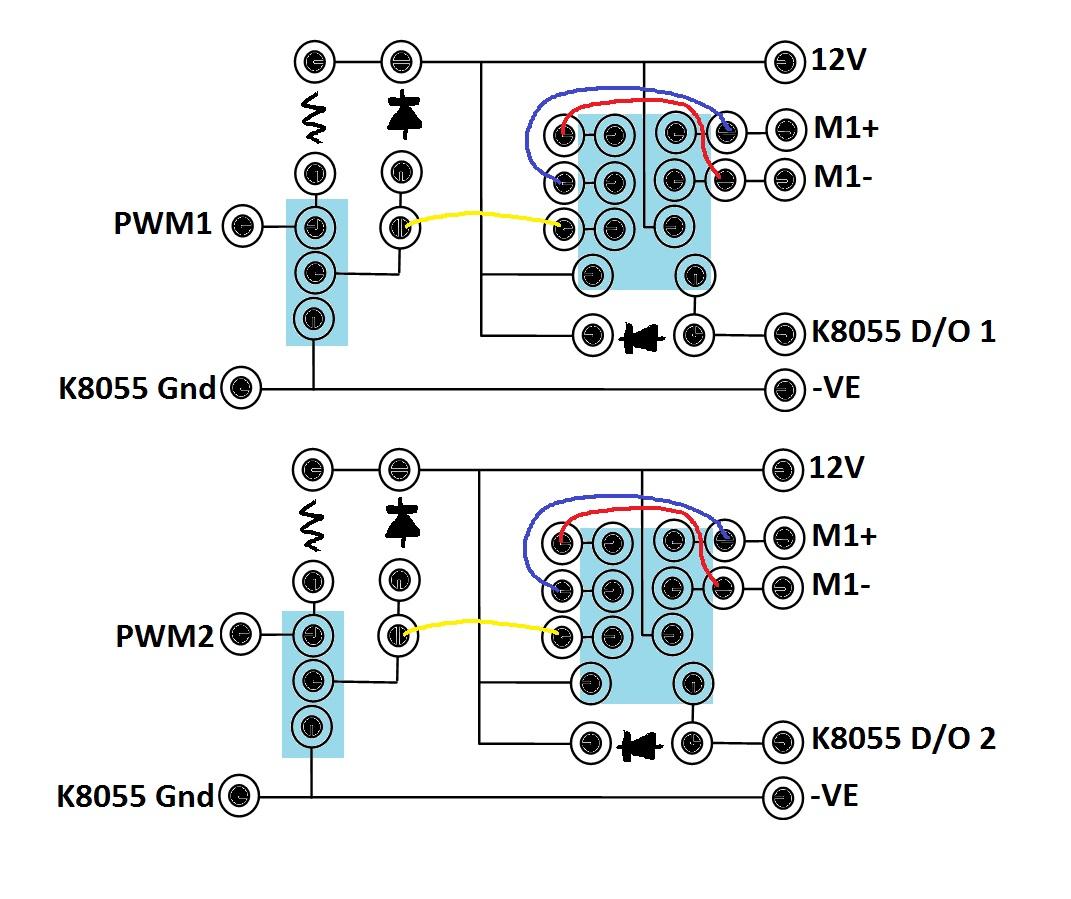

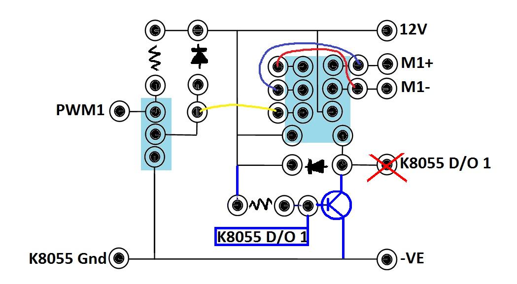

    As long as no part of your circuit is able to overload the inputs on the K8055 you will be fine - that would include by short circuits as Menix suggests... an example would be a short that allowed power to go directly to the PWM input rather than through the 1K resistor, which would be a problem regardless of the voltage used. Always test the integrity of your circuits!
    The maximum voltage and current that the inputs on K8055 can handle (50V and 100mA) should not present a problem with the 12V solution as originally posted - as long as the circuit is operating correctly and none of the components has been shorted or damaged!
    If you use a different relay, check the current draw of the coil - if it is more than 100mA, use the new circuit as below.
    The new variation from CliffyK@Velleman forum opens the door to the use of much greater voltages, but if you increase the original design to 24V without upgrading the components or considering circuit protection you may have problems!
    The difference between the original relay circuit and this new one is that the digital output is now connecting to the base on a transistor (Q2) that amplifies the signal to change direction (switch the relay coil on or off) whilst still protecting the inputs on the K8055.
    Tim

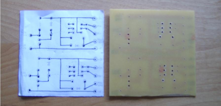

    I will post what I have, but dont have much more than appears in earlier posts... to recap on the original design:
    I didn't use a PCB designer program, so thats all I have - I just drew the tracks onto the copper board with a marker pen exactly as in the diagrams above, and etched around the marker pen... I filled all of the tracks with old solder to improve the current handling.
    In response to an earlier request I am putting together a diagram to show how to wire up the solution, and also trying to get together a description of how the two main aspects of the circuit work in normal language (PWM and Relay direction switching)... hopefully next few days!
    I haven't yet used the new design with 2 transistors... hopefully next few weeks - actuator tests first with 2 k8055s ;)
    Tim

    That is perfect, thank you! It gives me an idea of how you jumpered what to where. I have been pulling my hair out (not much left in the first place) on how to route everything. I see that I do not need a trace, I can use wire.

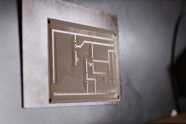

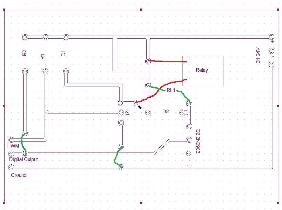

    Here is my PCB based on the above scematic that Tim posted. I will do a test run on the CNC tomorrow to see if my traces are too small or not. I tried to go by recommendations that I could find online.

    A test run of my PCB on countertop laminate material:

    First of all, you don't need to remove all that copper. You can just cut around the traces. You can also make the high current traces much thicker.
    Second, you cannot just take a schematic and make it into a circuit 1:1. You have to design the PCB to accept the component footprints, and not the schematic drawings. For example you can have CBE on the schematic for a transistor, but the actual component could have a BCE footprint.
    It might be easier for you to make it on a perfboard and manually connect everything. This way you learn the pins of your components, and you don't waste time and material making wrong PCB's. It is also much easier to change things if you need to..

    Actually, I was going to breadboard one together first and make sure that it would work before making a circuit board. I did not make my board 1:1, but it was pretty easy to lay out the traces in this order so I went with it. I left the proper space for each component by measuring them and making sure there was enough room and their footprints were in the correct orientation.
    But, even if I do not use this layout for my end design, I wanted to test out my home made CNC table (4'x8') to see if it would do a good job on making a PCB. I am very happy with the results. So far I have only cut out large wooden parts for several projects and a few aluminum and brass parts for a couple of others. I wanted to pocket the PCB to see how well it would do so, again I am very happy with the results and the 1/32 bit that I was using for both drilling and pocketing. I could pocket with a larger bit (perhaps a 1/16) but it would take as much time to change the bit as it would to let the job run. This practice run was 22min. I have as much fun designing the PCB and running it on my CNC as I have had with pretty much anything else in this hobby.
    Good advice on the traces, thanks. I will widen them accordingly. Do you think doubling them would suffice?
