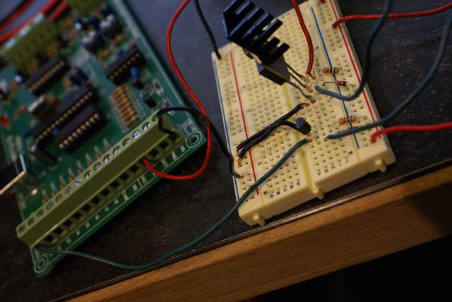

  9. Historiker
    2,162
    9,205Coins
    +2,173 / 19 / -1
    Like Menix I seem to have fried a K8055 board. I connected the circuit up correctly, checked it three times to make sure, turned the power on (I check the output of the PSU before I did this), the K8055 was already plugged in and functioning. I am using the circuit with the extra transistor as protection but I must have done something wrong. There was a broken trace on the board and the PIC is dead. I repaired the trace and replaced the PIC with another from my second kit and it is working fine but I am not going to connect the circuit again until I find out what I did wrong.
    Perhaps I can post pictures of the breadboard and you might see what is wrong?

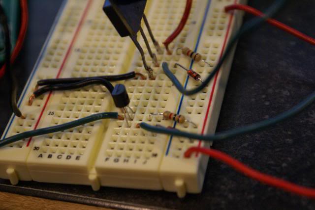

  10. bigtalltim
    bigtalltim New Member
    Sep 10, 2010
    189
    Belfast
    361Coins
    Hi Historiker
    Please do post pics of the breadboard - it might be difficult to spot the problem, but two pairs of eyes are always better than one!
    Please also post the layout of the circuit that you were building, and if possible the footprint layout of the relay...

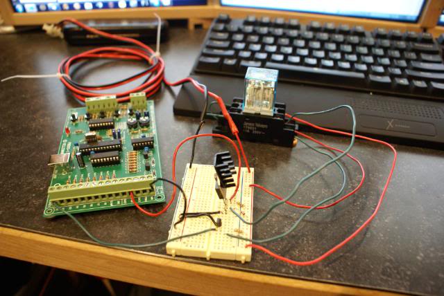

  11. Historiker
    2,162
    9,205Coins
    +2,173 / 19 / -1
    Hi Tim,
    The K8055 in question was pre-assembled. It worked out of the box very well until I hooked it up to my circuit. I had also purchased another K8055 in kit form to use for my third motor.
    The trace was burned, there was no indications of power or recognition from the computer until I repaired the trace. After that I got power to the power LED (LD110) but not other lights (LD8 did not flash), the computer recognized that a USB device had been connected but did not recognize the device.
    I replaced IC3 with one out of my other kit and the K8055 lit up (LD11 on and LD8 flashed three times as it should). Windows recognized the card and I could run the demo program and get it to work in X-Sim as I had before I tested it with my circuit (and the subsequent burn up). I used your profile in X-Sim, works very well. Of course I could only test via software as I had not connected the relay circuit up yet.
    The circuit that I used was the one that you posted for 24vdc use (page 12).
    Components:
    NPN transistor TIP3055 for Q1
    PNP transistor 2N3906 for Q2
    R1 and R2 are 1k
    The relay coil voltage is 24v, 37mA current and 650ohm resistance, DPDT (LB2-24D-S-R)
    Q1- the emitter is connected to ground, the collector is connected to D1 and the relay switch (pin 5, green wire) and the base is connected to R1 and PWM1(red wire) on the K8055.
    Q2- the emitter is connected to D2 and the relay coil (pin 8, another green wire) the base is connected to Digital Output 1(green wire) on the K8055, and the collector is connected to Ground on the K8055.
    The other relay coil lead (pin 7) is connected to 24vdc and the other relay switch (pin 6) is connected to 24vdc.
    The coiled wire (red and black) is the plug from my PSU (24vdc 47A).
  12. bigtalltim
    Sep 10, 2010
    189
    Belfast
    361Coins
    Hi Historiker
    I have only had 2 minutes to look at this, so have not been able yet to work through the whole circuit...
    First impressions are difficult because I have never used one of these boards to connect a circuit... but...
    It is possible that this transistor is in the wrong way... check the datasheet - i think you have collector to D2 and Emitter to ground... havent had time to download the datasheet but as I remember, the leg layout is e-b-c when viewed from the underside with the flat section at the top.
    (I am not sure of the implications if this is so...)
    Please could you post a pic of the burned track on the K8055 - the position of the burn may help to identify the source of the problem
    I will look in much more detail later on tonight.
    Tim

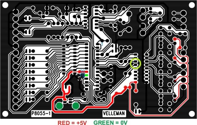

  13. Historiker
    2,162
    9,205Coins
    +2,173 / 19 / -1
    Thanks for the quick reply Tim, you are correct. I did have it wired backward. But would that cause a feedback into the K8055 that would result in damage?
    Here is a graphic from velleman showing the pcb layout for the K8055. I put a light green circle around the trace that was burned out. It runs between the two solder joints.

  16. Frakk
    Frakk Active Member
    Apr 15, 2009
    1,144
    328Coins
    Is there a reason why you changed to a PNP Q2 transistor? It will work, but the PWM-Output will be inverse of NPN.
    This holds true for PNP:
    NPN: Current flows from Collector to Emmiter. Biasing current flows from Base to Emmiter.
    PNP: Current flows from Emmiter to Collector. Biasing current flows from Emmiter to Base.
    The burned track is just a thin connection between the two ground layers. These two ground layers should be connected by other, much thicker connections as well. With that being said, the track was burned because of high currents and it turned into a fuse.
    Can you post a picture how you fixed the ground plane? You should always separate the high current ground path (going straight back to the supply) from the digital ground path.
    My first bet is that you connected D2 in reverse which shorted out the supply when the transistor turned on (as soon as the circuit is powered, since 0V turns on a PNP), causing high currents through the ground plane and the very thin track.
  17. Historiker
    2,162
    9,205Coins
    +2,173 / 19 / -1
    Hi Frakk, thanks for taking a look at my mess ;)
    I am a little confused on your question about Q2 though. The circuit design that Tim posted showed a 2N3906 (PNP) which is what I used. Should that transistor have been an NPN?
    I think you might have hit the nail on the head though with You should always separate the high current ground path...from the digital ground path I have ground from the PSU directly to the K8055.
    D2 was connected correctly, that was one of my main worries when I put the board together, getting the diodes in the proper orientation. Could the mistake be in the circuit design and D2 should be reversed because Q2 is a PNP transistor?
