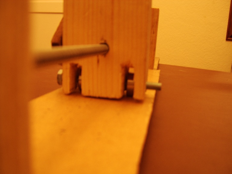

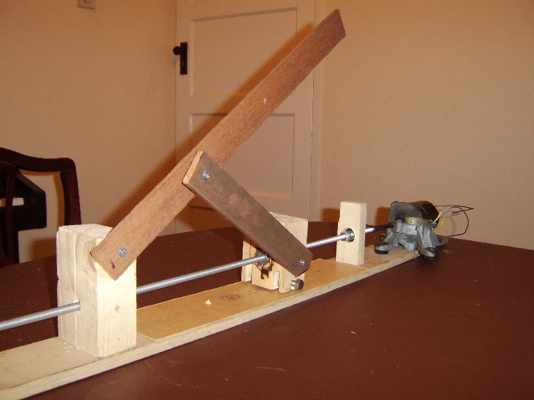

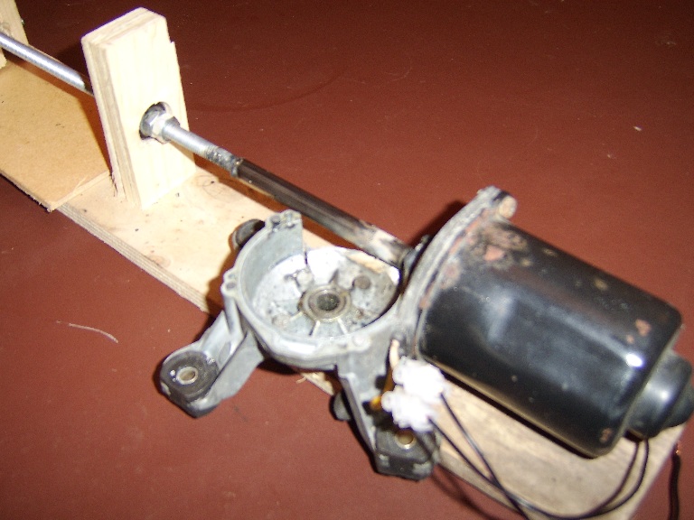

    simplified actuator design... fail :(

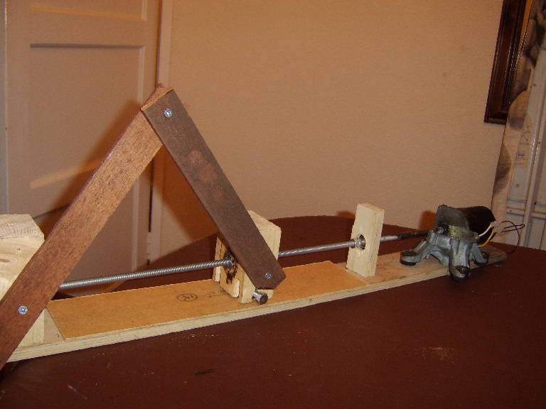

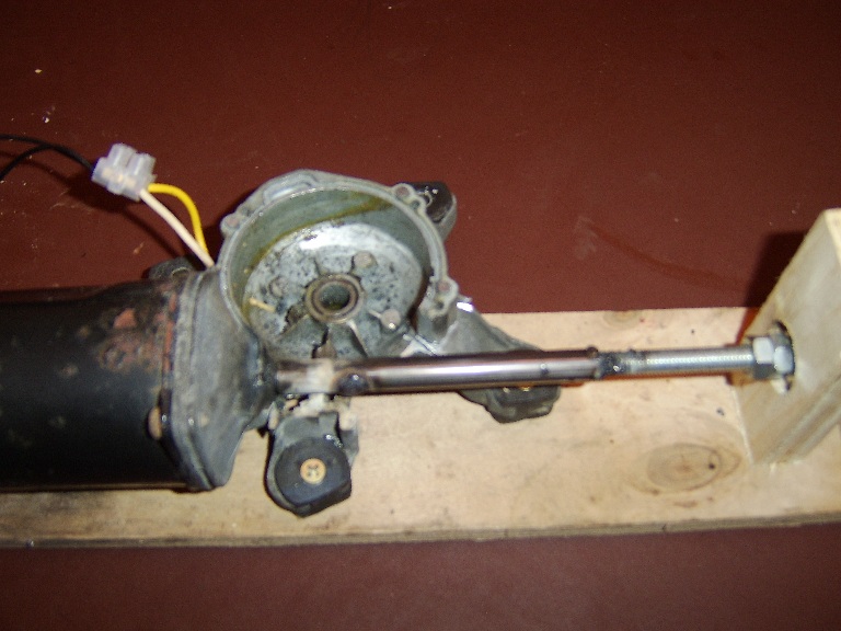

    I have been working on different actutor designs that are simpler and lower profile than the bungee supported ones I tested earlier in this thread... those ones are great, but not really practical for a home build unless you are lucky enough to have a well equipped workshop!
    I tried the following design in a number of different configurations with an old wiper motor that had a damaged nylon screw inside, so it was no good for normal use...
    The results were interesting - it is cheap, very fast and very very simple to make compared to the other type of actuator...
    Unfortunately, it is also weak under load - the motor does not have enough power to spin up from a standing start with a heavy load so it is no use for my intended application - With a more powerful motor perhaps... but not with a simple wiper motor!
    There is one feature in this design that worked very well though, and that I would like to share (as I haven't seen it anywhere else):
    The screwthread moves an actuator forwards and backwards... this is supported on two bearings from a skateboard to support large loads and remove friction from the forwards and backwards movement.
    Two more skateboard bearings are used in the uprights that support the threaded bar, and are included to reduce friction from the rotational movement.
    This worked very well
    The motor itself required very little in the way of manipulation to adapt it to this kind of application - I just popped the top off, pulled the damaged nylon screw out and spot welded (very badly!) a piece of 8mm internal diameter pipe from the worm gear on the motor spindle to a piece of 8mm threaded bar.
    Conveniently enough, the diameter of the spindle thread in the wiper motor was 8mm (but had a different pitch)
    I am tempted to test this setup to destruction to see if an acceptable power can be achieved by overloading the motor - maybe with 15V like Deriy... As I mentioned before... the wiper motor is little use for a standard application.
    Back to the drawing board with this concept for now ;)

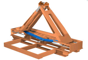

    Interesting, Im test on paper at the moment to include the sarrus link into my boat winch design.
    My winch can already std life about 180kg with minimal load on motor but travels in a rotational movement, so by adding this type of link setup, I hope to achieve a vertical movement of about 200-300mm with increased force and speed.
    Now time to work the levers out,drawn 1:1 in autocad this shouldnt take long.
    Possibly can be done with a wiper too.

    You should be able to achieve increased range of travel and speed, but it will be by sacrificing power so you wont get the increase in force and speed that you are hoping for - fast transfer through 200-300mm of movement is completely possible with a powerful motor and a suitable arrangement of the arms of the actuator, but much as I hate to be the bearer of bad news, I'm afraid we are stuck with only ever losing energy in a transfer machine so the increase in speed and travel results in a decrease in power
    By using bungees to support the actuator you will be able to reduce strain on the motor and support the arm of the actuator in the right starting position, but it will not boost the power of the machine
    You have probably seen it already, but there is a post on page 6 of this thread that shows how my own actuators work including a video of my prototype in plastic corrugated board that may give you the kind of dimensions you need - it took a lot of experimenting to find the right ballance of range and power with the wiper motor... shouldnt be a problem for your winch, but the layout might still help!

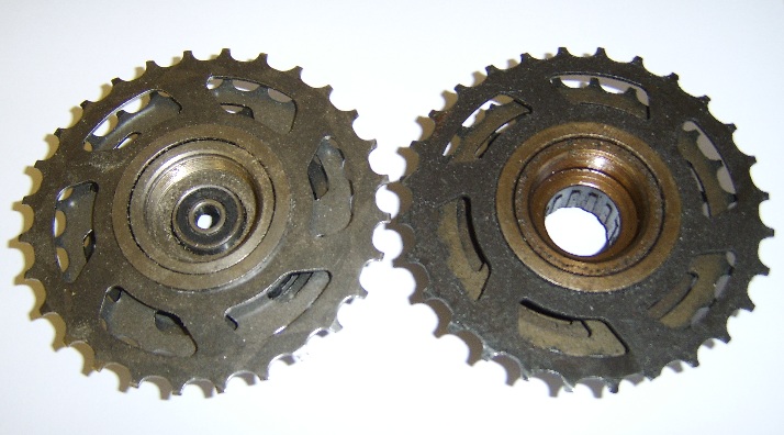

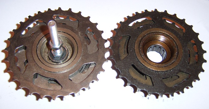

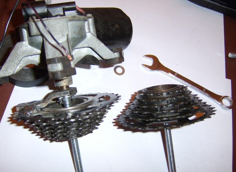

    After the disappointing attempt to make a screw type actuator, I got to thinking about power - and how best to multiply the power of the wiper into useful movement that can easily be incorporated into a design...
    I spent a morning playing with different voltages, but the motor was little better and I was getting frustrated so I went for a ride to chill out... well - I nearly went for a ride! As soon as I got the bike out, I got my idea!

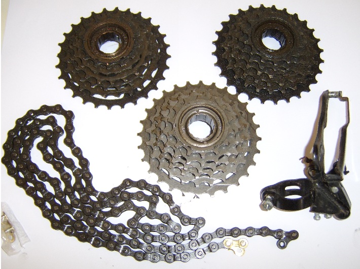

    I am now experimenting with gear reduction by cog and chain!
    In keeping with everything I am trying to achieve with this project, the cost of this experiment so far is £0 8)
    For anyone wanting to try this, all you have to do is go to your nearest mountain bike servicing shop, and ask for either a freewheel or a cassette. As they usually find their way into the bin during servicing because of a single broken tooth, or slight warp, or just for being slightly worn, you should be able to get them for nothing (except maybe a tip to ensure an ongoing supply ;) )
    From the bin in the bike servicing department in Halfords today, I rescued all these lovely greasy (and one brand new but slightly warped) gear sets and chain!

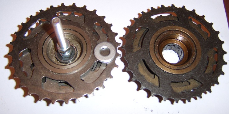

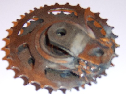

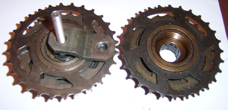

    Continuing my love affair with cheap bearings from skateboards, I was overjoyed to discover that the standard bearing is a perfect fit into the centre of the freewheel/cassette! The gear set itself contains a ratchet that freewheels in one direction only, so it is necessary to add a bearing to the centre that can freewheel in either direction (not necessary for the cog attached to the wiper motor, but definitely needed for the other sets in a construction).
    Just whack it in with a hammer :D

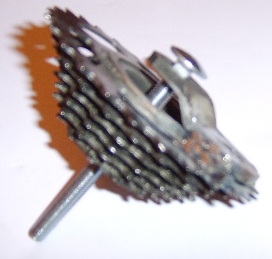

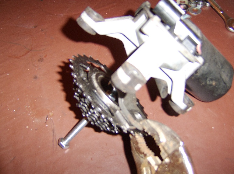

    I then stuck a bolt through the middle, with a nut as a spacer and added the arm of the wiper motor - as the wiper motors have a special fitting onto the arm, you really REALLY need to make sure that it is the right way up before welding it in place!!
    With this all held in place by a mole wrench, I tacked the wiper arm, spacer, and gearset together, and then disassembled it to do the proper weld (badly as usual!)
    The finished gear/arm set:
    When attached back on to the wiper motor, I use a long bolt onto the end of the wiper drive centre, which supports the centre of the gear set via the skateboard bearing - which means that more force can be applied without overly straining the welds (which is particularly important for me, as my welds are rubbish!)
    Here is a video of the motor running - the gear set is very slightly warped, but at the speeds I need, I dont believe it will be a problem.
    http://www.youtube.com/watch?v=qb1y58D_FEc
