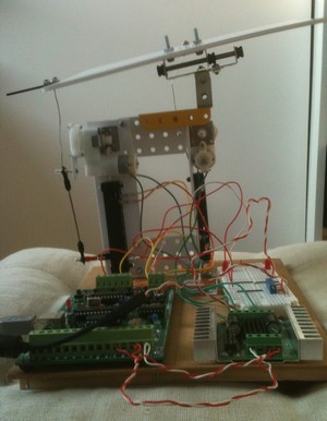

    Here is the result of my work. I have already given you a complete tutorial, and now I give you a video to show the result.
    For the moment it is only a prototype...
    Just to show that the combinaison K8055 + Sabertooth works perfectly.
    This is a demonstration with GTR2 :
    http://www.youtube.com/watch?v=At466IvfuCM

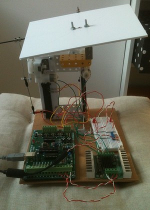

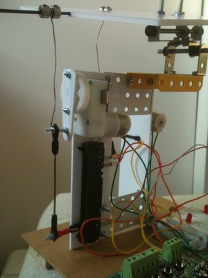

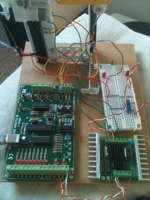

    Hi all,
    I post some pictures of my prototype :
