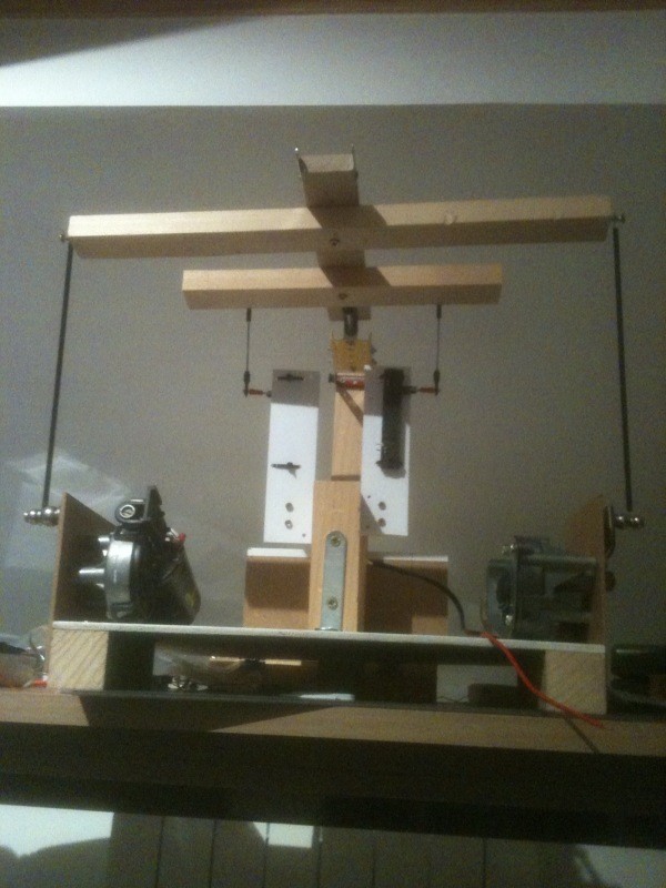

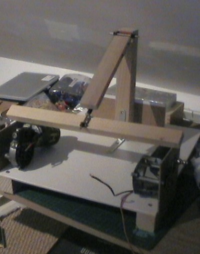

    The last project...under construction.
    This is also a prototype, bigger than the previous one. This project will normally show how to use 2 wiper motors, with a configuration like SCN5 (brake = 2 wiper motors up, throttle = 2 wiper motors down....). I have also a simple solution to place the potentiometers. I hope it will work easily.
    I continue to build the frame...so it will take few days.
    Regards

    The last picture...and also the last idea concerning the potentiometers.
    I wanted to keep the 2 slide potentimeters. My idea was to place its just under the frame, near the center.
    In this way, the potentiometer will reproduce the movement of the frame, but with a lower amplitude (small potentiometers).
    I had not the time to try this new frame yet.
    But, I will keep the forum informed about the later tests, off course !
    Regards
  20. bigtalltim
    bigtalltim New Member
    Sep 10, 2010
    189
    Belfast
    361Coins
    Re: Small Prototype / VM110 + Sabertooth 2 x 10A
    Hi Adbgg - its really taking shape!
    I have almost the same concept for a frame - my latest prototype has a universal joint directly under the seat which is where most of the weight is supported, and actuators with a big range of movement connected close to the drivers feet where the force from the seat and driver is at its weakest...
    On a design point, I think it is interesting to note that this solution using linear pots is similar to Deriys rotary ones, but without any of the drawbacks!
    For anyone who has not studied Deriys design, it uses pots that are not attached directly to the motor, but are indirectly attached to the motor (via the frame base) instead... he has an arm and ball joint linkage to convert the near linear movement of the frame into rotary movement
    This solution just uses the near linear movement of the frame to drive a linear pot - much simpler, and less to go wrong!! :clap:
    This approach means that we don't have any of the bother of having to calculate reduction ratios, or include complex linkages (or try to buy 45 degree pots) - a cheap linear pot and a simple piece of wire will do; and it is possible to ensure maximum range usage by simply moving the pot closer to (or further away from) the fulcrum where the range of movement is reduced.
    I really like this approach for it's simplicity, and for the fact that it can be so easily adjusted to ensure that the whole range of movement is utilised for best position feedback!
    This approach is now an important piece of my design for reasons of pure simplicity!
    Nice work Adbgg :cheers:
