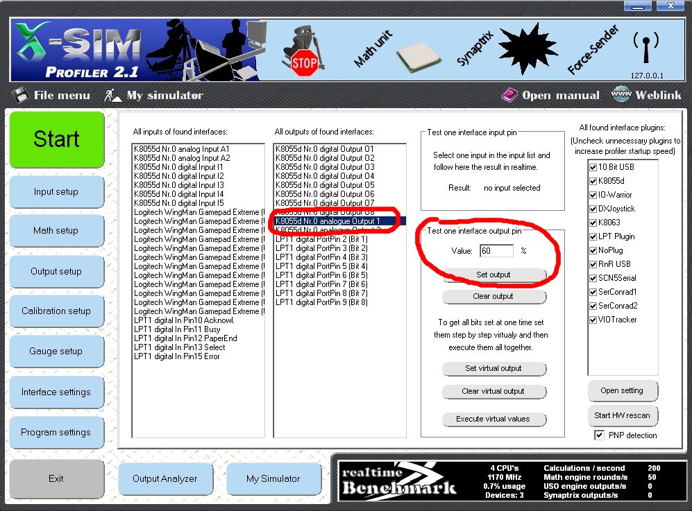

    Hello everyone. First of all. Sorry for my patetic English. I´m making this proyect as aabbgg and other people.
    I have a problem and i think it´s because i´m using a computer´s PSU (12V DC) very cheap.
    I have proob all the conections with velleman´s software and it appeared that it´s correct. I can move the 2 motors side by side and the 2 potenciometers too, all manually in this software.
    It doesn´t looks like the picture. I see a blue bar up and down in AD1,AD2 (potenciometers) and i don´t know why. I suppose it is a different version of software
    But when I try X-sim and when i change the value of the interface output to 40-60% it stops all. The PC´s PSU
    Do you know if its a problem? or i have to buy one with 30-40A because i´ll want to have only one PSU
    P.D: Ad1 and Ad2 (potenciometers) shouldn´t move when i move the motors or i have to config x-sim software firstly

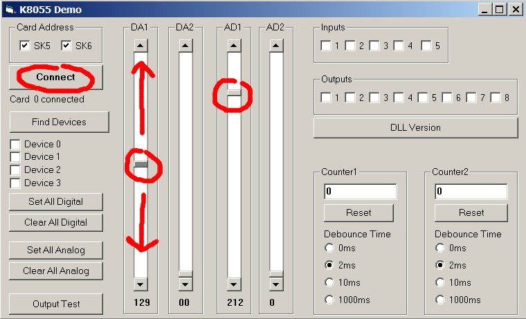

    when you test your installation with K8055Demo. When you move the slider DA1, normally you should see the blue bar AD1 moving . The same with AD2 and DA2. Is that right?
    I think your installation stops because of your PC power supply that switches to safety because of intensity peak due to the brutal change of direction of rotation of the motors

    When you set up the analog outputs at 55%, it is normal that the motors stop since it is the value that instructs the engine to stop.

    Yes, as Stephane61 has already said, normally the motor should stop when you fill in around 50% (55% exactly in my case).
    It means, 55% of 5V, so approximetely 2,5V, which normally stops the motor linked to the sabertooth.
