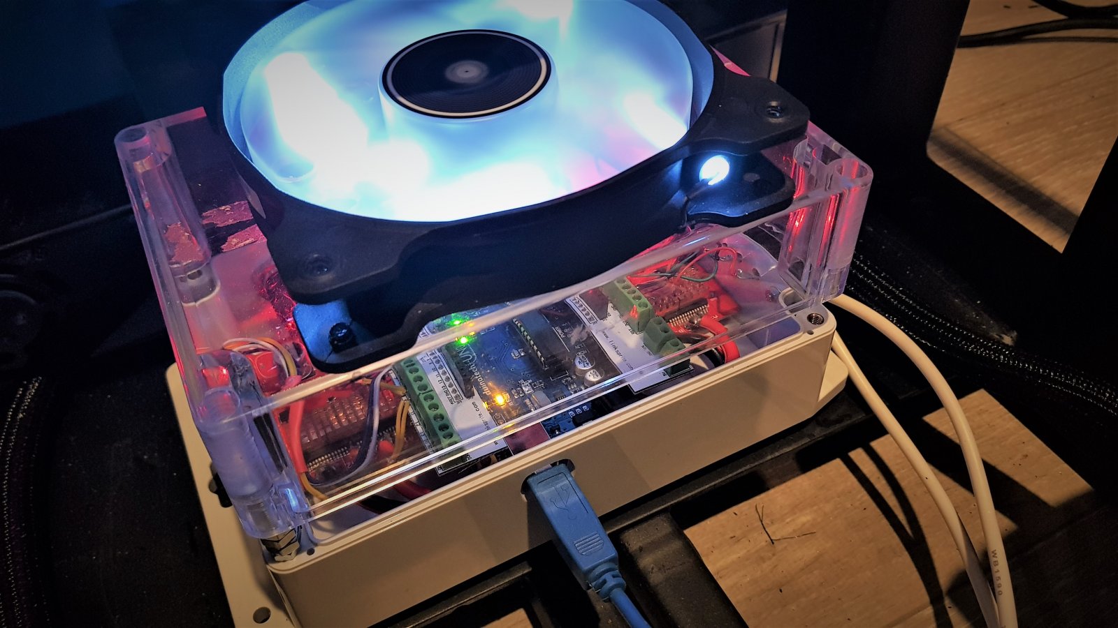

    @kanuk - will those MMs have some ventilation/fans in that MM/Arduino controller box? If the box only has a lid that’s a pretty small volume that might heat up on you. Nice looking rig!
  2. kanuk
    Jan 24, 2015
    214
    Eng
    Melbourne Australia
    2,380Coins
    +202 / 1 / -0
    Hello @Zed
    Thank you for your kind words
    Yes. It is cooled. I have a 120mm cooling thru the cover with holes and I have left an air gap between the cover and case. It's not a permanent solution however.
    I have 2 x 40 and 2 x 50 mm fans coming to have direct cooling onto the MM's :)

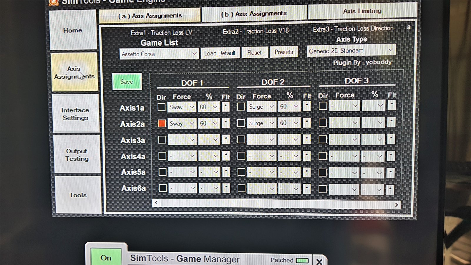

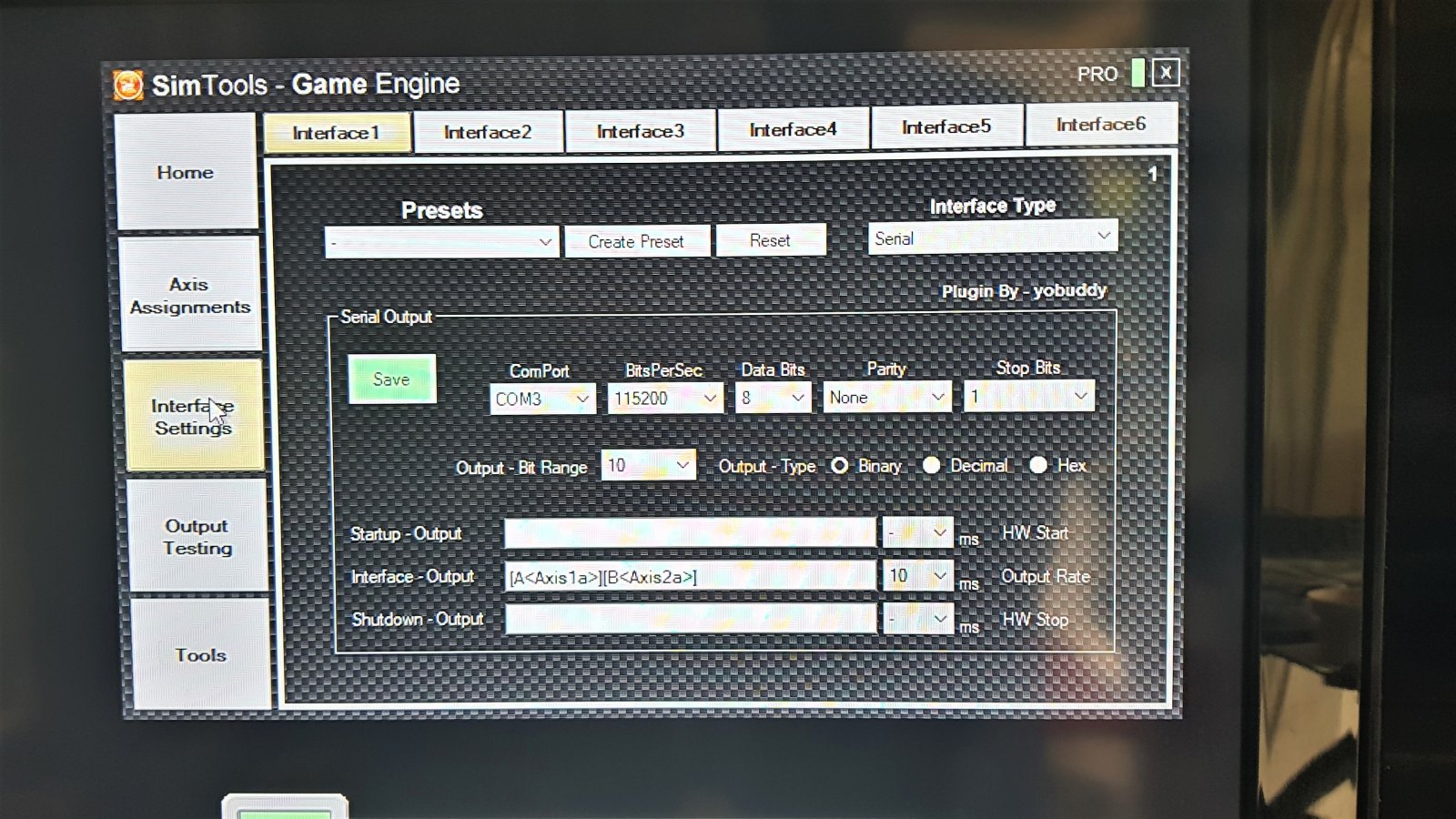

    I have had no success
    Tried almost everything and I am sure it's me of course but to no avail
    I am going to post my settings but nothing is different from all the tutorials I have read
    22,185
    154,750Coins
    +11,196 / 57 / -2
    Do you mean with SimTools settings? If so the difference from SimTools 1.3 in old documentation to SimTools 2 in setup is that in the Interface Settings instead of axis defined like this <Axis1> it now has designate grouping for a or b in SimTools 2 for each axis assignment, like this <Axis1a>

    yer sir @noorbeast
    After testing the controller on smc utilities I installed the ard on the gaming pc and loaded and set up simtools 2.2 but this is where I'm stuck. With no movement. any advice on what I should do?>

  13. noorbeast
    22,185
    154,750Coins
    +11,196 / 57 / -2
    For SMC3 the settings are Baud rate 500000.
    Is you ComPort correct for the gaming machine?

    The com port is correct yes. @noorbeast
    I will adjust the com port speeds within the interface and the actual port in windows. Thank you for the heads up

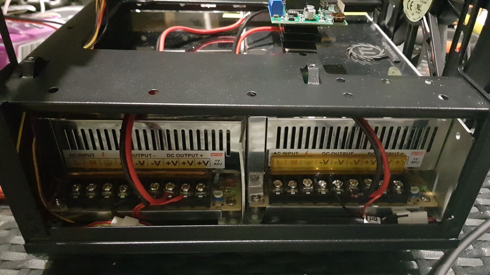

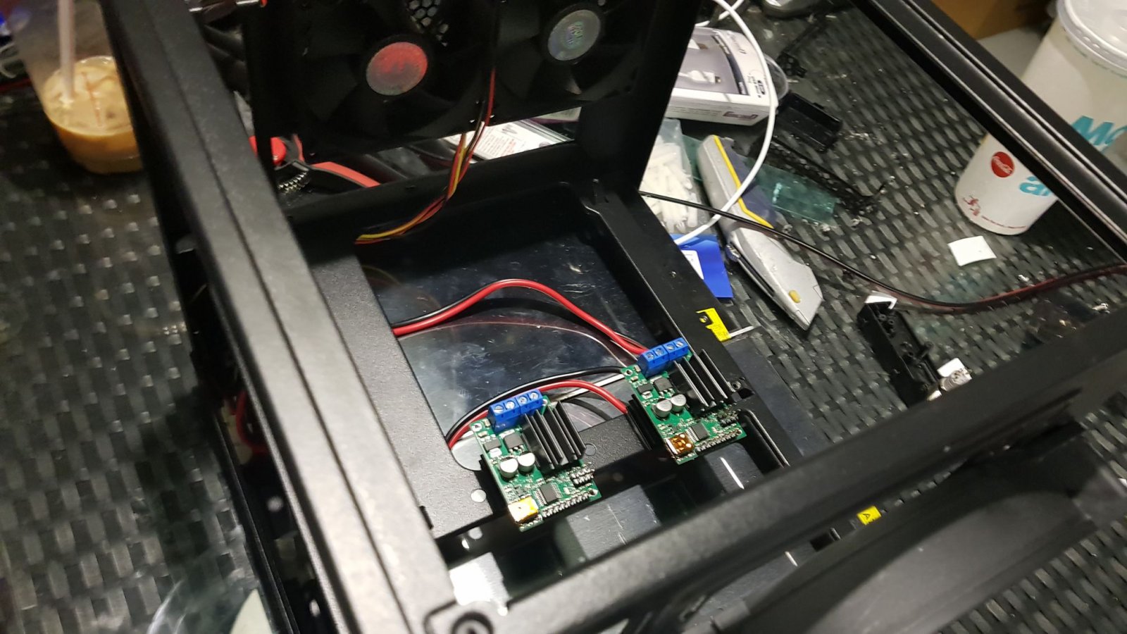

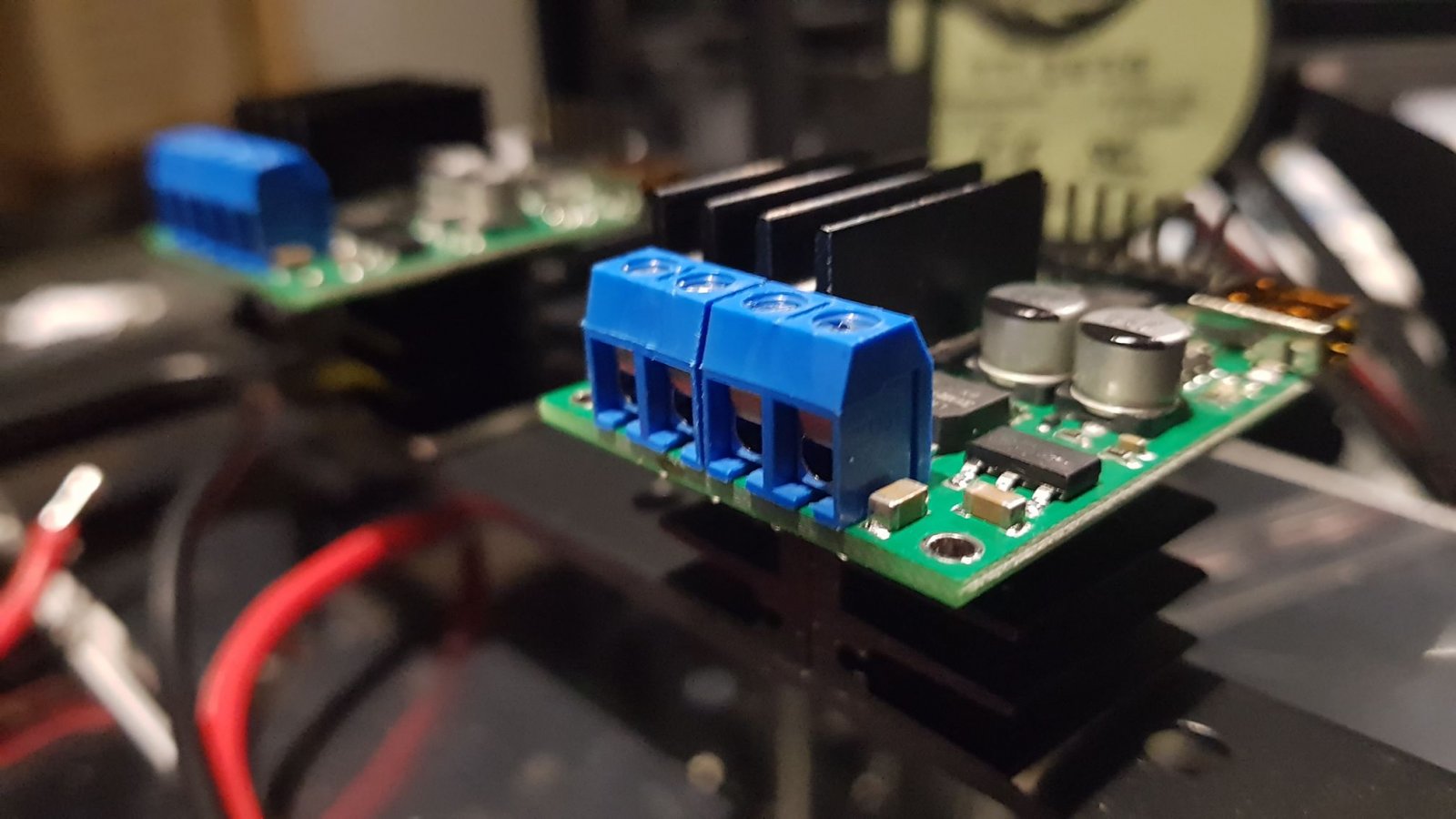

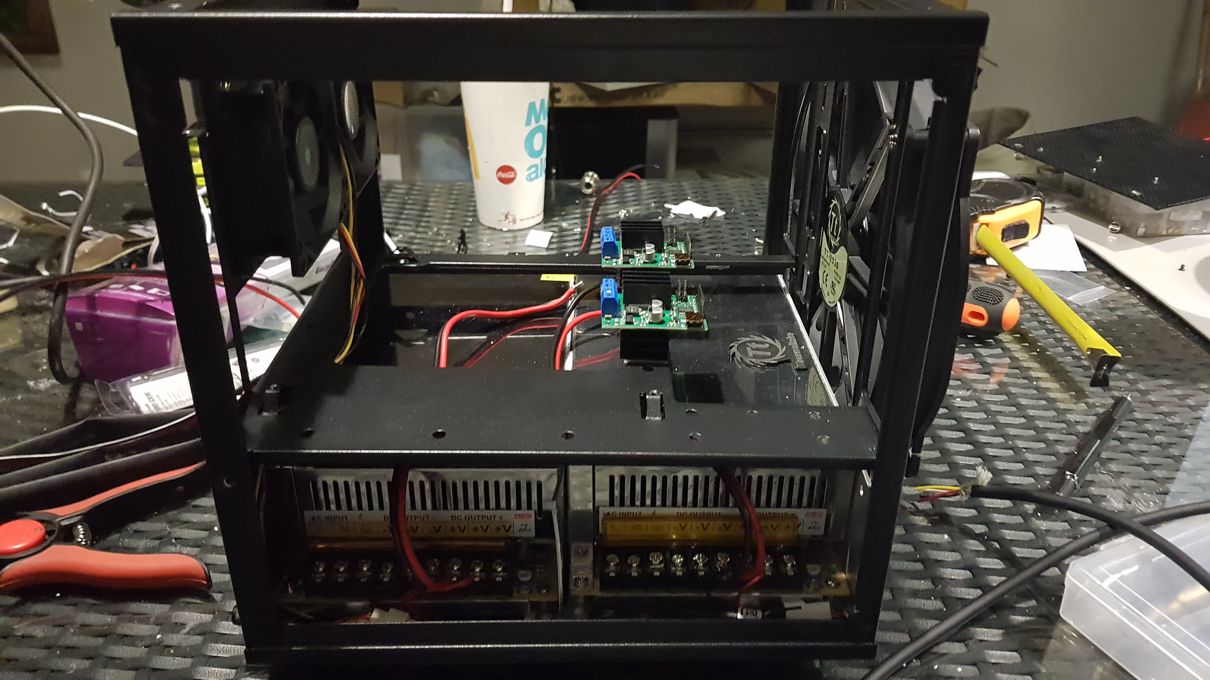

    So after having had a myriad of issues setting up the Ard/MM combo I built (and yes, it is working in SMC Utilities), I have decided that I will use it for the 320W motors that I have included in my flight chair or even possibly upgrade that to a Ard/sabertooth2x32...
    In the meantime I have decided to convert the race sim to JRK's as it seems a whole lot easier to setup for a beginner and besides the wonderful @noorbeast is happy to give me a hand.
    I started the controller build tonight and encased it all in a TT Mini ITX case along with 2 x 60A PSU's. I read @Zed 's article on Pololu cooling and thus I decided to heat sink the top and the bottom pad for good measure. @Zed , do you think this will be enough sir? The case itself has a 200mm fan in the front and twin 80mm rears extracting air and I am thinking that this will be more than sufficient to gool the JRK's.
    Here are some pics then...
  20. kanuk
    Jan 24, 2015
    214
    Eng
    Melbourne Australia
    2,380Coins
    +202 / 1 / -0
    I am planning to utilise the remaining space for ancillaries that I will add (eg. 3rd PSU And Pololu for 3DOF addition in the near future!) etc.
    In the meantime and tips and advice would be gratefully receeived of course!
