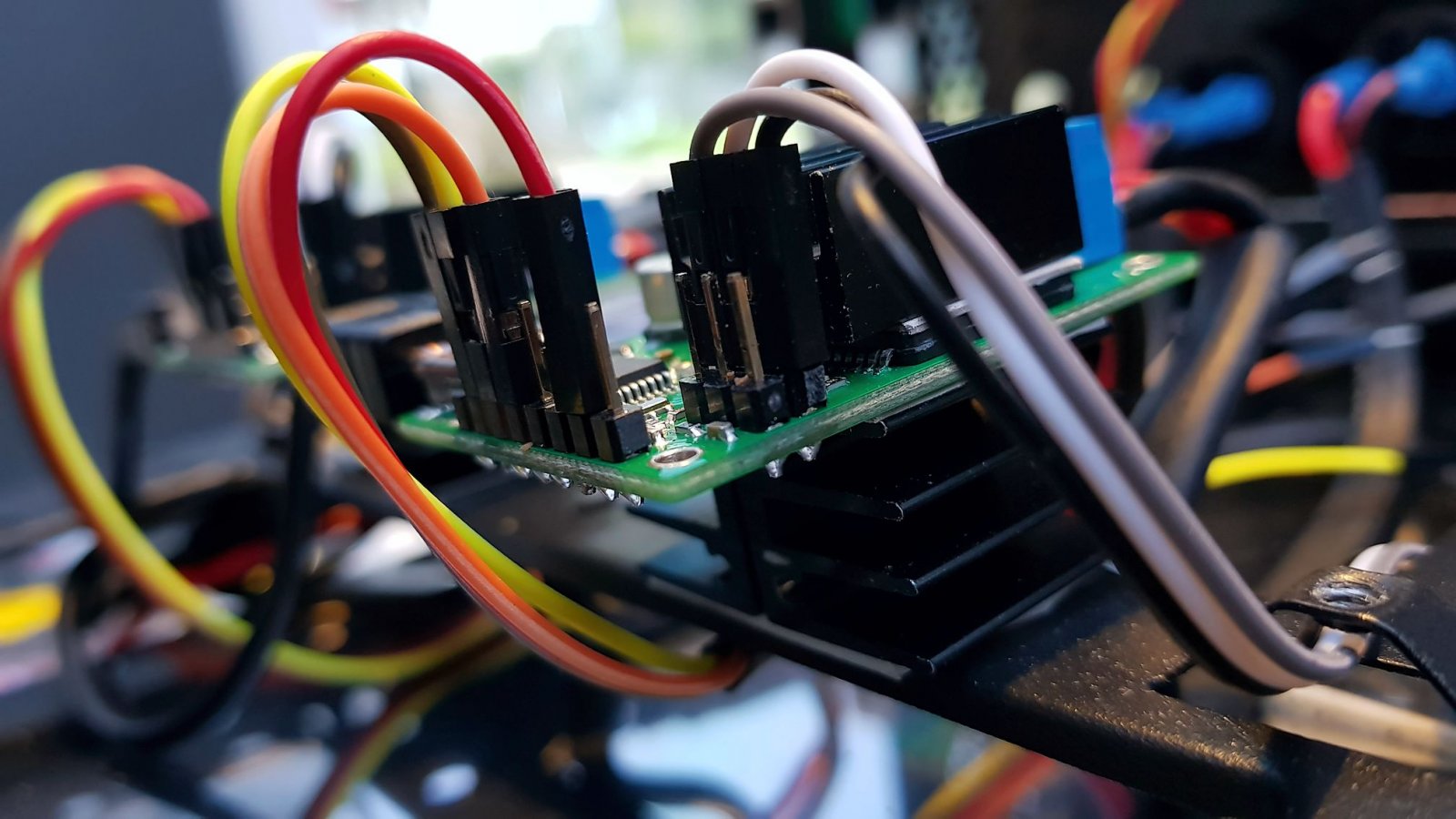

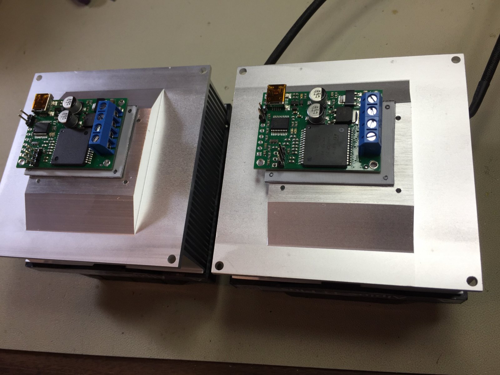

    @kanuk - I can’t really see how you are sinking the bottoms of the boards in those photos but folks here have pretty good luck sinking the chip itself so anything you add through the bottom of the board will certainly improve on that. Just be sure that your thermal pad material doesn’t let anything short to the bottom heat sink. That’s one thing you need to be careful of with sinking through the bottom of the circuit board.
    But I only have sinking on the bottom of my JRKs - nothing at all on the top save some scavenged heat sink air that gets ducted to blow over the component side of the boards. No failures so far with fairly extensive, multi hour continuous use, and everything is running cool. Running with both should keep yours very happy.

    @Zed - Nothing touching at the bottom. I have used those very same type of heat sinks on top but tow at the bottom joined length ways and avoiding any other part of the board by a great margin. I read the datasheet in your post on the sinking of these Pololu's and you are definitely right. The board is utilised as a damping heat absorption pad, but without donig any tests I'm not quite sure what the dissipation of the heat is like via the bottom. Thus I thought it would be prudent to have a heat sink on top as well. Can't have too much heat sinking right? Plus its thermal padded to the chassis for anything extra that may or may not be of further assistance.... Not to mention the 200mm fan blowing right in front of them and the twin 80mm's extracting at the rear... Should be plenty of airflow!
    I'll take some clearer photos tomorrow and post it for your viewing sir...

    @kanuk - When I was figuring this stuff out I used my wind fan motors as a load. At full tilt they were rated at 6 amps each for 12 amps total in parallel and that is the spec on the 12v12. When I would fire that up with no additional cooling or heat sinks, the base of the 12v12 would get warm quick and the bridge chip would get warmish but slower. Certainly not quantitative but it's further verification that their heat dissipation design works well. But you are also right - it doesn't hurt to keep these things cool especially considering how expensive they are.
    Good luck with your build!

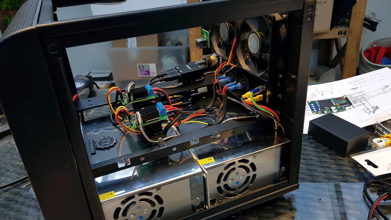

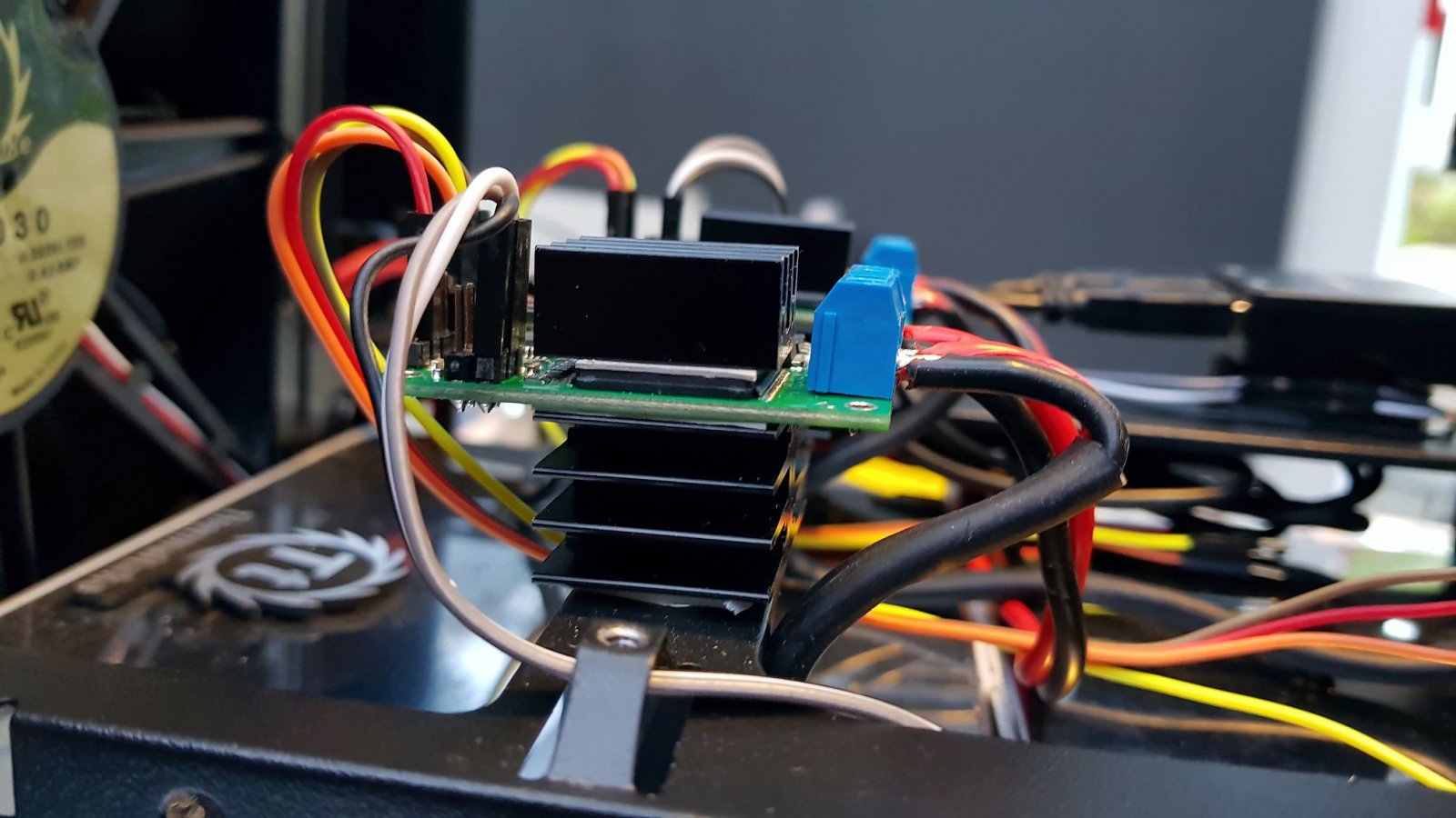

    @Zed
    Pics for your perusal. how the JRK's are mounted

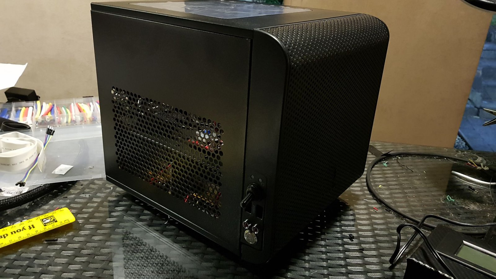

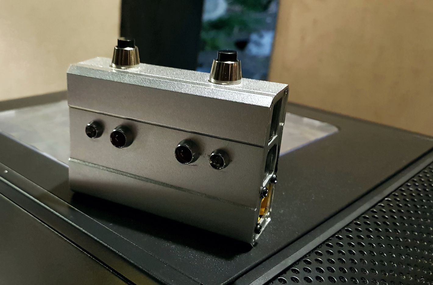

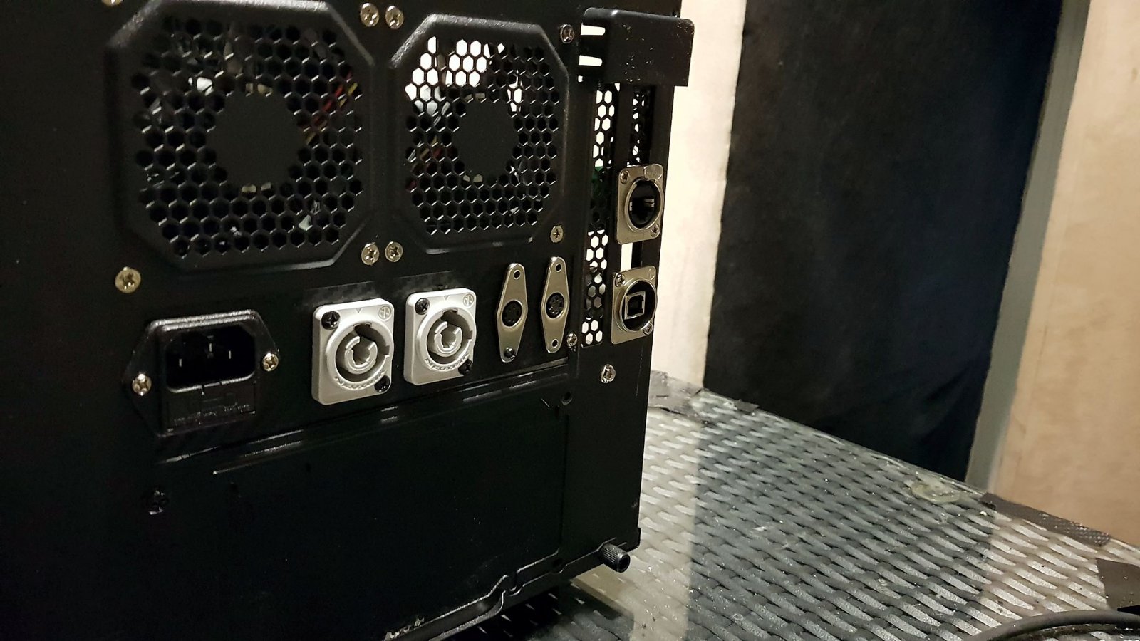

    The 'JRK's in the box' is almost complete bar a couple of minor details.
    I used 4 pin mini DIN's for POT feedback (so any s-vhs cable will do for the connection) and also wired up the Pololu's for the rest box.
    Everything in place now so next stage setup! :grin

    @kanuk - I’m guessing those are self-adhesive thermal pads? One thing to watch out for if you don’t also have some kind of mechanical clamp is if heat can loosen that up and they can come off the heat sink and possibly short. On the other hand, you’ll have the extra cooling helping to get that heat out. Was the heat sink on its side to fit within the through-hole pins? Looks good!

    Thanks @Zed

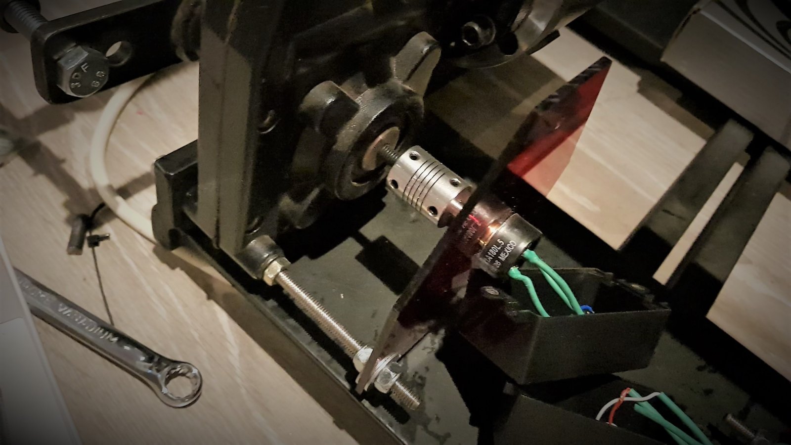

    I have utilised 2 pieces of meccano bent to shape bolted over the heatsinks on the pololus to keep em in place.

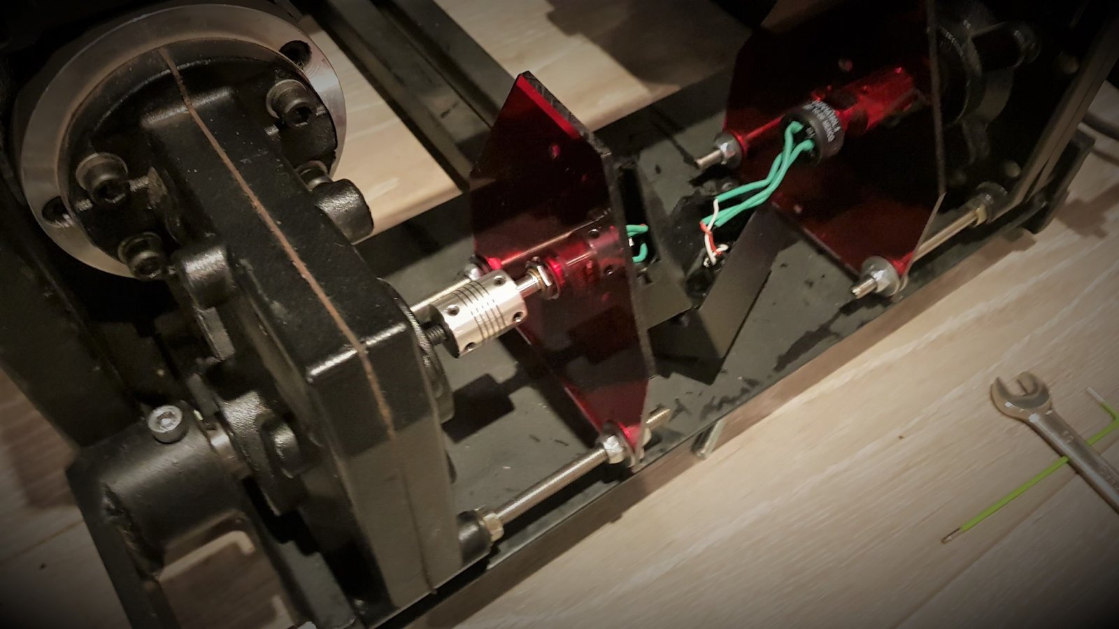

    Just changed my mounts for my pots as I have 50:1 gearboxes on the worm drives and there's no way on earth in moving the levers to adjust the min max values! @noorbeast linked me archie's and bsft's tips on how to adjust the pot and the min max travel for these so that's in progress as we speak...
    Rebuilt the pot mounts so that I have access to adjust them using the bodies instead of the shaft itself....

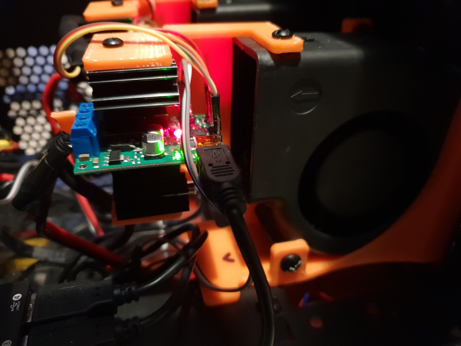

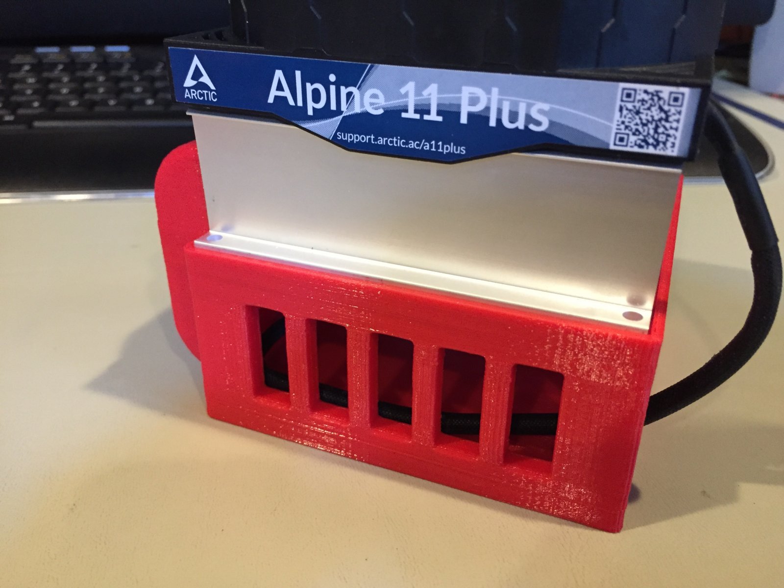

    I have downloaded your Pololu cases and am about to modify them by placing turbo duct fans in them. Any ideas on further cooling Zed? I am inches away from water cooling these babies!

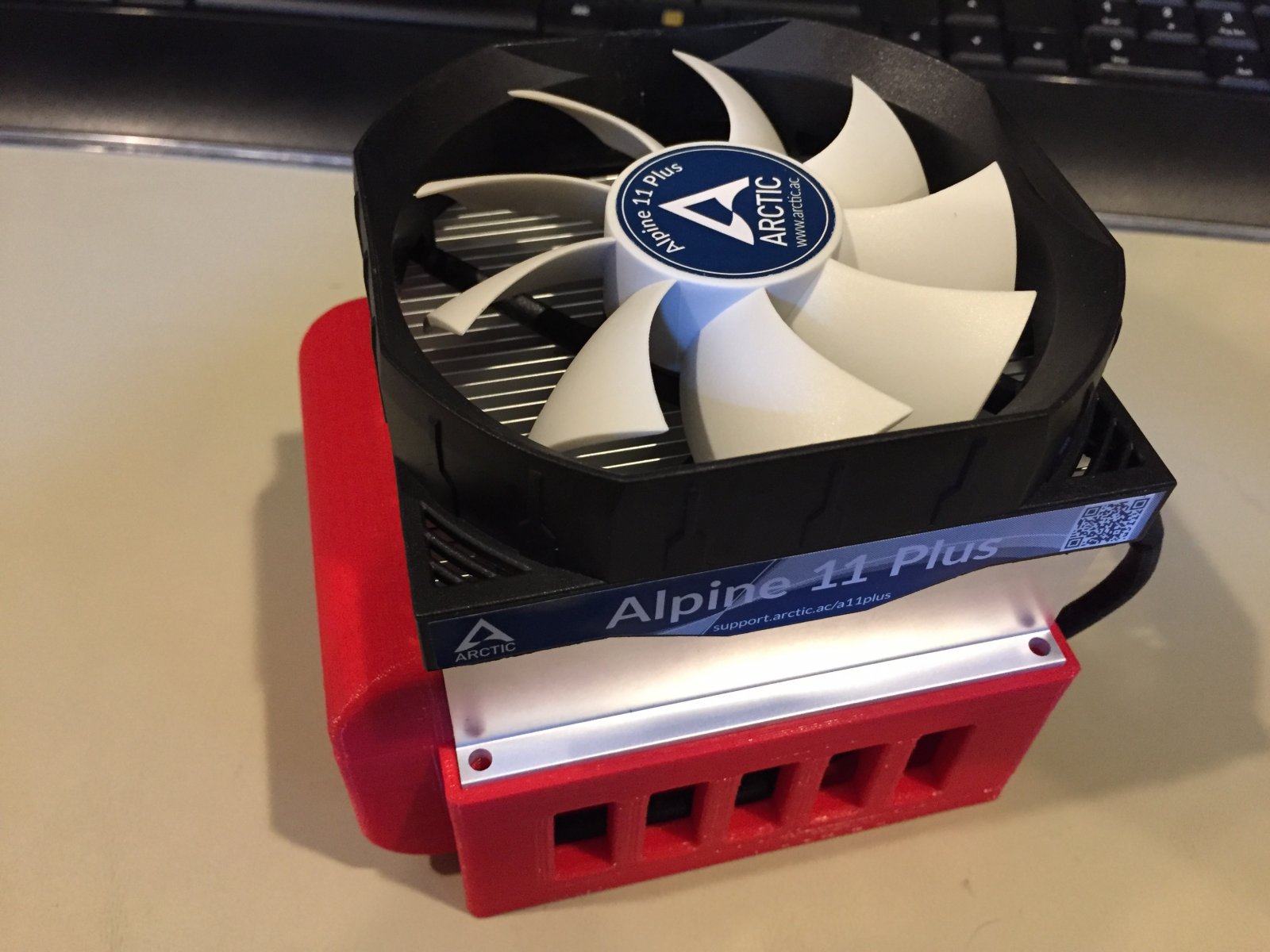

    @kanuk - My JRKs stay nice and cool just using the heatsink/fan assemblies. I’m not sure what you mean by turbo duct fans, but in my rig, pulling the heat out through the bottom of the circuit boards with a good thermal pad into the heatsink/fan assembly works great. Everything stays cool at just a few degrees above ambient. I measured the temperature of the H-bridge and it hardly gets warm at all.

    @Zed
    This is the housing I ended up making....
    with a radial turbo fan. Anybody want noise??!! It's hella loud! :D
    but the JRK's are running below ambient now... hehehehe
