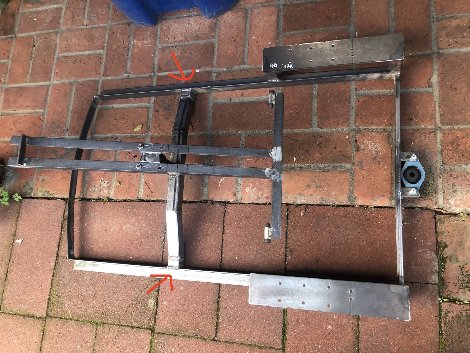

    here is a picture of the original version and then the recent one with the modifications in red. Basically, just made it wider allowing the tie rods to go on the outside of the motor arms rather than on the inside. You can also see the pivot point for the traction and the arch on the rear where I will attach scooter wheels. The final step is to make the platform and 3rd motor mount. I hope to do that by the end of next week

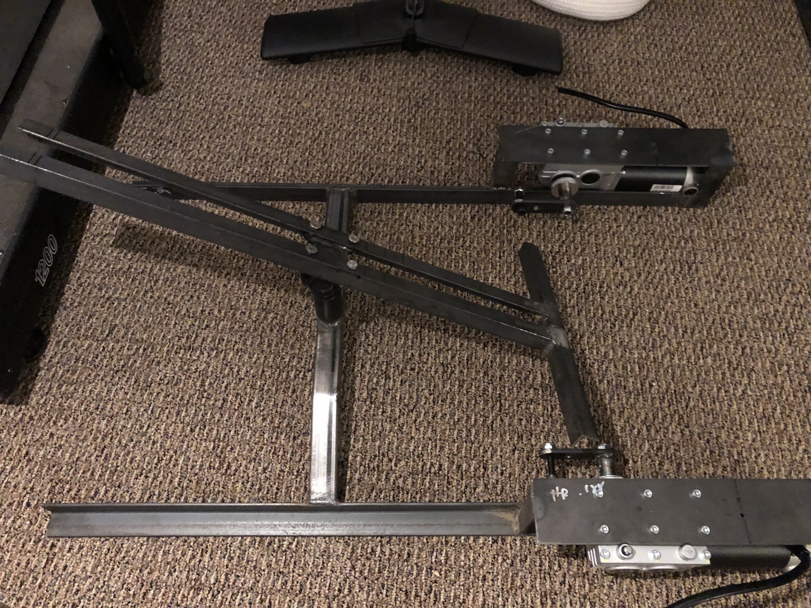

    Just finished welding most of the platform for the 3rd motor and plate for the wheels to roll on. The bar on the left side is where I plan to put dolly wheels and arms to support the monitor and pc. I am eager to fully finish it but it takes time. At least I can play with it now, I most say learning to drive a sim is quite different and difficult. I keep spinning and missing the apex every turn lol platform.jpg

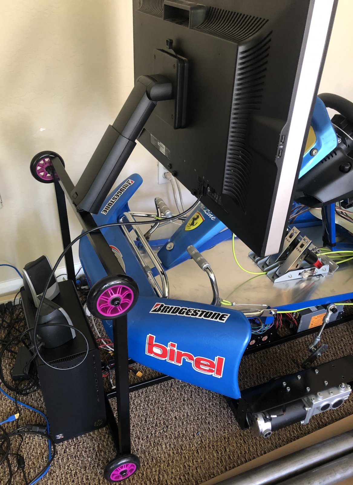

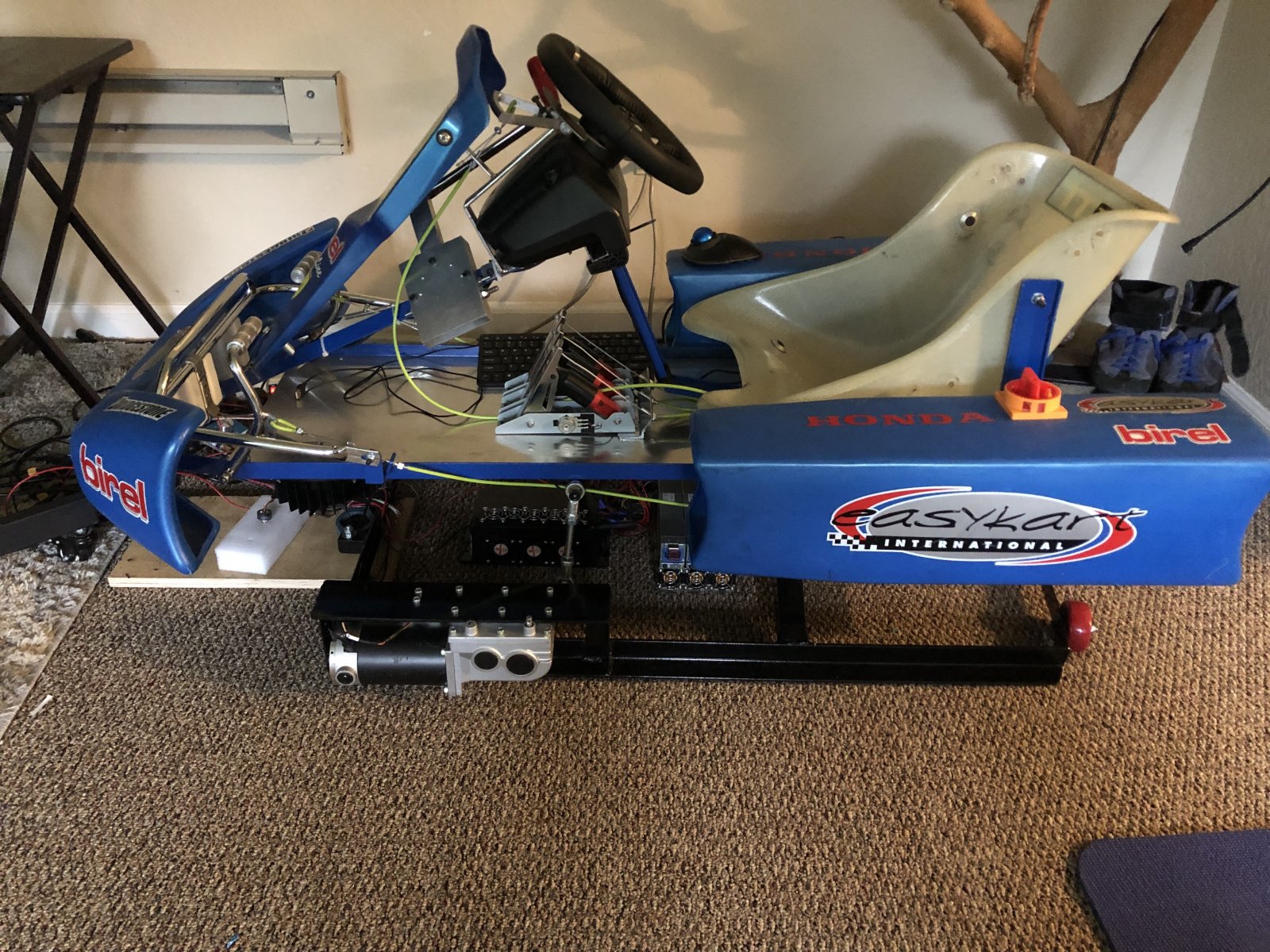

    Very happy this morning, traction loss.jpg I didn't get much sleep last night lol but finally here is the traction loss fully assembled
