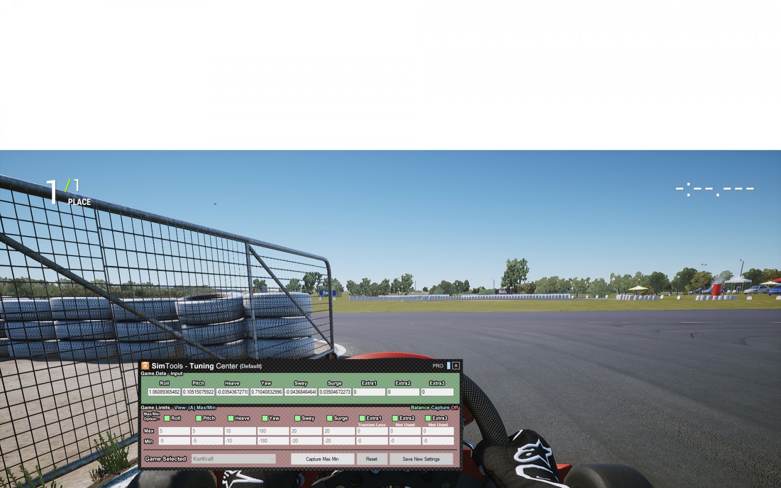

    My problem is that all the values stay equals to 0 when the game is running. The plugin is whell detected and the status is ok in simtools.
    I just replaced the old file by the new file.
    I will try to remove all files from simtools folder and repatch.
    Thank you for your answers

    Yes all values equal to 0 in the tuning center. No reaction.

    @Kranky Pantz
    Thanks you. I delete all files in simtools from appdata folder, I re-patch and everything works perfectly.
    Many thanks @yobuddy too.

    Me too, I've no movement.
    The only version I installed is the last plugin , I use Simtools v2.4, in game telemetry is on, the plugin is whell detected and the status is ok in simtools, patch is ok, but all values equal to 0 in the tuning center .
    As Tifred, I delete all files in simtools from appdata folder, I re-patch but no reaction :(
