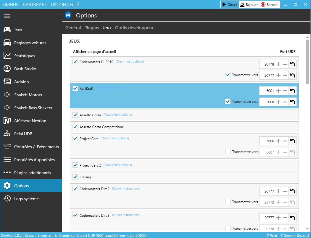

    Hi, SUPER it's amazing :D
    My simu is OK at the same time with Simhub.
    (French) Si cela peut en aider certains, voici comme procéder pour faire fonctionner Simtools et Simhub en même temps pour Kartkraft (donc avec d'autres logiciels, cela doit ressembler).
    Dans Simhub, aller dans le menu "options" puis "jeux", sélectionner le jeu Kartkraft puis cocher "Transmettre vers...", modifier le port par défaut de "5000" , le mettre à "5001" vers "5000" et le tour est joué ;-).

    (English) If that can help some, here is how to make Simtools and Simhub work at the same time for Kartkraft (so with other software, it should look like).
    In Simhub, go to the menu "options" then "games", select the game Kartkraft then tick "Transmit to ...", change the default port of "5000", set it to "5001" to "5000" and That's it ;-).

    Thanks for the information, I made the change that you describe very well but for it to work you must first put the communication on port 5001 in KARTKRAFT instead of 5000

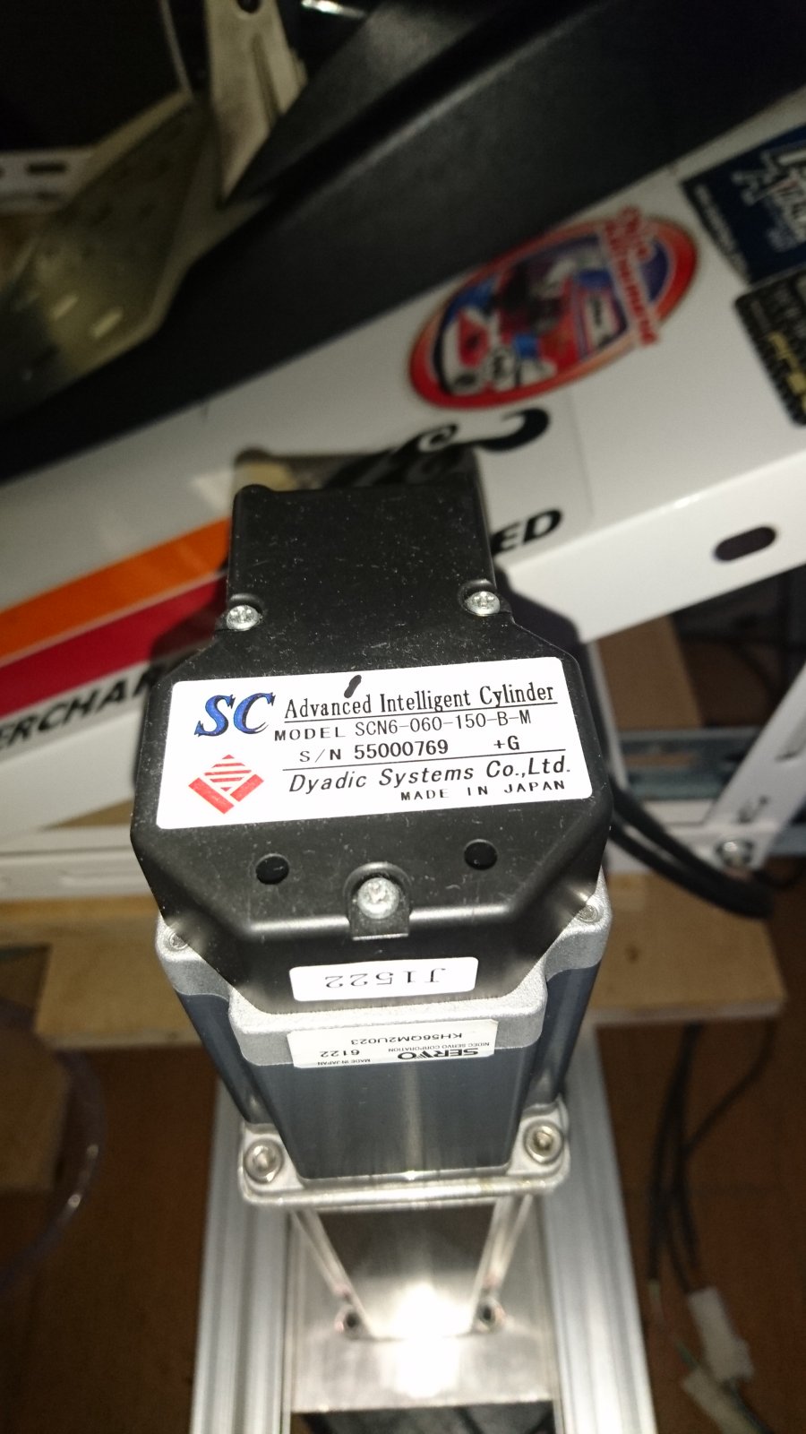

    2DOF, SCN6

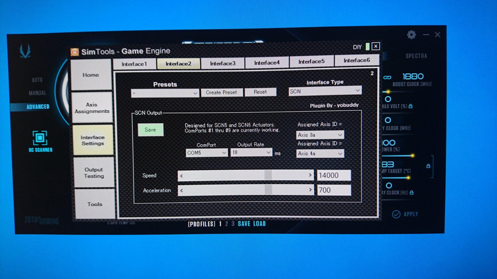

    Hello everyone! When I play a game with simtools2.4 and kratkraft plug-in, the motion shim stops when the lap time starts measuring after passing the control line. What should I do?

    Could you tell me about your setup buddy?
    Are you using hyperaxis?

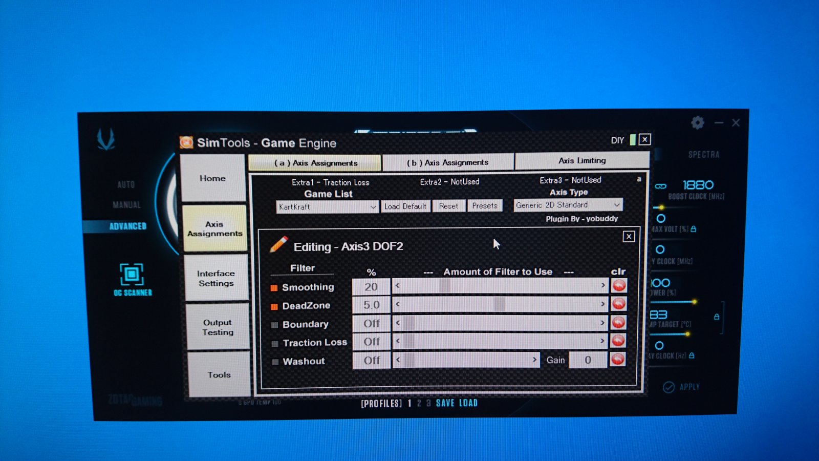

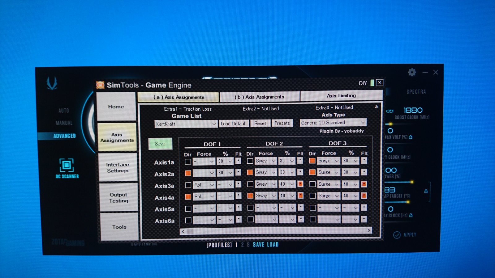

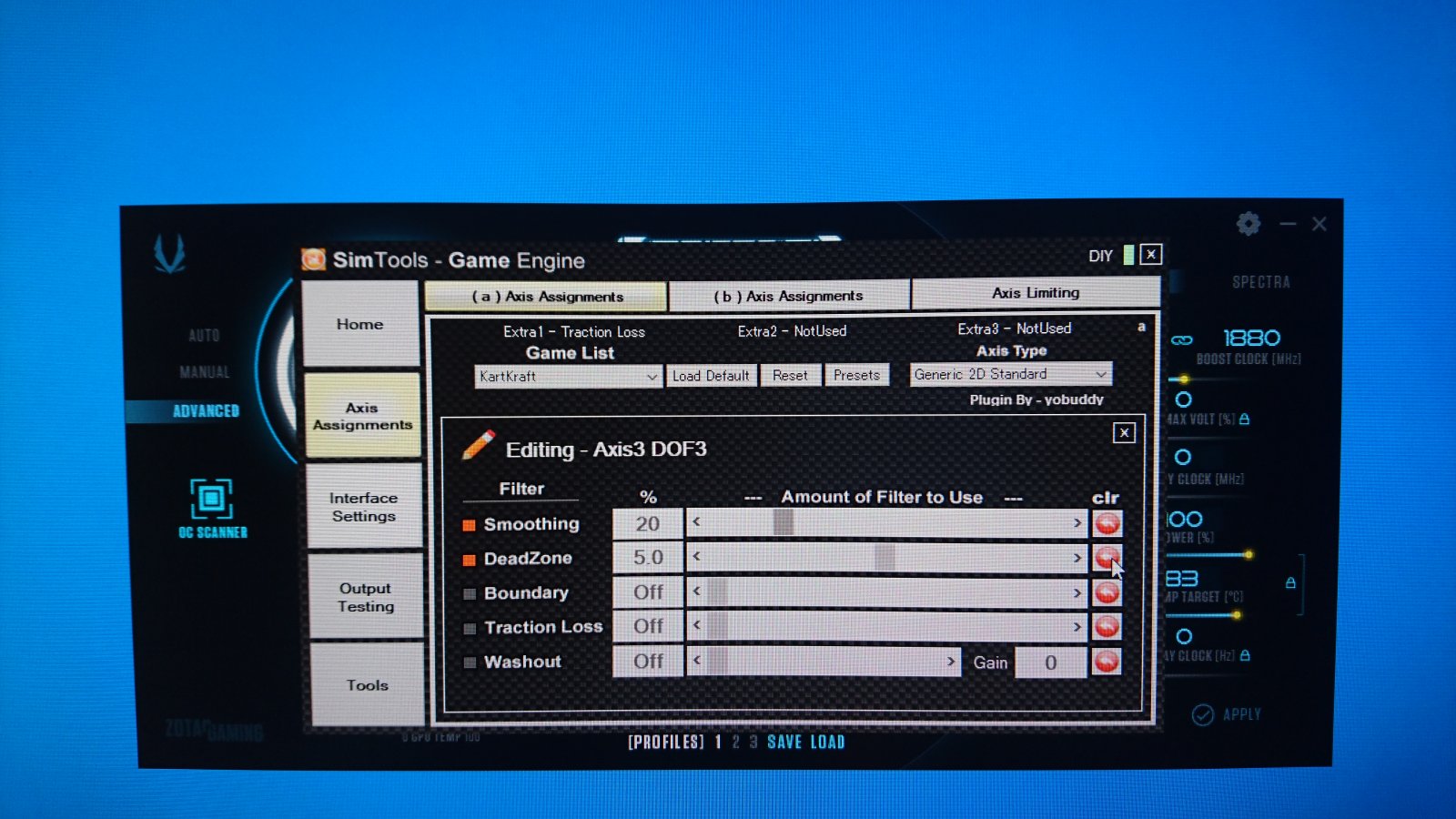

    Cany you please post pictures of all of your settings.
    I am presuming you have created an Axis Assignment profile for KartKraft, patched the game for motion and also captured the Max /Min values in the Tuning Center, but can you please confirm you have done all three of those steps.

    Hello, yes all step… that is my setup… it's correct?
    thanks a lot

    Can't see the pic enough to really see anything.
    But looks like the output in the game is off.

  19. saiRyu
    saiRyu Member Gold Contributor
    Jul 1, 2017
    32
    japan
    271Coins
    2DOF, SCN6
    It is a setting of the game engine of cart craft
