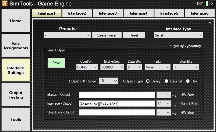

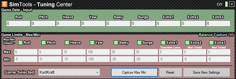

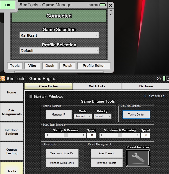

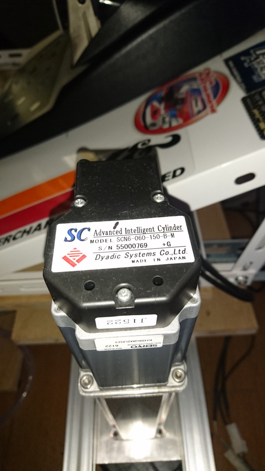

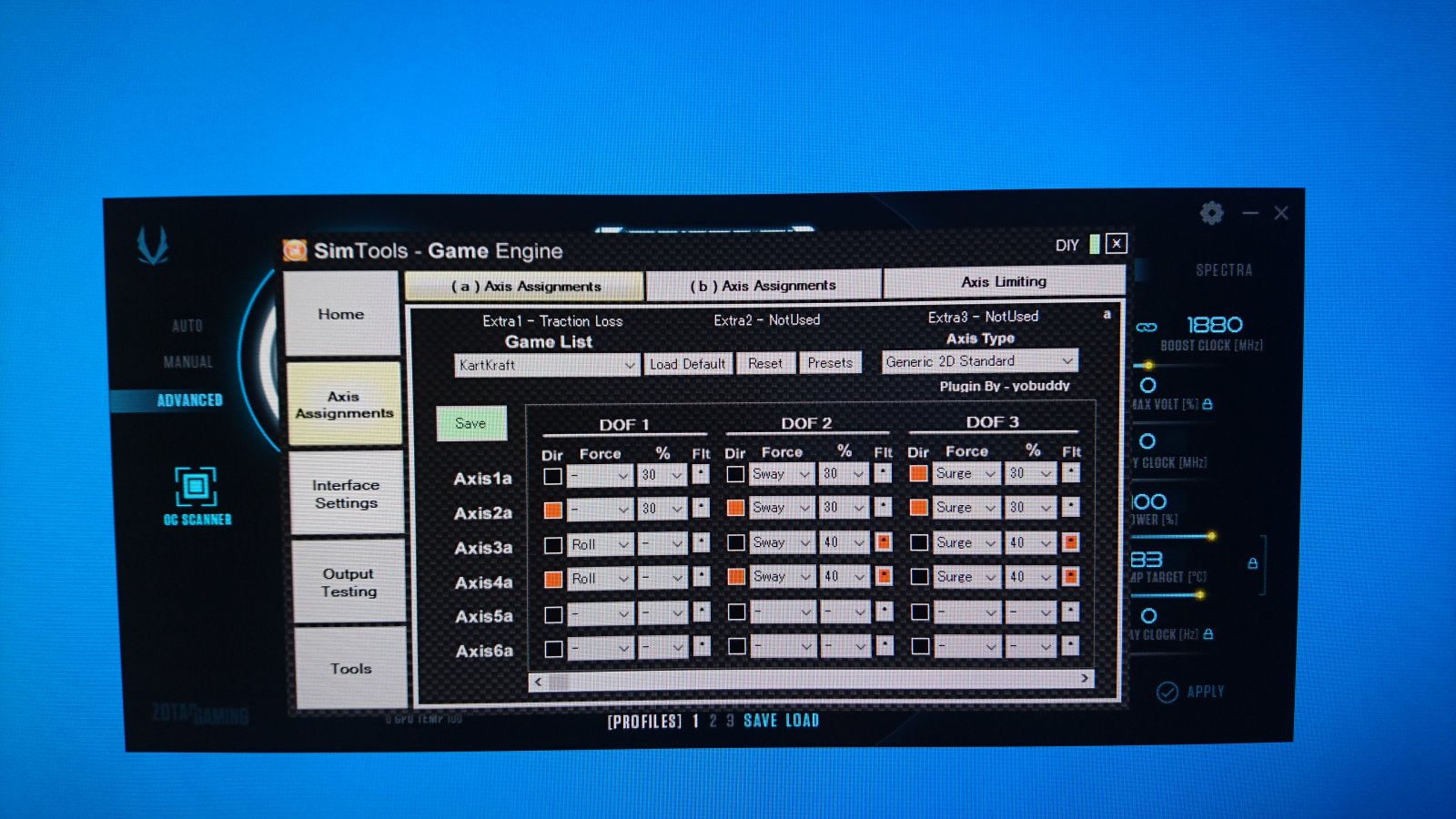

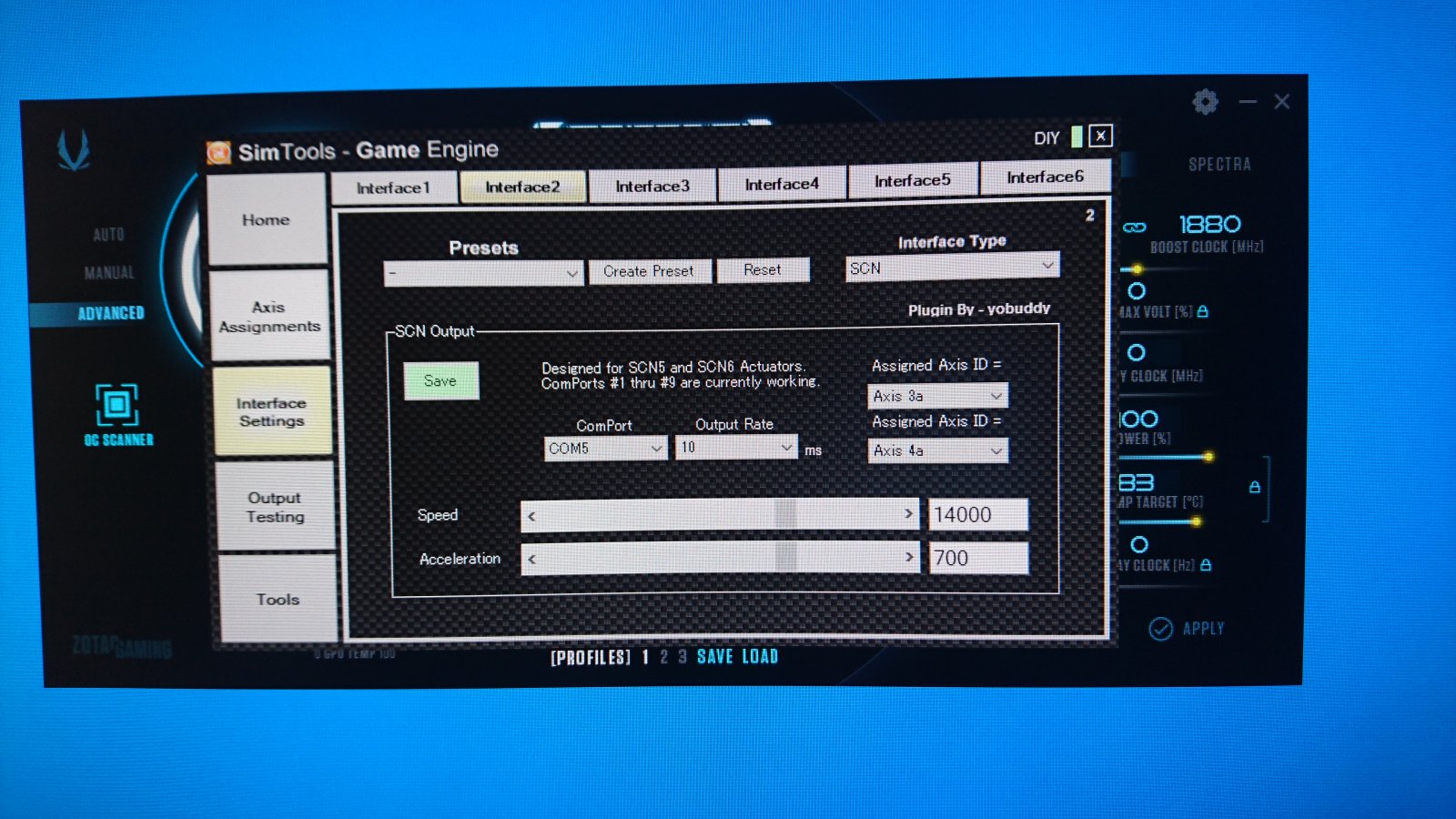

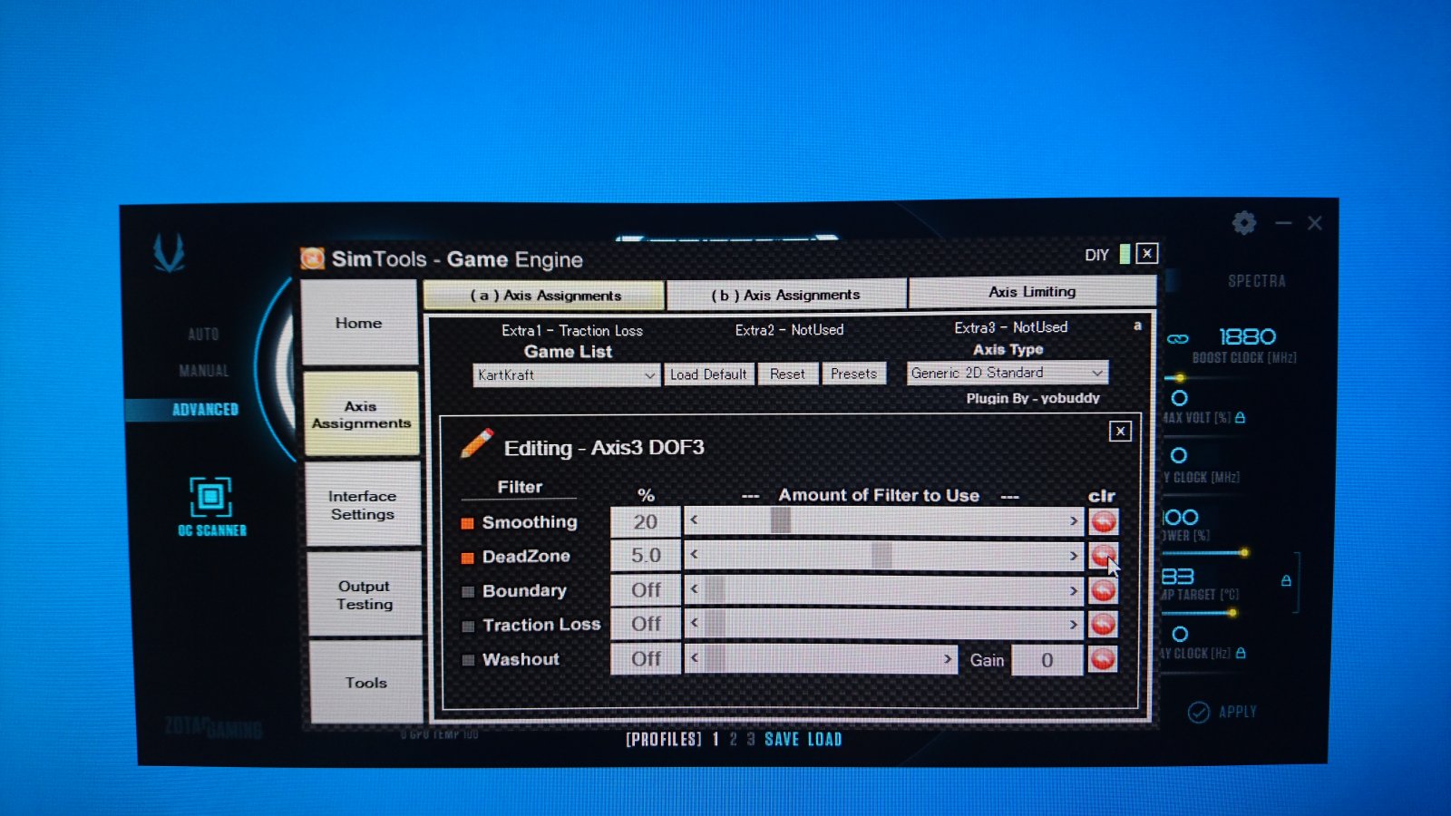

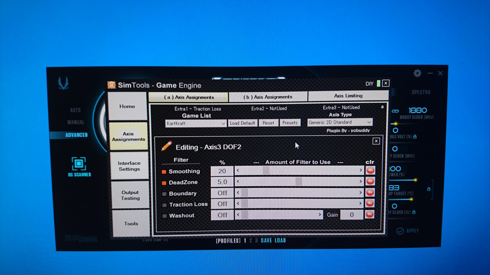

    Good evening
    i post photo of my configuration.

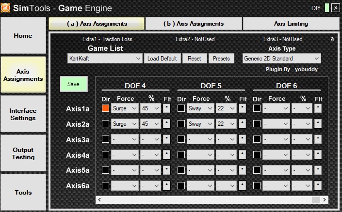

    Hi
    i install plugins , i patch KK , i activate telemetry but nothing in gamedash
    No information on gamedash screen (no speed and others)
    Do you have an idea ?

    @Kaneda,
    Did you turn GameDash on in Game Manger?

    Hi, i have the same problem. i installed the plugin, patched it but nothing move in tuning center. My game is install on other hdd. Perhaps it 's the problem with the patch action ?

    not having much luck with this plugin
    the sim jumps to attention when i launch the gamr but no motion
    I have tried unpatching and repatching
    LFS and RF2 work perfectly
    any suggestions greatly appreciated

    Is data in the top row of the Tuning Center while the game is running?
    It may be a case of being patient until @yobuddy has some free time to take a look at the plugin.
  16. fastvinnie
    fastvinnie New Member
    Mar 1, 2020
    14
    healthcare
    Amsterdam
    47Coins
    4DOF
    There is no data in the top row of the tuning Centre.
