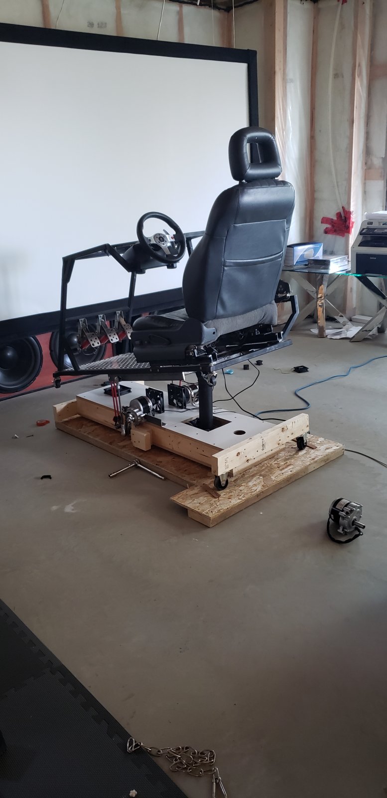

Keith's 2dof rig
Discussion in 'DIY Motion Simulator Projects' started by Keith, Mar 4, 2020.
  1. noorbeast
    22,184
    154,726Coins
    +11,194 / 57 / -2
    Looking good :thumbs
    Can't be sure because of the angle but you could perhaps add a bit more sway.

    I will try adding more sway and see how it feels. I am also going to try adding some springs to the platform to see if I get rid of some of the backlash.

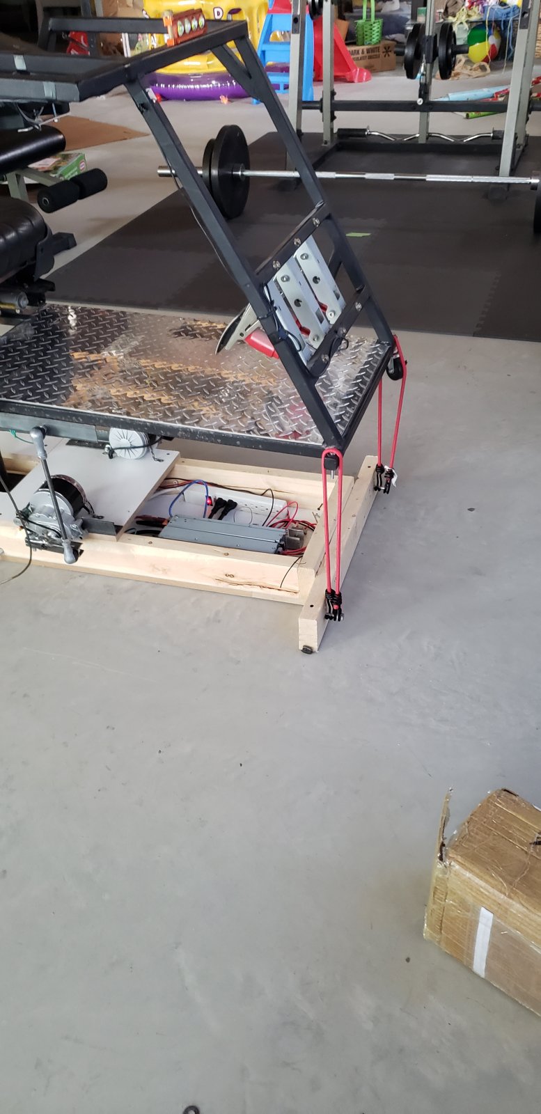

    I installed some bungie's on the front of my platform to eliminate the motor lash. It worked very well. I will try transfering more weight to the front instead of using bungie's and see how that feels.

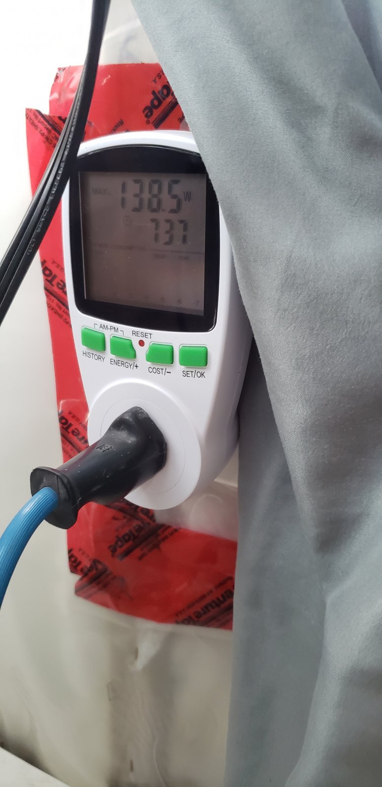

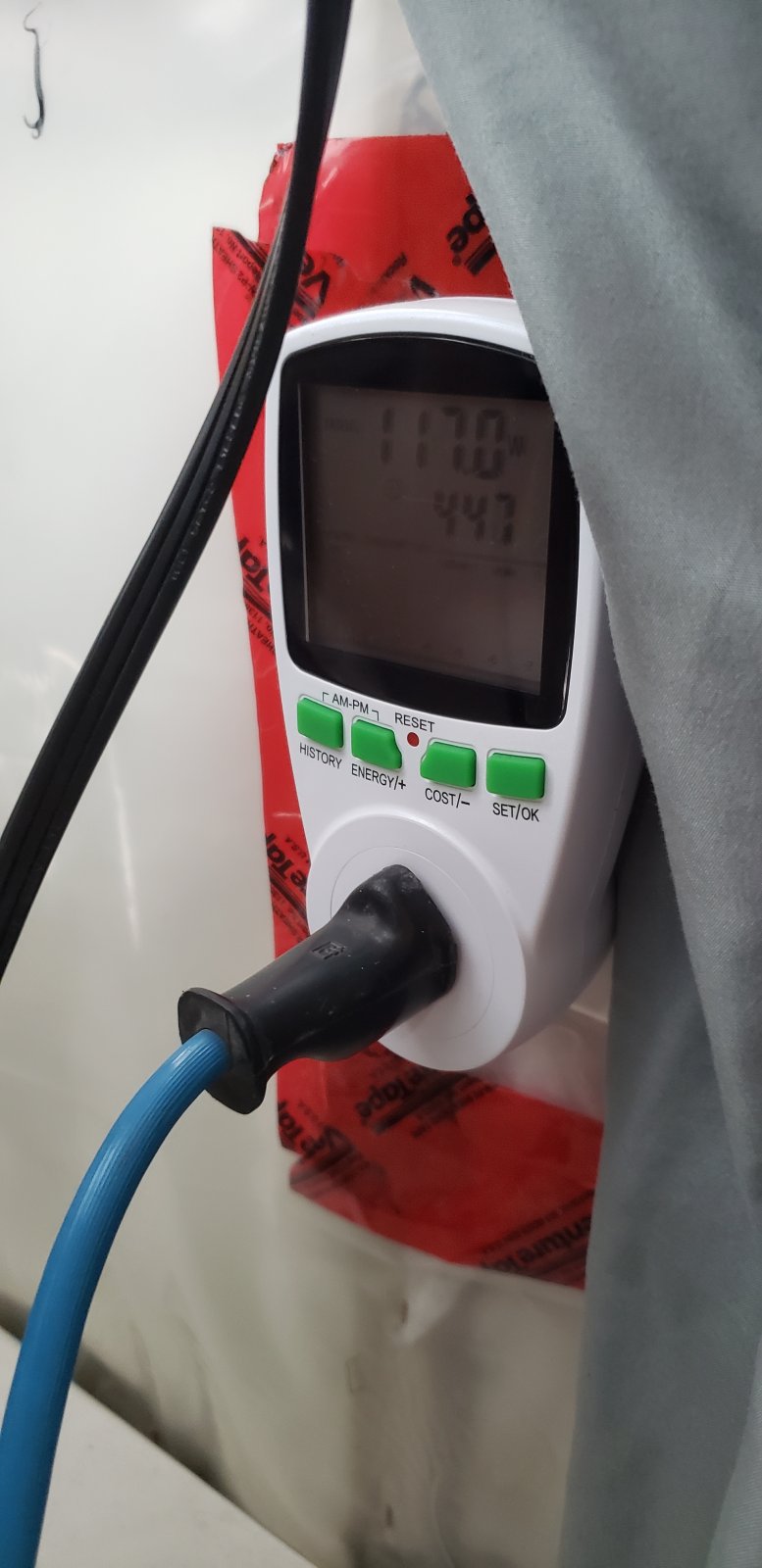

    I did some max wattage testing with and without the bungie cords(drove around the track a few times). First image is without. I was surprised how little power this thing consumes.

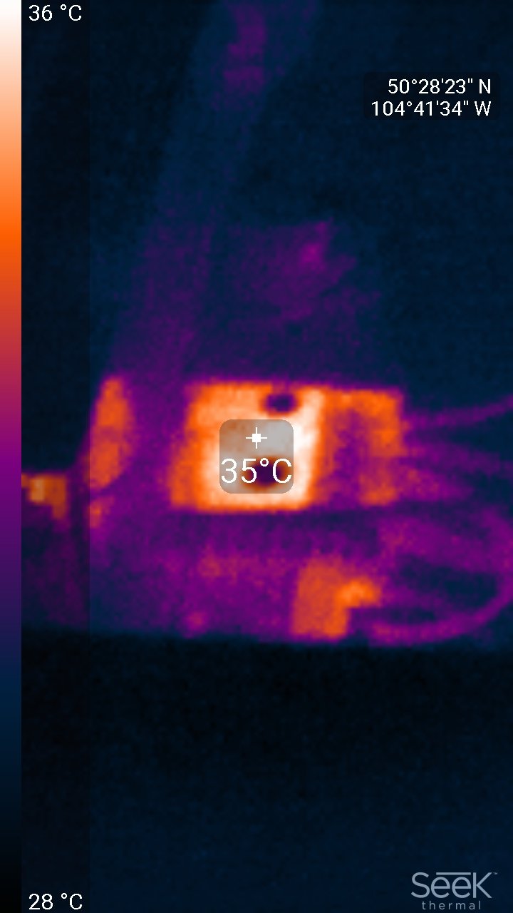

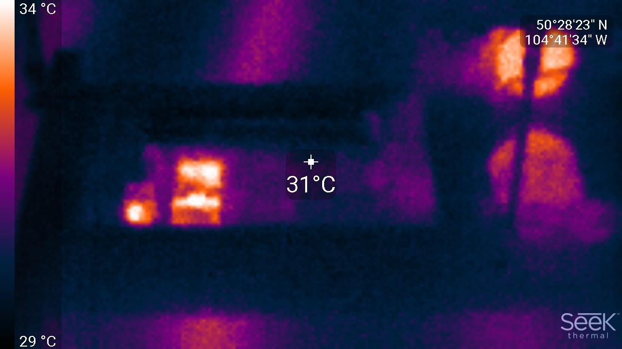

    I took a couple thermal images of my hardware after 10 minutes of driving. Sabertooth 2x32 is the hottest piece. Power supply's are stone cold

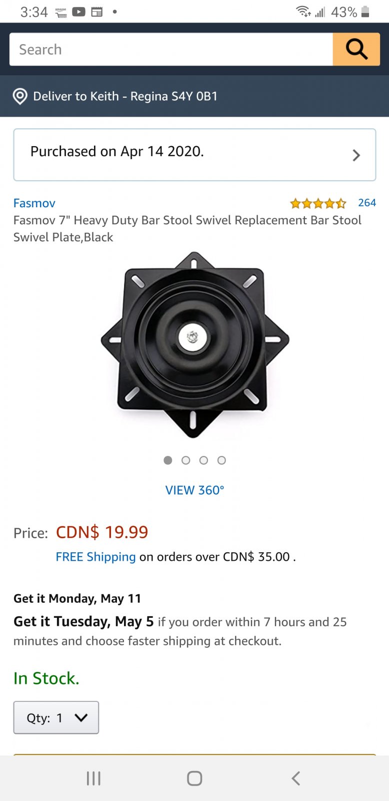

    I started working on the traction loss addition. Here is what I have so far. I also posted a picture of the swivel I used. Still waiting for some parts to arrive 20200502_152529.jpg Screenshot_20200502-153429_Samsung Internet.jpg

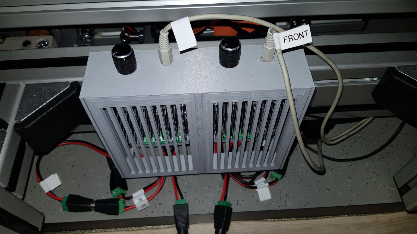

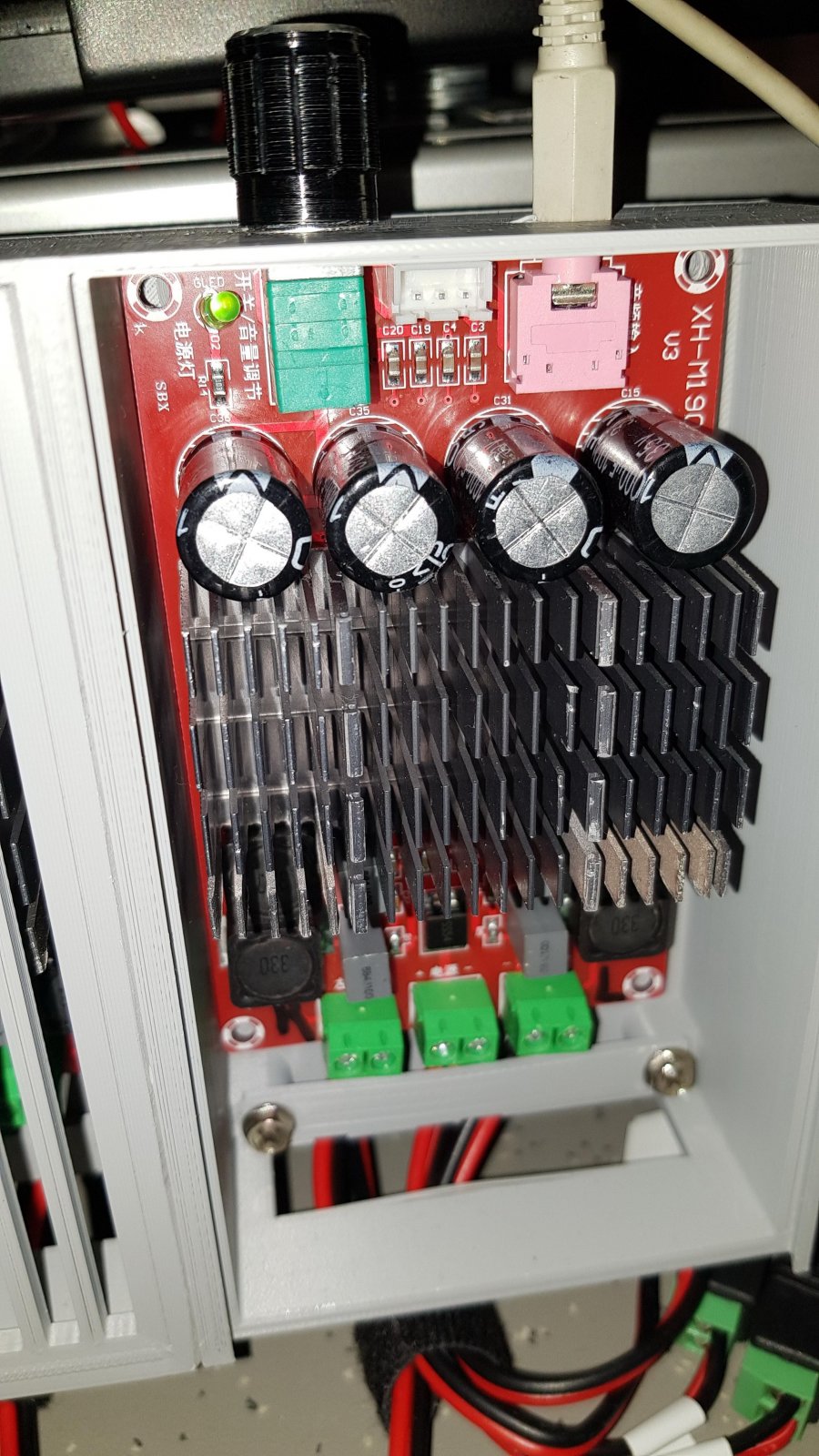

    For audio amplifier I am using two of those https://aliexpress.ru/item/4000861870316.html They are cheap and work great. Buy three just in case if one fails. The are very cheap (5-7€) but the work like a bomb.
    I have only replaced the heat sink with bigger one, so the cooling is better. Have also printed the case.
    For power supply I am using the same output from the power supply that is also powering motion simulator. Bot from the measurement I have done a 24v 10A shoud be enough.

    I have used this amplifier because it is using d class amplifier and have two separated TDA3116D2 chips. Most other have just one.

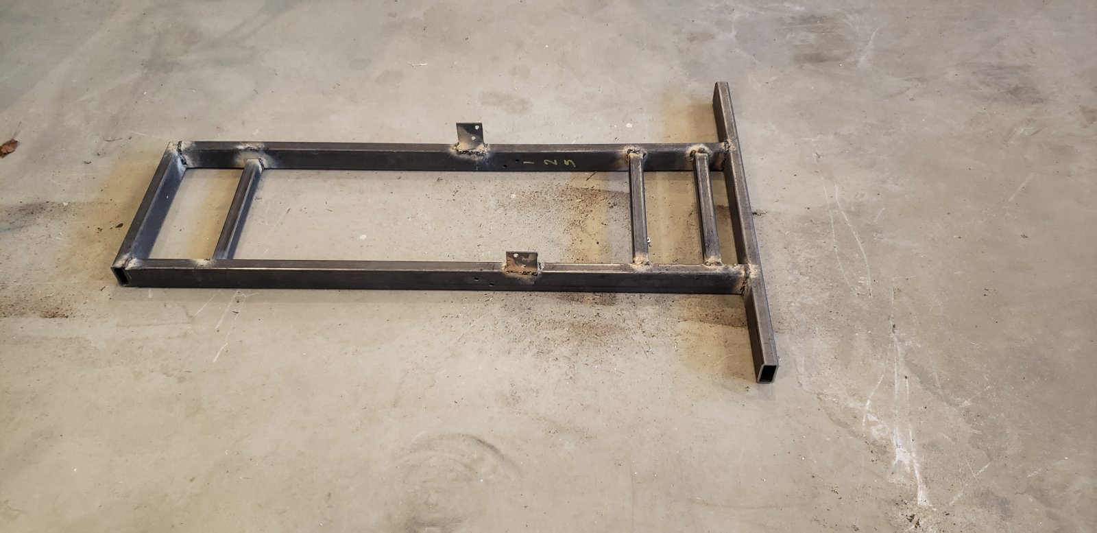

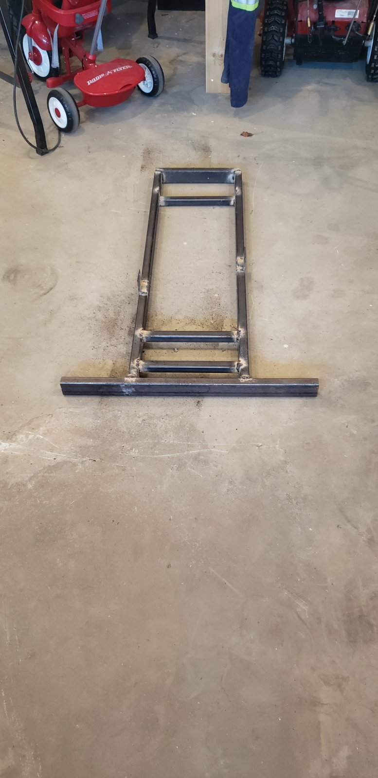

    I have started building a steel frame for the rig. Here is what I have so far.

    For tall metal frame design i really like this one it gives a look of fatter frame since metal frames look slim and make a visual effect of being 'fragile'.
    One thing to consider is to mount the motors behind the seat or. near the seat center. Users achieved better reactions with motors behind the seat and more near the center of the seat mount.

    The distance from the motors to the pivot point is in relation to the length of the CTC and the power and speed of rotation of its motors. The fact that in a project they have achieved better results by bringing the motors closer to the pivot point does not mean that this is a necessity for their project. The closer you place your engines, the more abrupt the movements will be for the same CTC length.
    And it seems to me that the movements are better if the motors are ahead because for example when braking the motor it makes a downward movement instead of an upward movement
