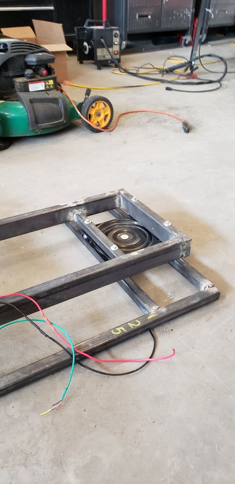

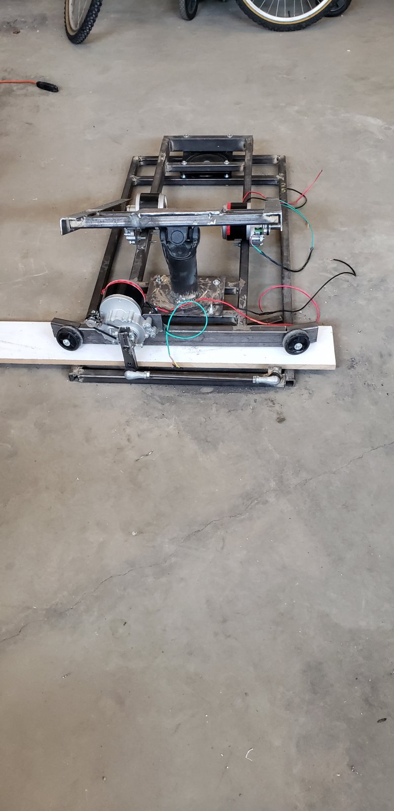

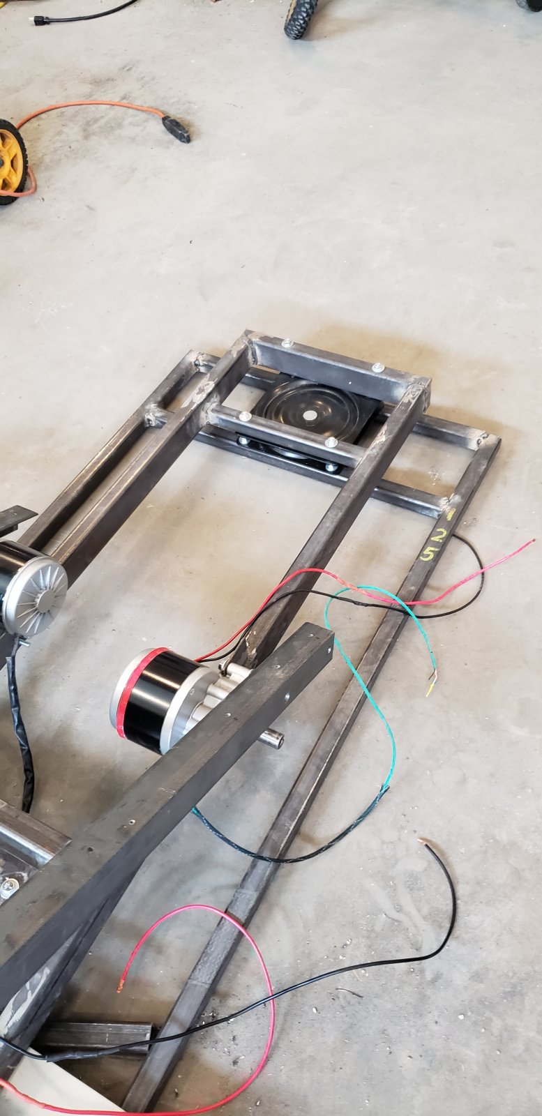

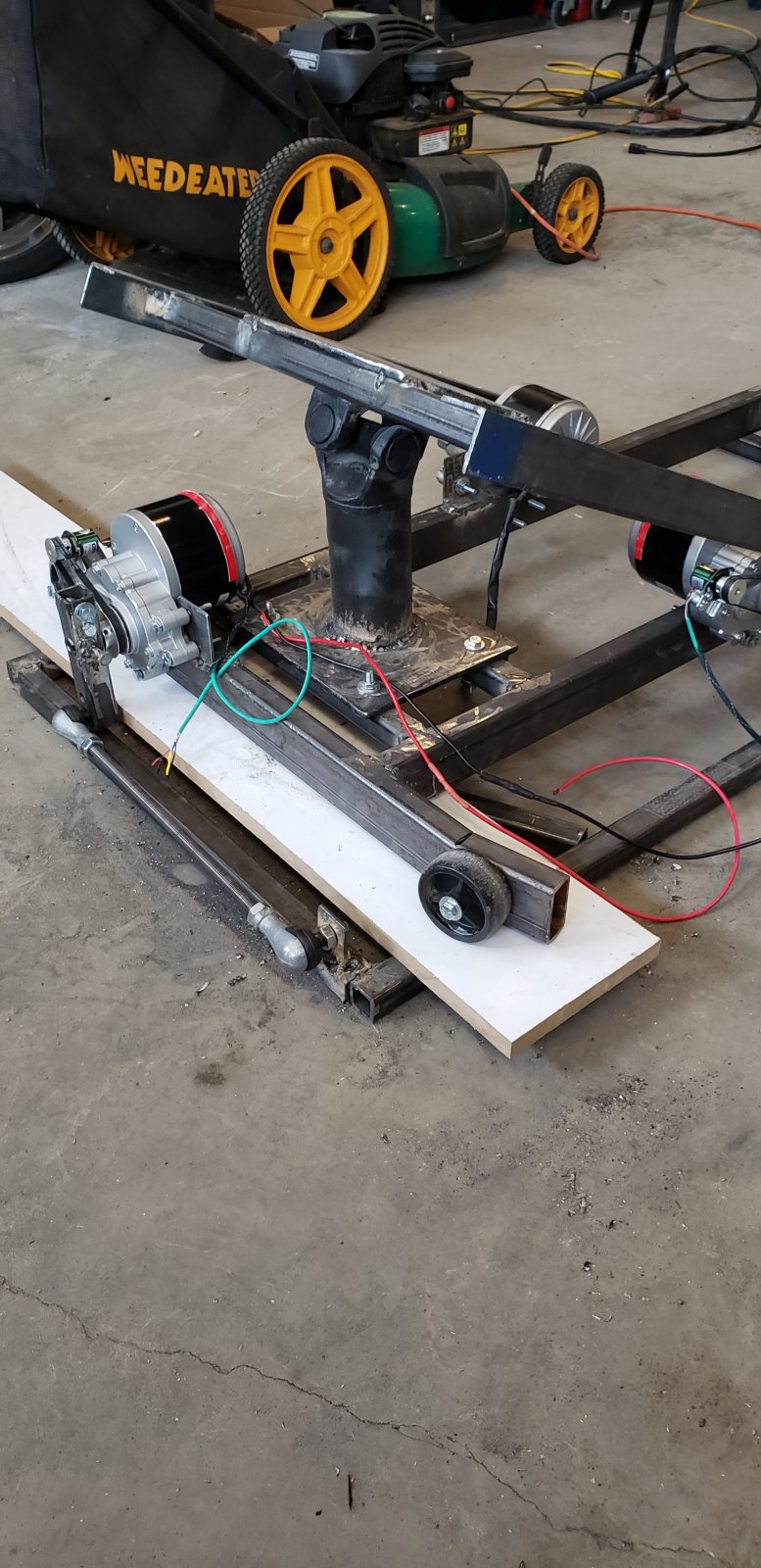

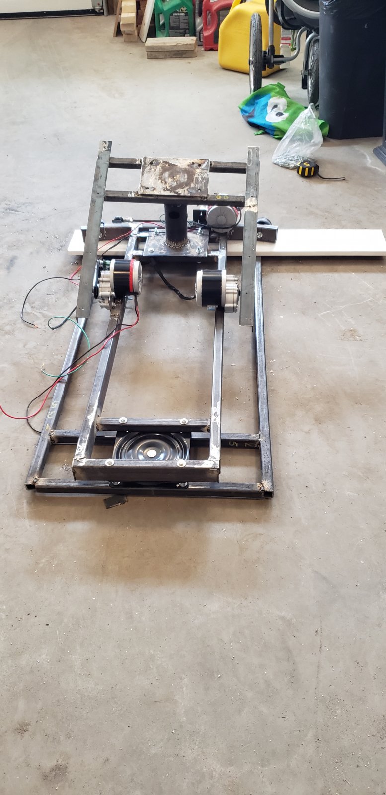

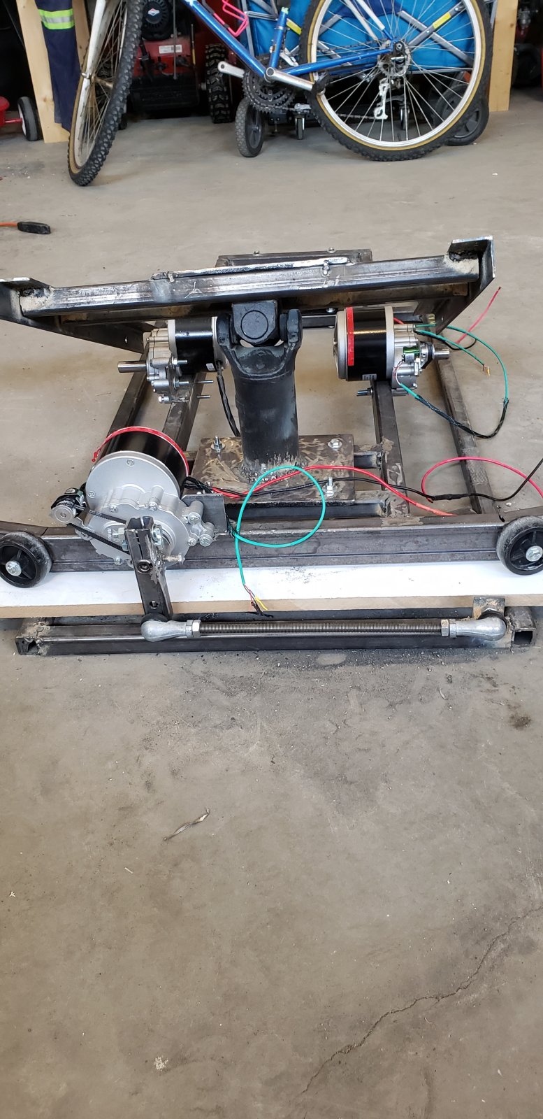

    I made a bit of progress on the frame. Im not real happy with the wheels and how they are mounted but I just need to move on. Let me know if I made any mistakes or if you have a clever idea for me. Thanks! 20200517_145651.jpg 20200517_145646.jpg 20200517_145638.jpg 20200517_145634.jpg 20200517_145626.jpg 20200517_145619.jpg

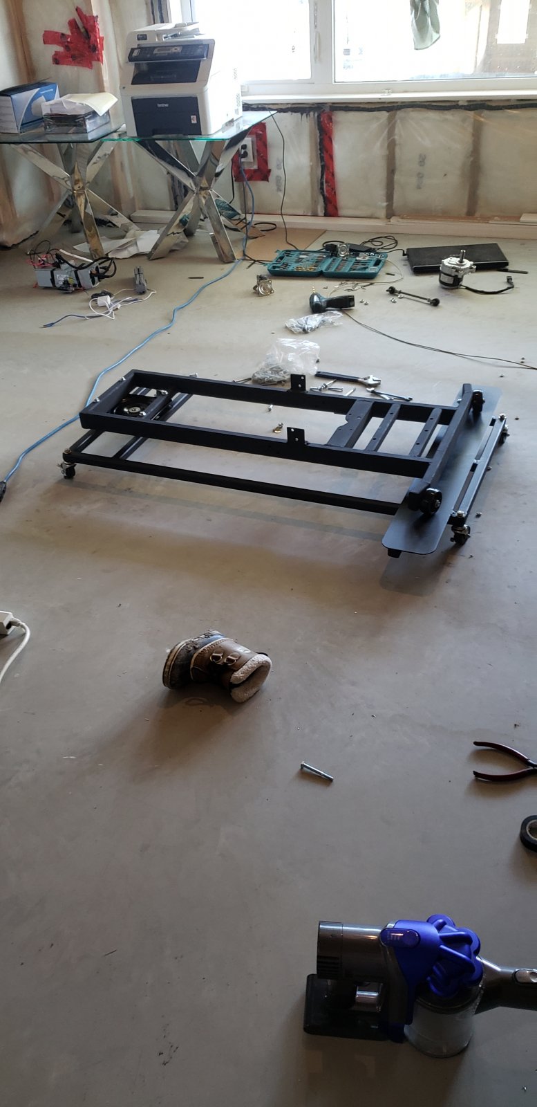

    Great job. I will send you my wheel ideas later on. To stabilise the rig you should have 2 wheels at the front

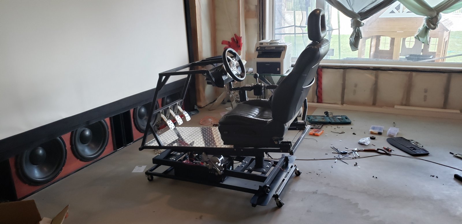

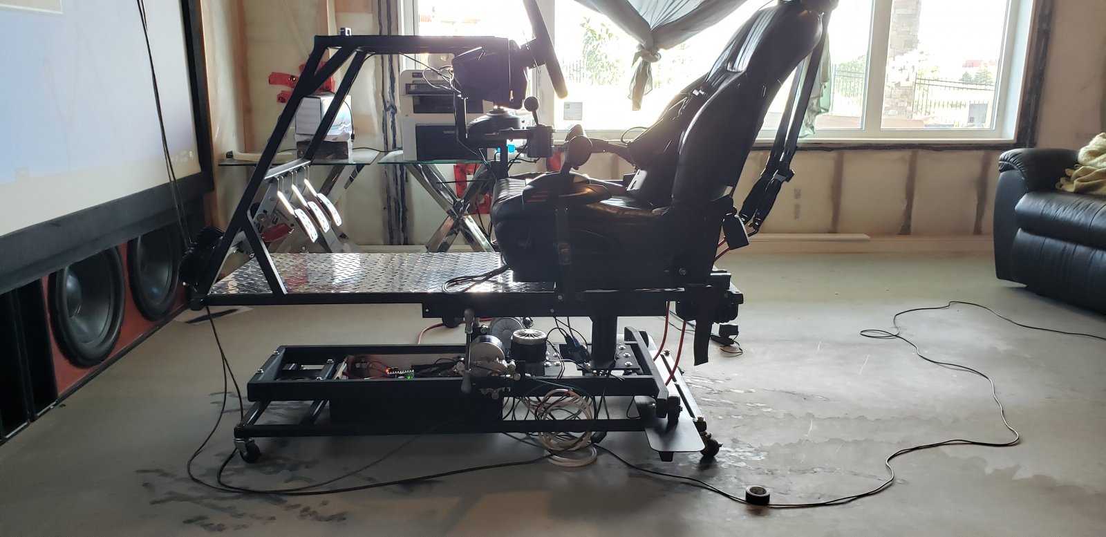

    what seat do you use? is it comfortable?
    I have a bucket seat (SPARCO) and its great only for short period.

    The seat is out of a Pontiac grand prix. Its pretty comfy. Its a power adjustable seat which is cool but the downside is weight. (80 lbs)

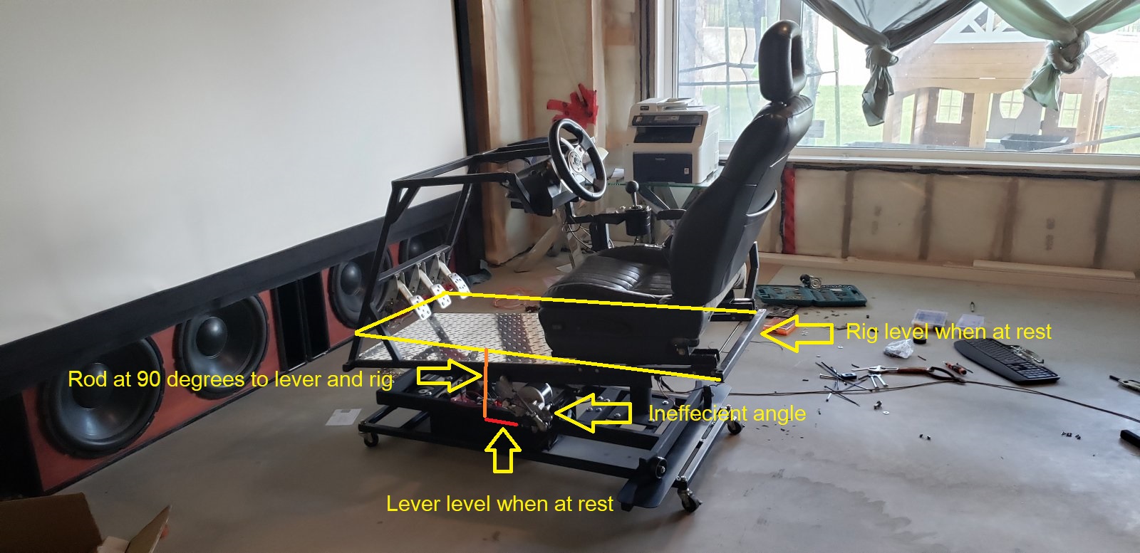

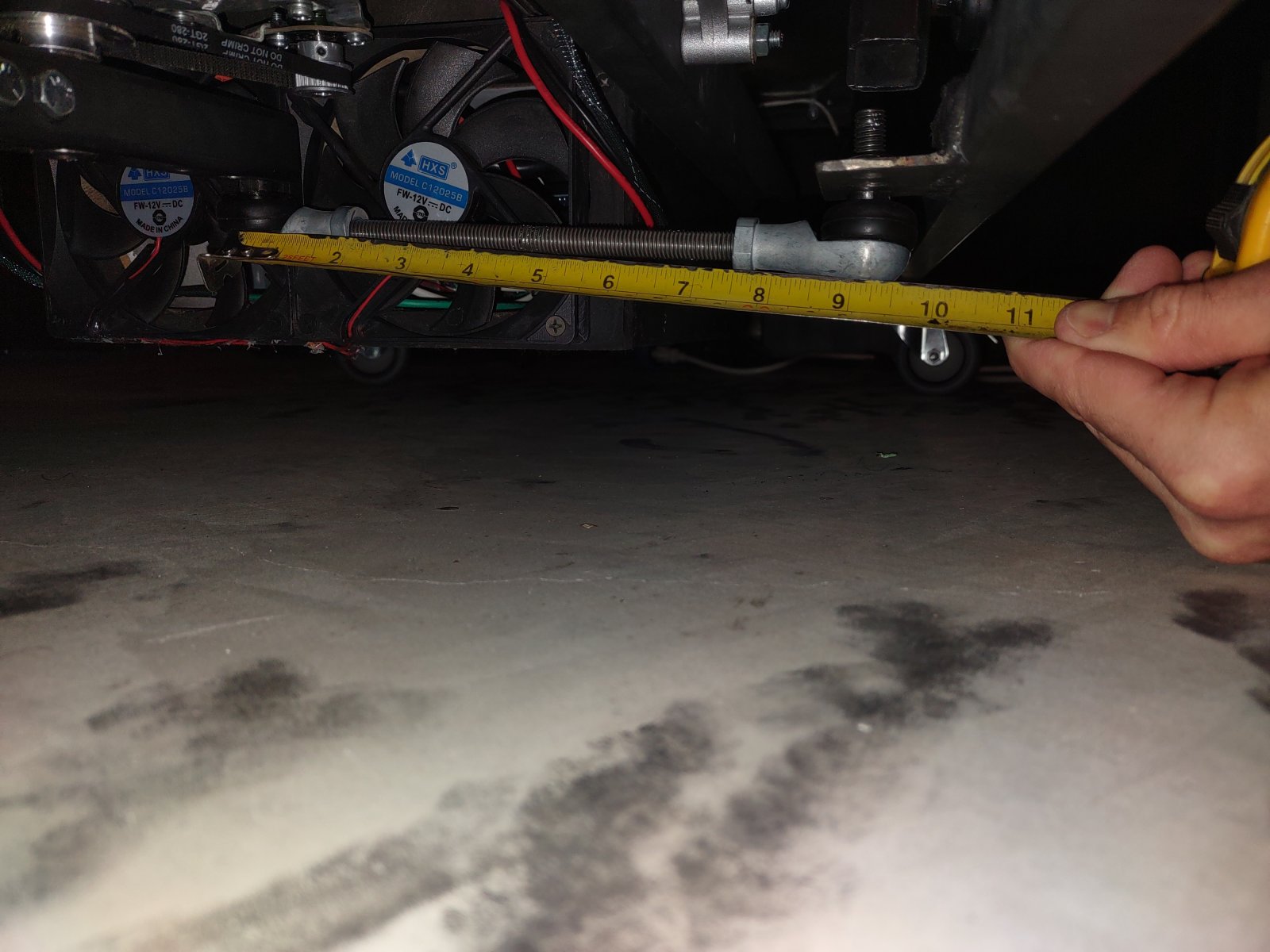

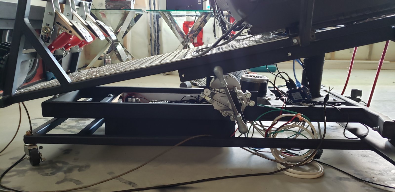

    Hey guys. is there a way to adjust the baseline or the level point of my rig. I physically adjusted the levers and pots downward to avoid the rig from starting the motors up in reverse. now I just want to adjust the level point in the software if that makes sense. Im not sure If I have to reprogram the arduino or make adjustments to simtools. Thanks
    22,020
    153,716Coins
    +11,148 / 57 / -2
    The most effective use of torque is at 90 degrees, anything over 40 degrees either side of that is very inefficient and just puts unnecessary strain on your motors.
    Your rig and base frame should be parallel at rest, as should the motor levers, with the rods at 90 degrees.
    I would suggest fixing the levers and rod mounts as per below and reset the Arduino accordingly.

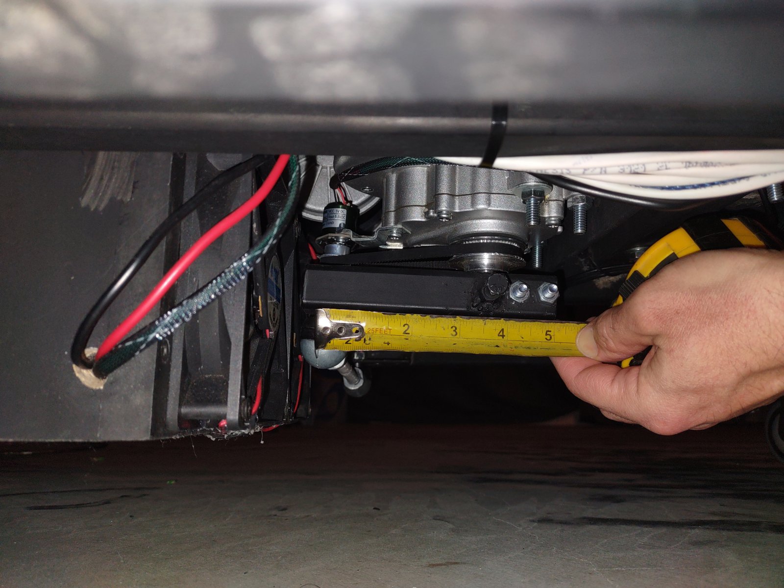

    Thanks for the reply! In that picture the motors have fired up backwards. When the motor spins the correct direction it is at 90 degrees. Basically once I power down the rig it falls down and the motors will fire up in the wrong direction unless I prop up the cockpit. I think I might just replace the gt2 pulleys on the pots with bigger ones so it will have more than 180 degrees of rotation and cant start in the wrong direction.

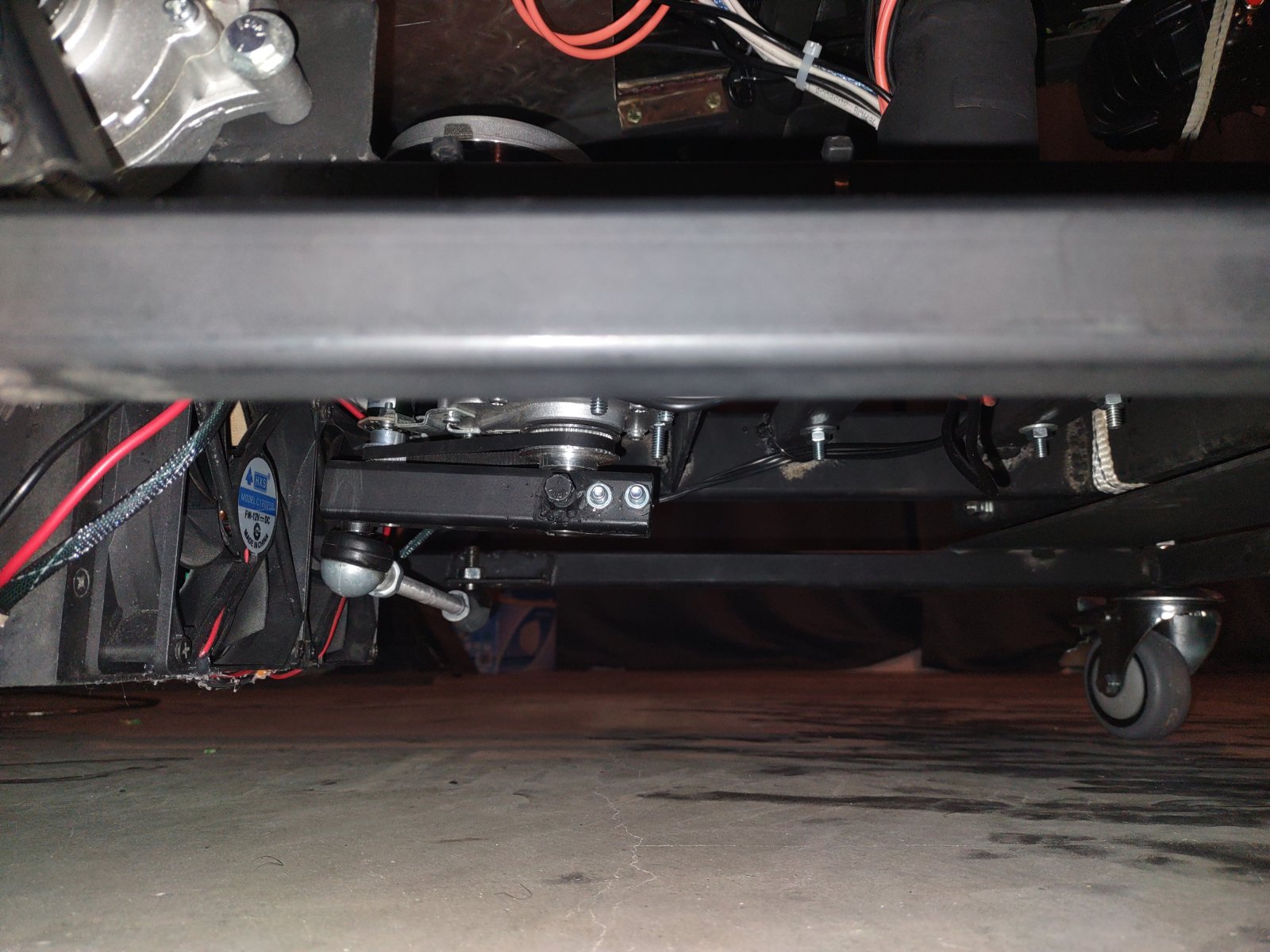

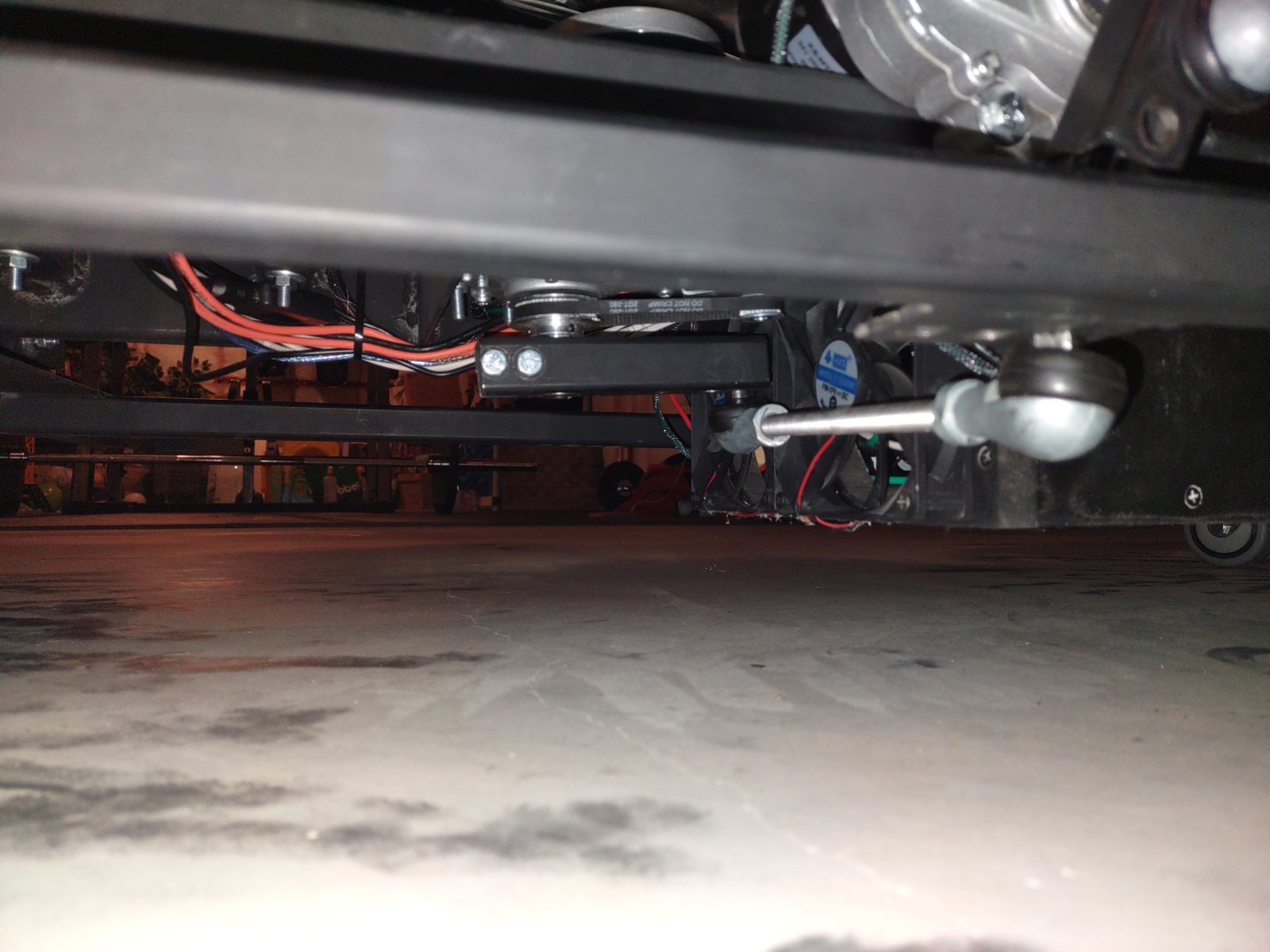

    The first pic is where it rests while powered up correctly. Second pick is powered down. In the second pick you can see the lever swings beyond strait down. That is what is giving me the issue of starting up backwards

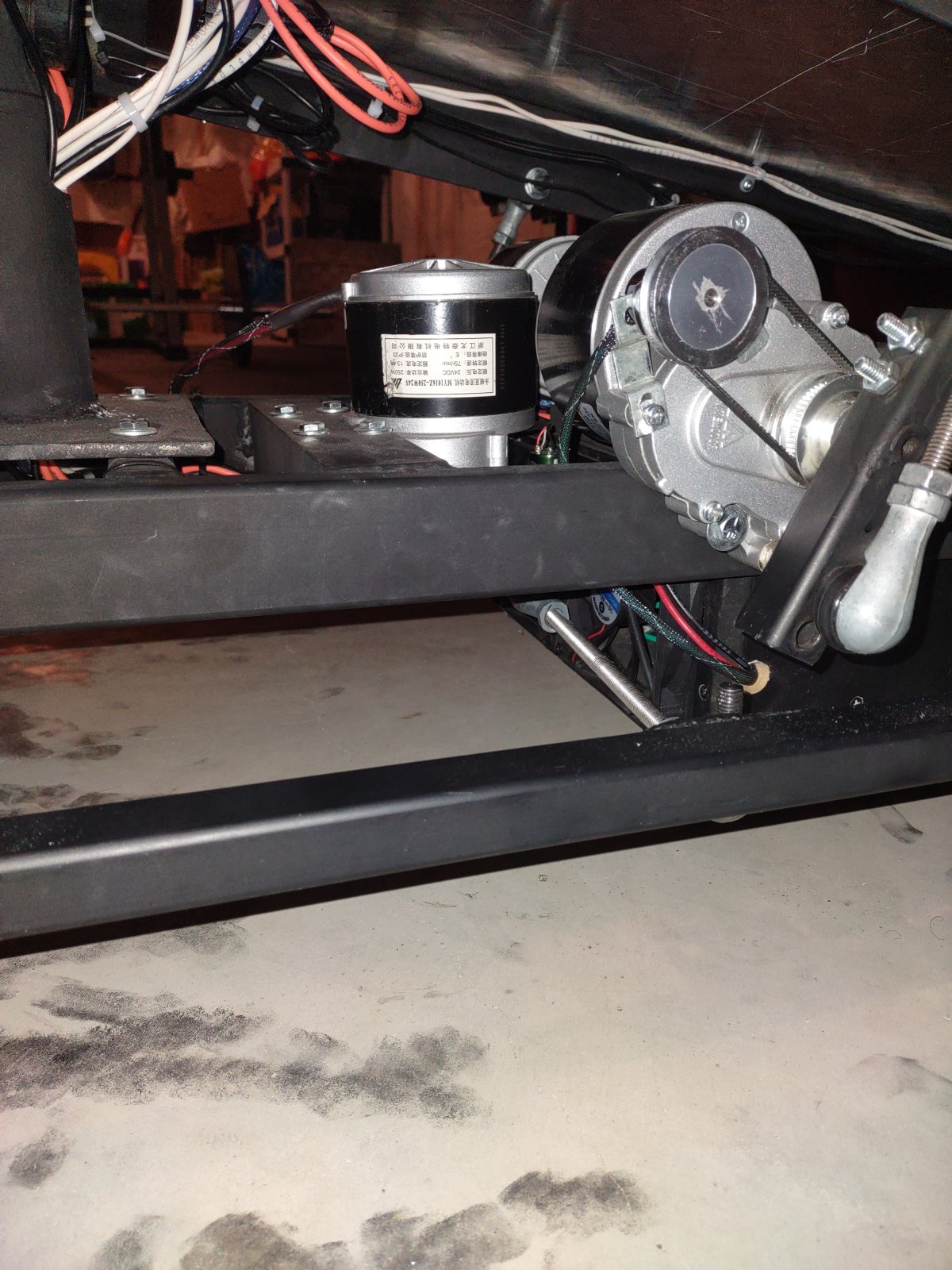

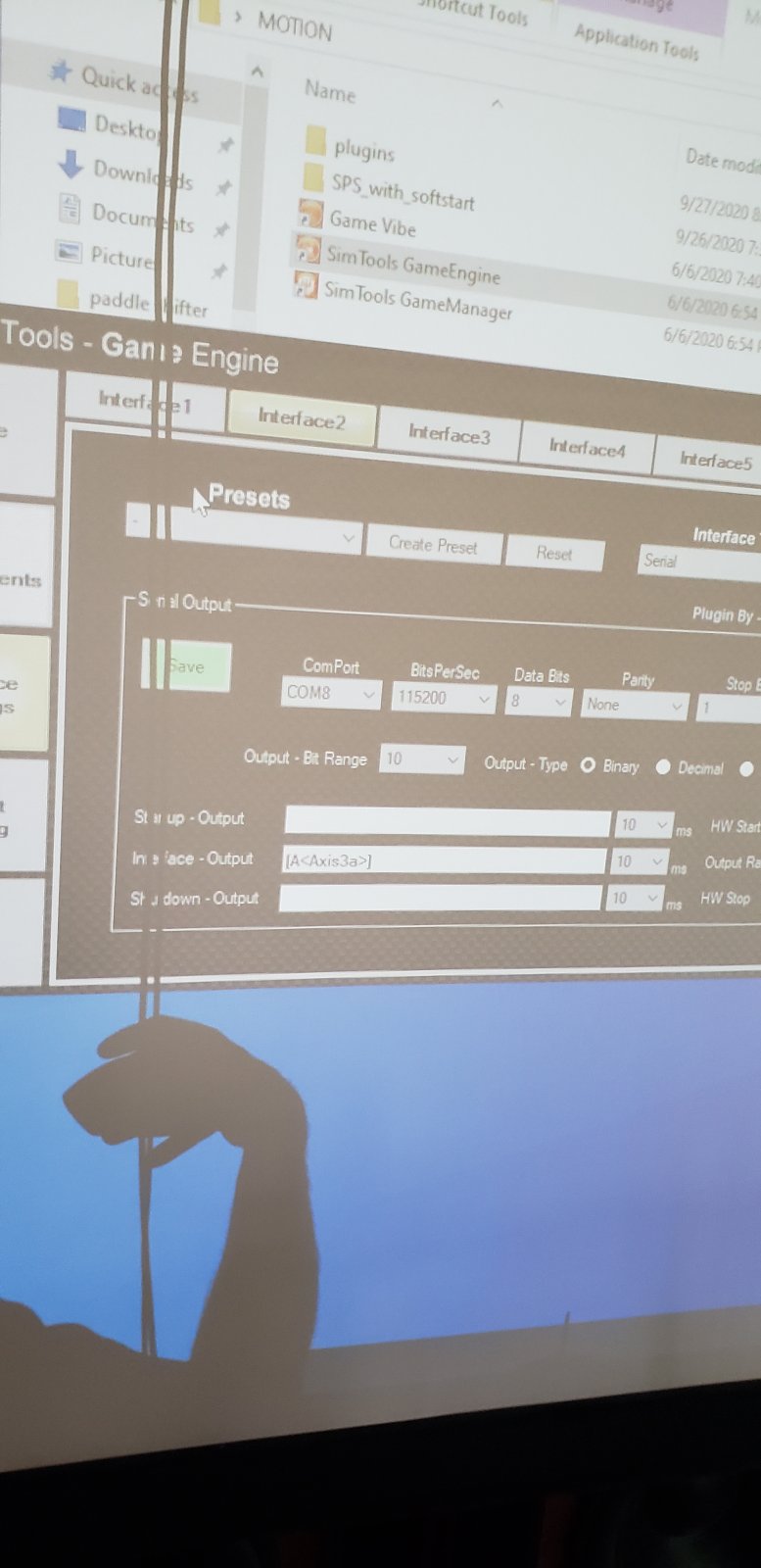

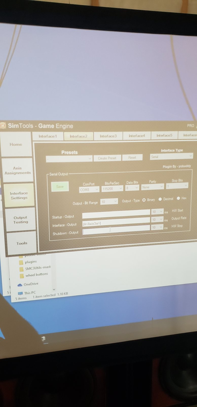

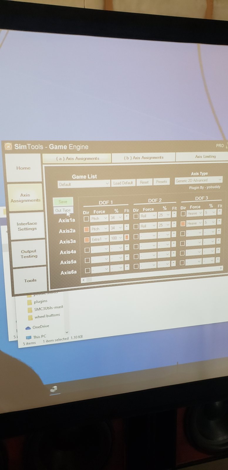

    Hey guys. I am struggling to get my traction loss working. The movement works in SMC3 utility but does not work in simtools. The baud rate is set to 115200 and I shorted #8 to ground on the arduino uno. Here are a couple pics of simtools
  15. Keith
    Keith Active Member
    Jan 21, 2020
    179
    Electrician
    Canada, Saskatchewan
    154Coins
    +83 / 0 / -0
    I figured it out.

    Yes that's the way to do it. The ujoint should be located as close to the top platform as possible. And you just want it placed somewhere so that the top platform is somewhat balanced(with a person seated) I have mine balanced to have extra weight on the front of the rig. This helped to hide the motor lash.
    I will take some pictures of the traction loss tonight

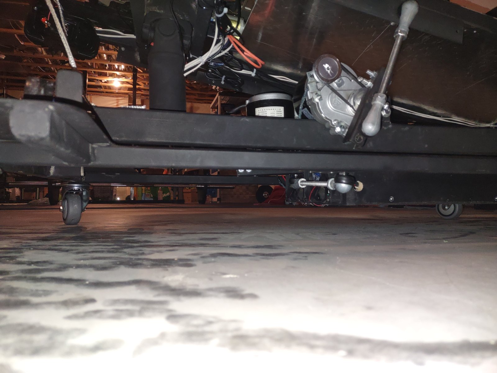

  18. Keith
    Keith Active Member
    Jan 21, 2020
    179
    Electrician
    154Coins
    +83 / 0 / -0

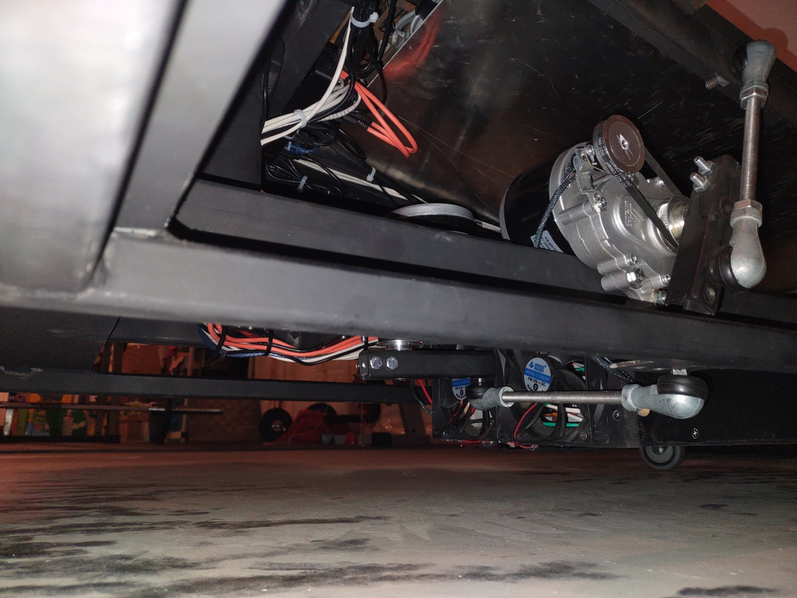

    Here are some pics of the traction loss. Sorry it's hard to get a good pic of it.
