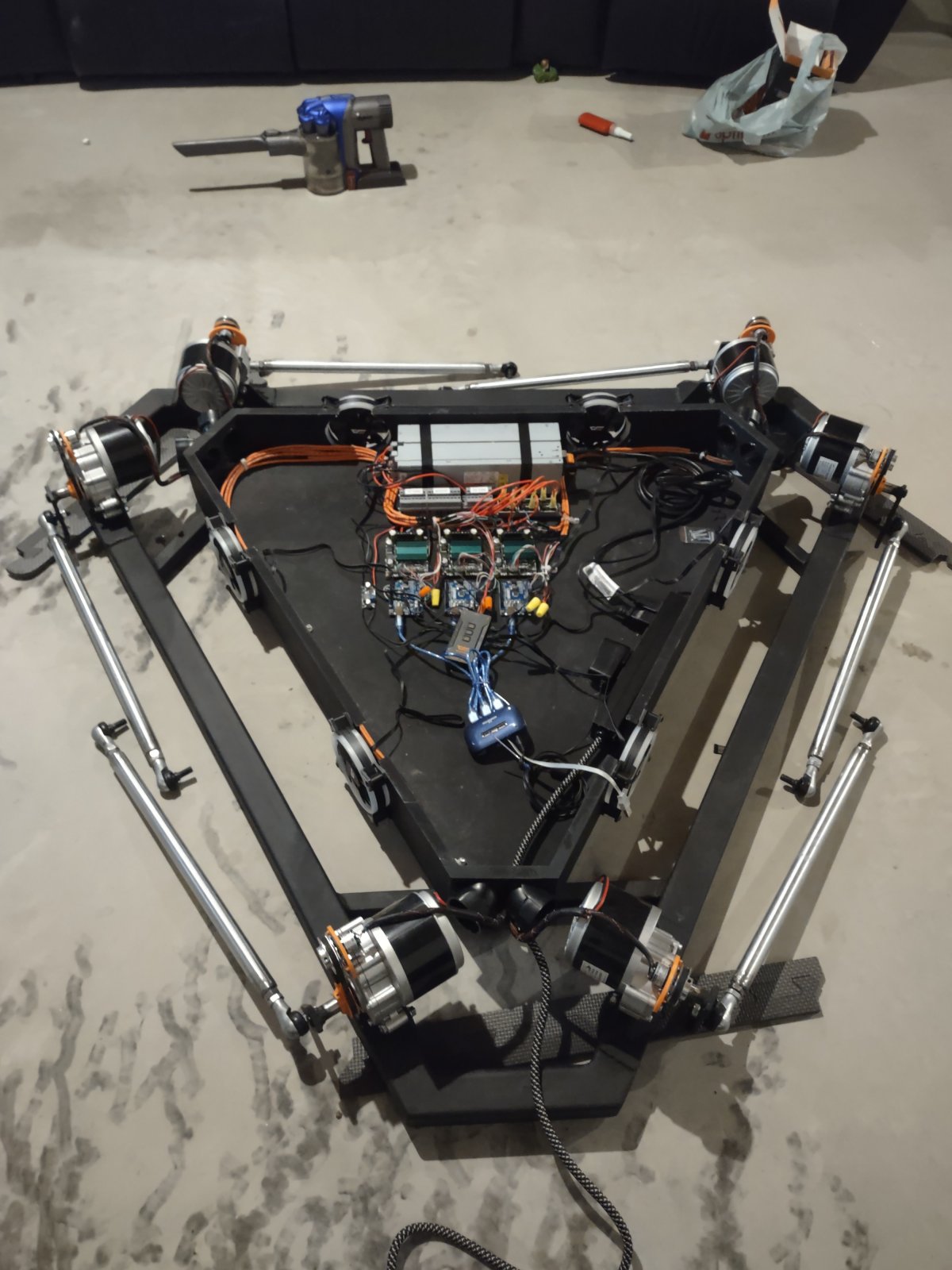

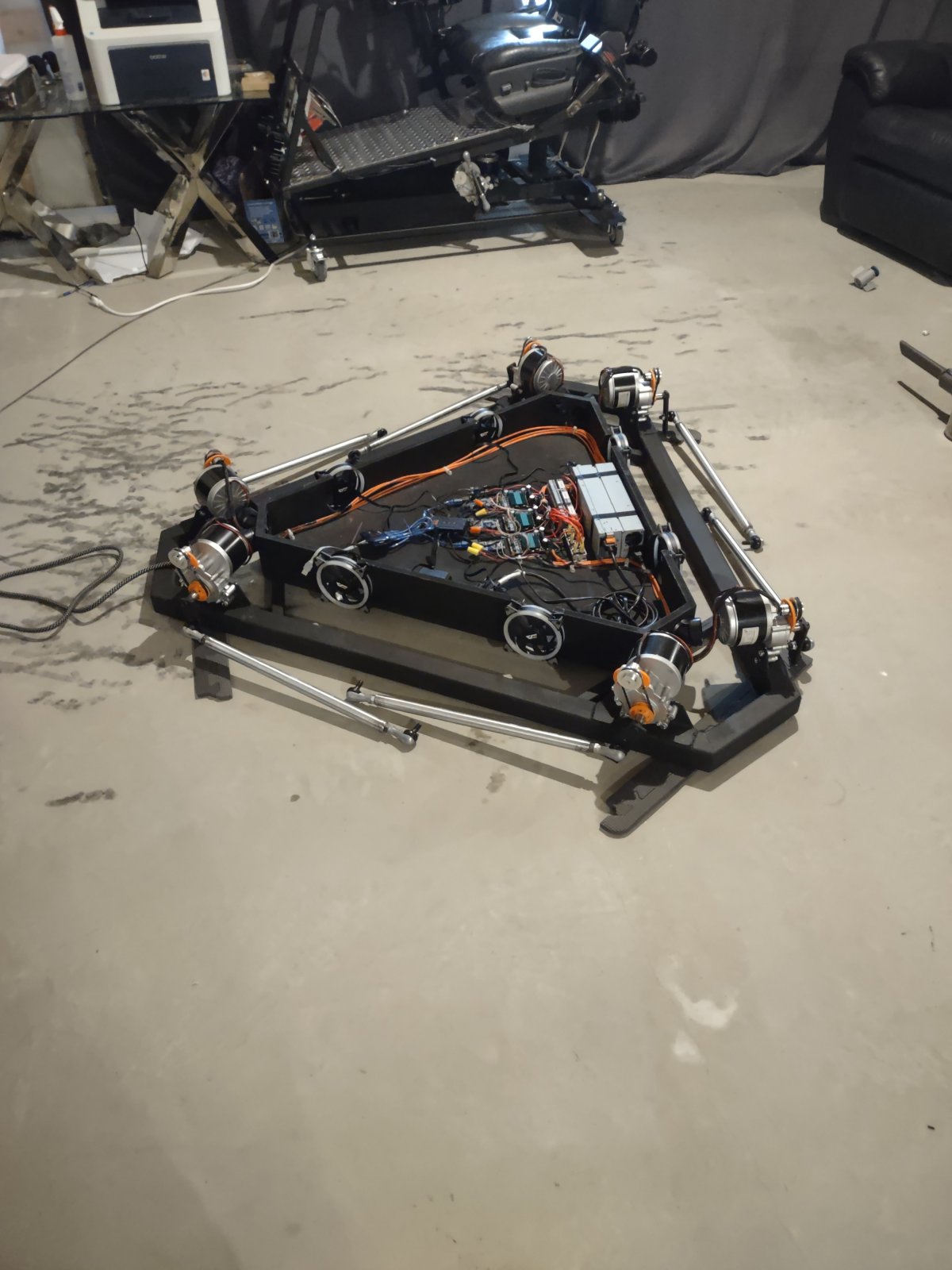

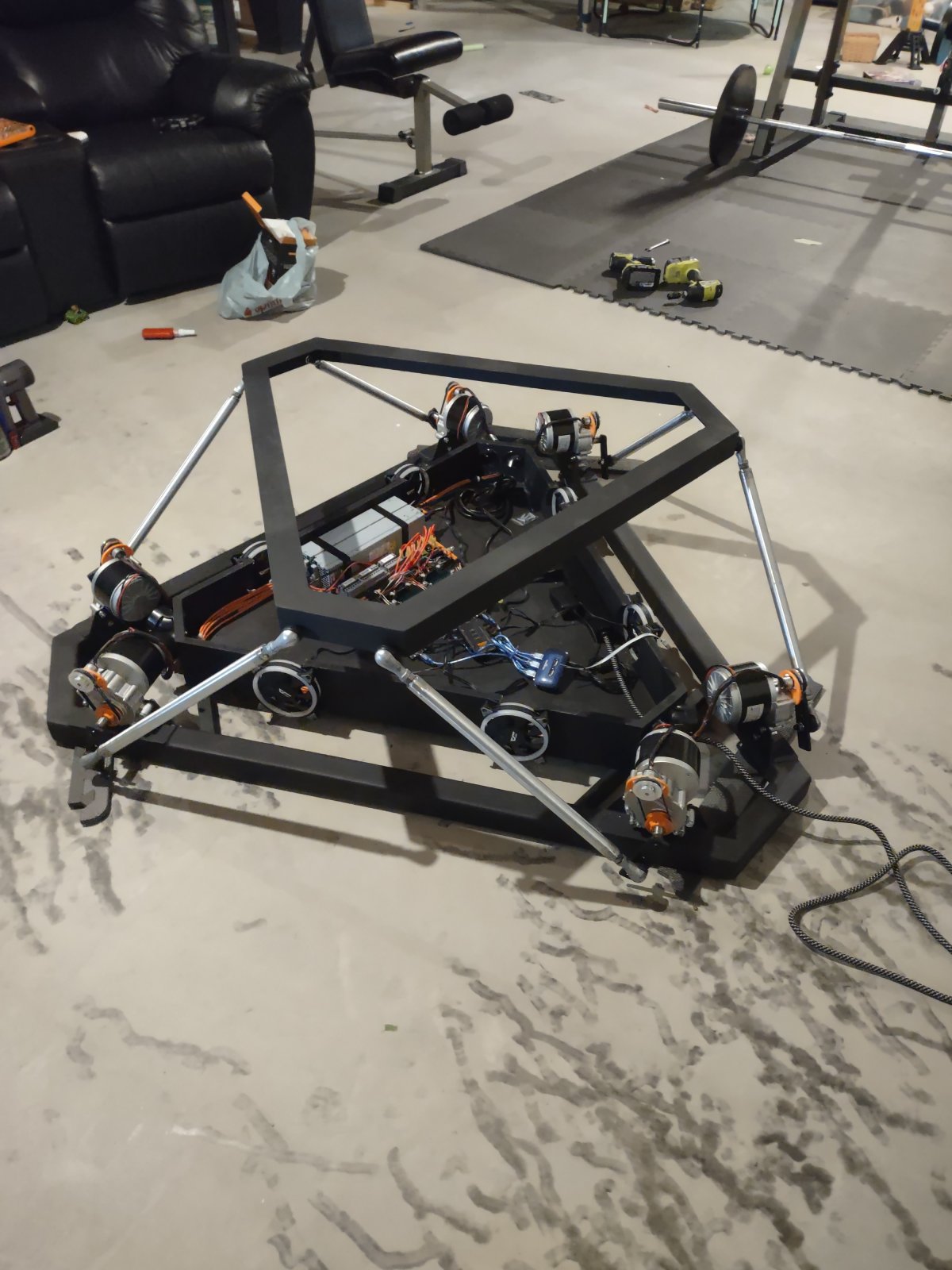

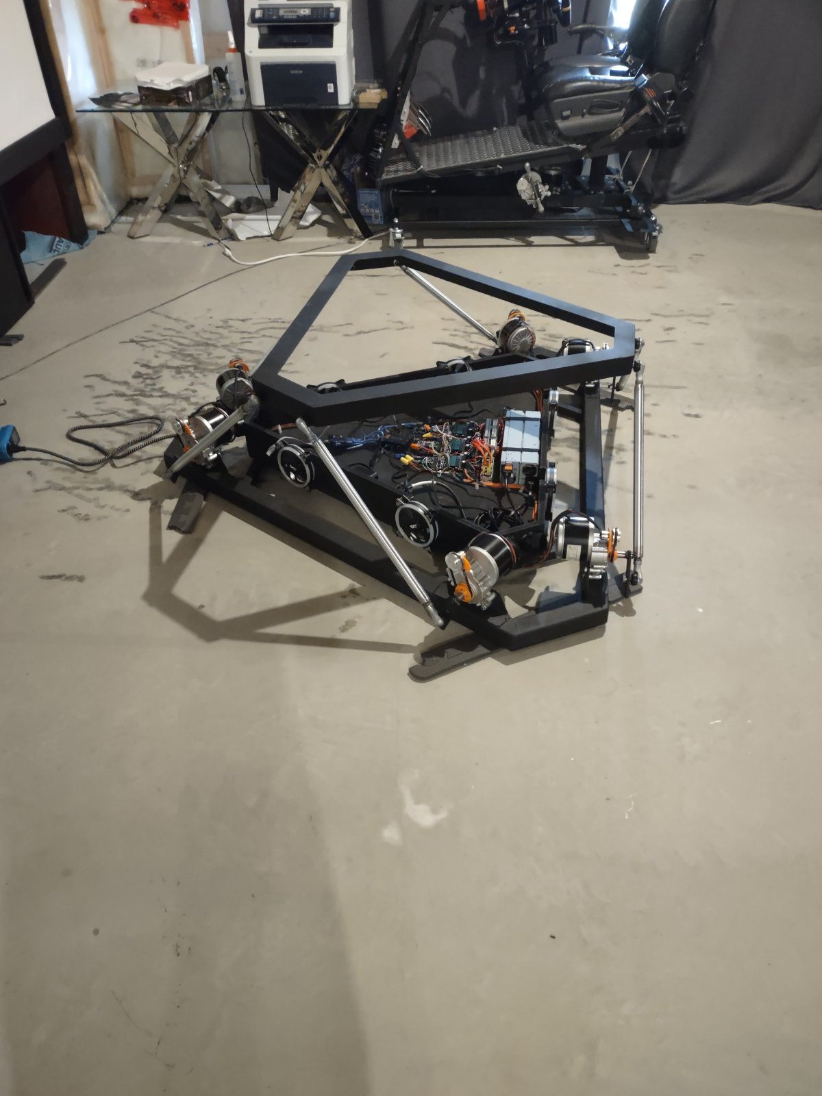

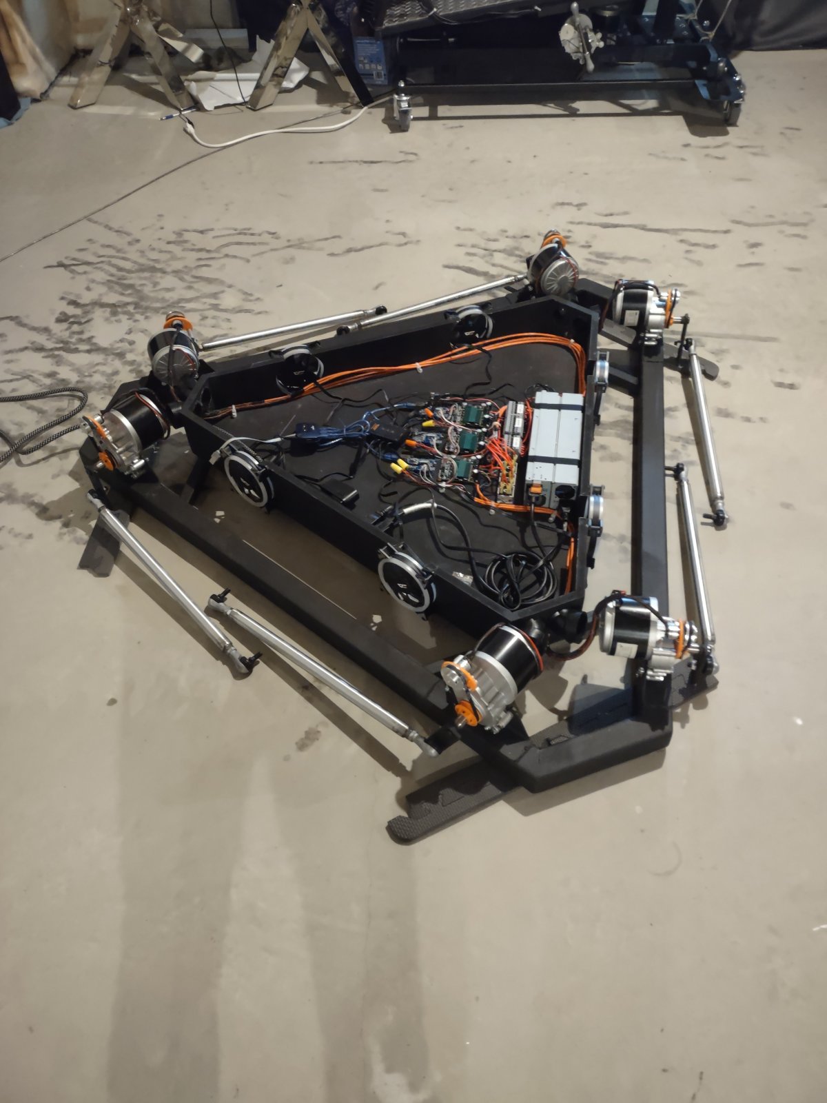

Keith's 6dof (wheelchair motors)

  5. Redcap
    Redcap New Member
    Aug 30, 2019
    - 3Coins
    You pull off 6 dof out of Yalu wheel chair motors... nice.
    I see you did experiment with different CTC lever lengths what distance worked for you?
    How they work for you when all are idle... do they support your mass?
    I'm currently wondering if investing in additional motors will work for me.
  6. Keith
    Keith Active Member
    Jan 21, 2020
    179
    Electrician
    Canada, Saskatchewan
    144Coins
    +83 / 0 / -0
    Hey. Sorry for the late response. These motors have plenty of power. The motors are only warm after an hours worth of play time or idle time.(with me sitting in cockpit.) I will take some measurments when I have a chance.

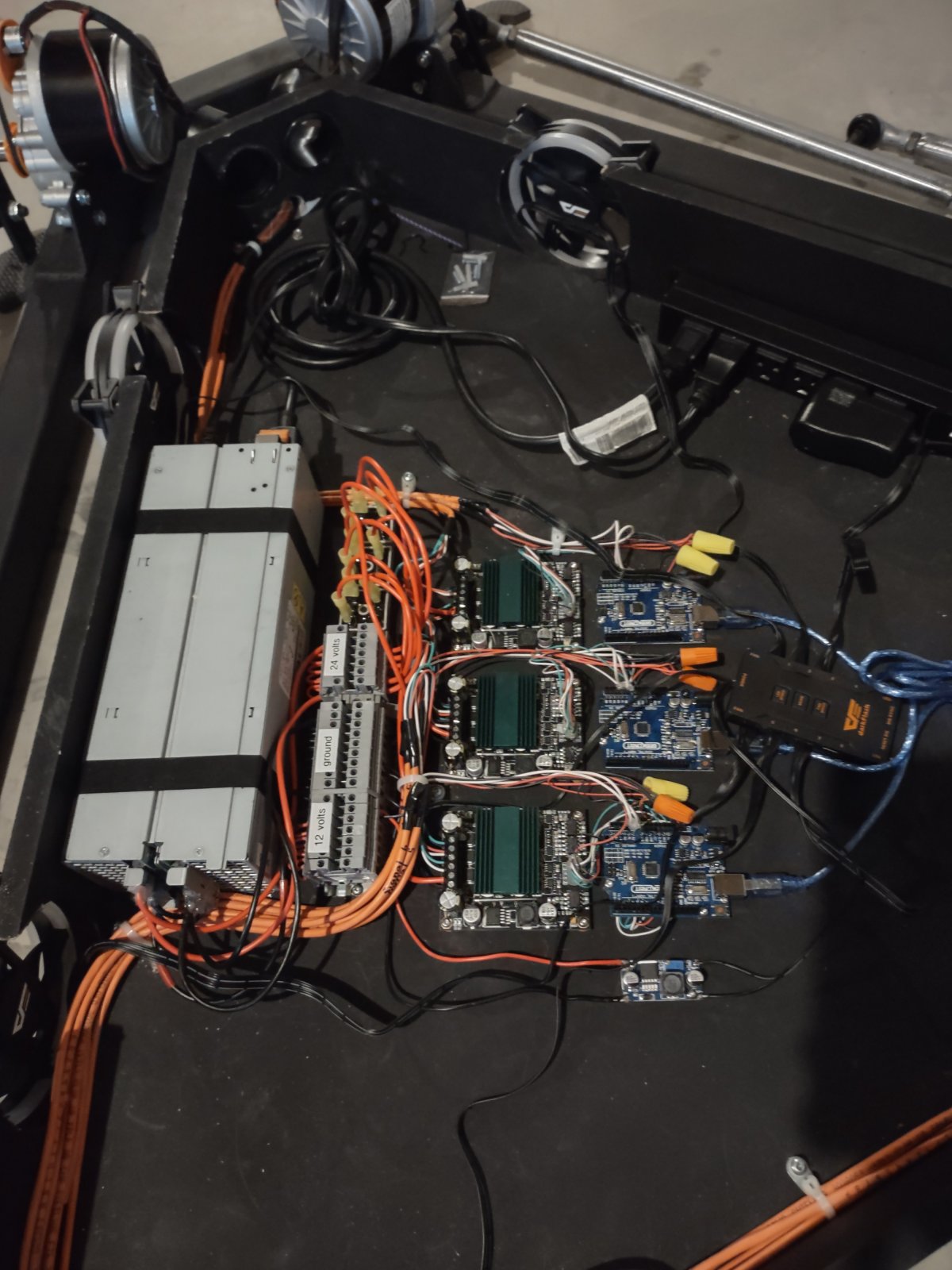

    Hi. i see you use 3 arduino connected to 1 usb port.
    i plan to connect 2 arduino and 6 iBT 2 but don't know how to connect to SMC 3.
    Does your 3 ARDUINO have the same port.
    SMC 3 will be like if 2 arduino attached.
    thank
    22,185
    154,750Coins
    +11,196 / 57 / -2
    Each Arduino is allocated its own port, and configured accordingly to the port it is assigned, your can find the port by going to the Windows Device Manager then plugin the Arduino and check the port that is assigned.
    Follow the SMC3 instructions for setup: https://www.xsimulator.net/communit...3dof-motor-driver-and-windows-utilities.4957/

    i mean how to get 4,5,6 motor in SMC 3.
    i am waiting for usb hub for testing.
    Or is SMC 3 able to open 2 panels??
  12. luu trung
    luu trung Member
    Apr 4, 2022
    76
    172Coins
    +7 / 0 / -0
    Does your usb hub need additional power?
  13. Keith
    Keith Active Member
    Jan 21, 2020
    179
    Electrician
    144Coins
    +83 / 0 / -0
    Yes it does
  14. SaintFrank
    SaintFrank Active Member
    Aug 14, 2021
    100
    Proces operator
    Nederland
    232Coins
    +39 / 0 / -0
    2DOF, 3DOF, DC motor, Arduino
    Hi Keith , great looking rig.
    I have a 2dof with the same motors and thinking of upgrading to 6dof.
    Servo motor route is pretty expensive , this looks like a great alternative.
    -How are the motors holding up ?
    -What is the CTC length of the levers, and how much movement doest it give?
    -What are dimensions of your base ?
  15. Keith
    Keith Active Member
    Jan 21, 2020
    179
    Electrician
    144Coins
    +83 / 0 / -0
    Hi Frank, the motors are holding up great. No issues yet. The rig feels awesome, I don't feel motor lash like I did with the 2dof system. I will post some more pictures and measurements when I have some free time
  16. Ronan Design
    Jun 4, 2021
    270
    Toronto, Canada
    1,716Coins
    +143 / 2 / -0
    Hi, I know this is an old thread, but I'm looking into building a compact 6dof with these motors after enjoying my 2DOF for a few years. So I'd be very much interested in how those motors hold up after a few years, and the dimensions of the rig and length of the rods. Thanks!
