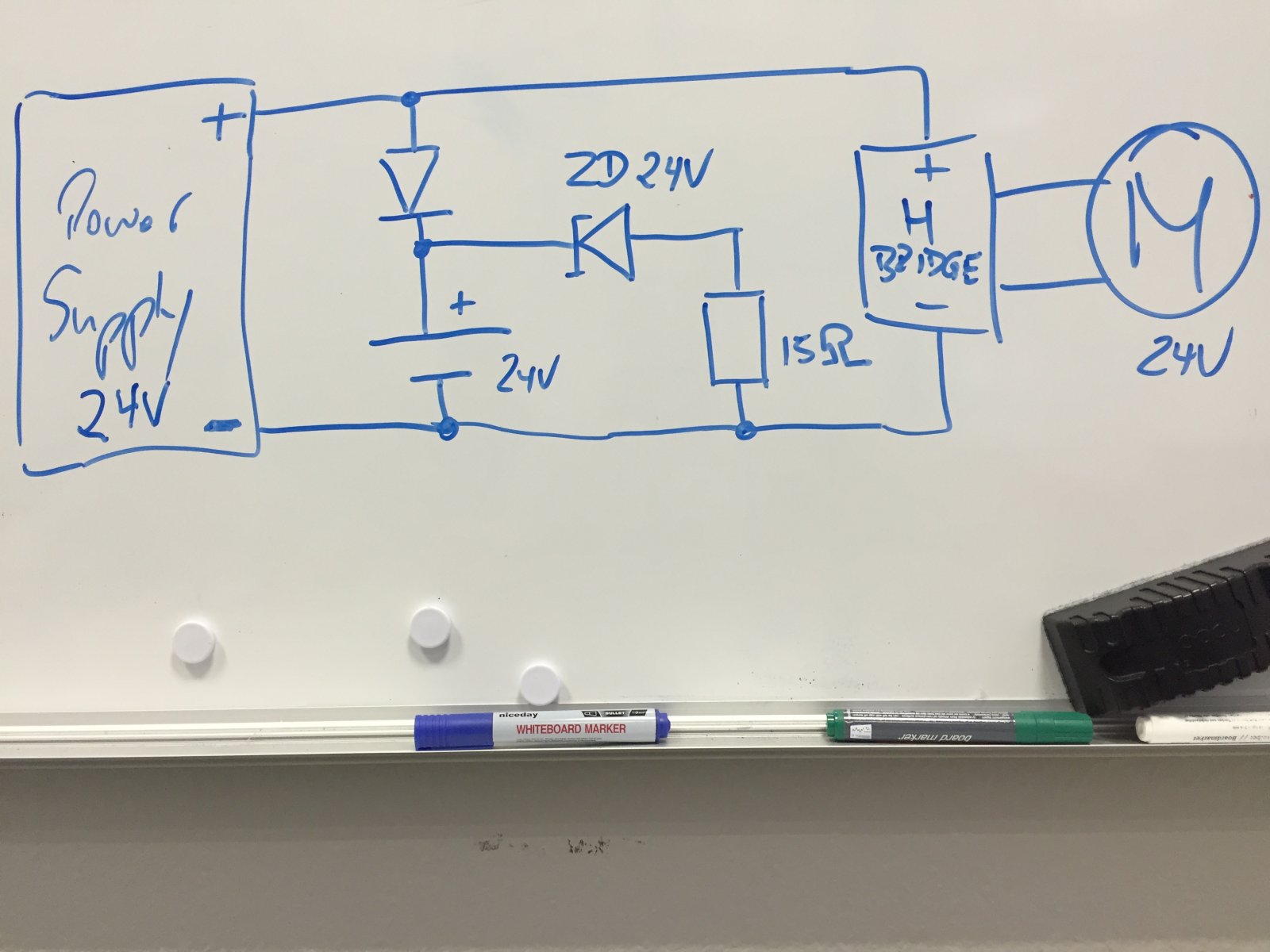

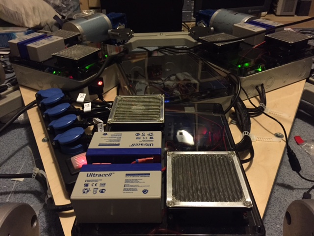

    today i finally mounted the "regen energy buffer". This is very important to secure your motor-driver-bridges from returning energy from the motor during direction changes or a brake.
    The excess energy capacity from the motors are temporay stored into the 24V/1.3Ah lead-acid gel batteries.

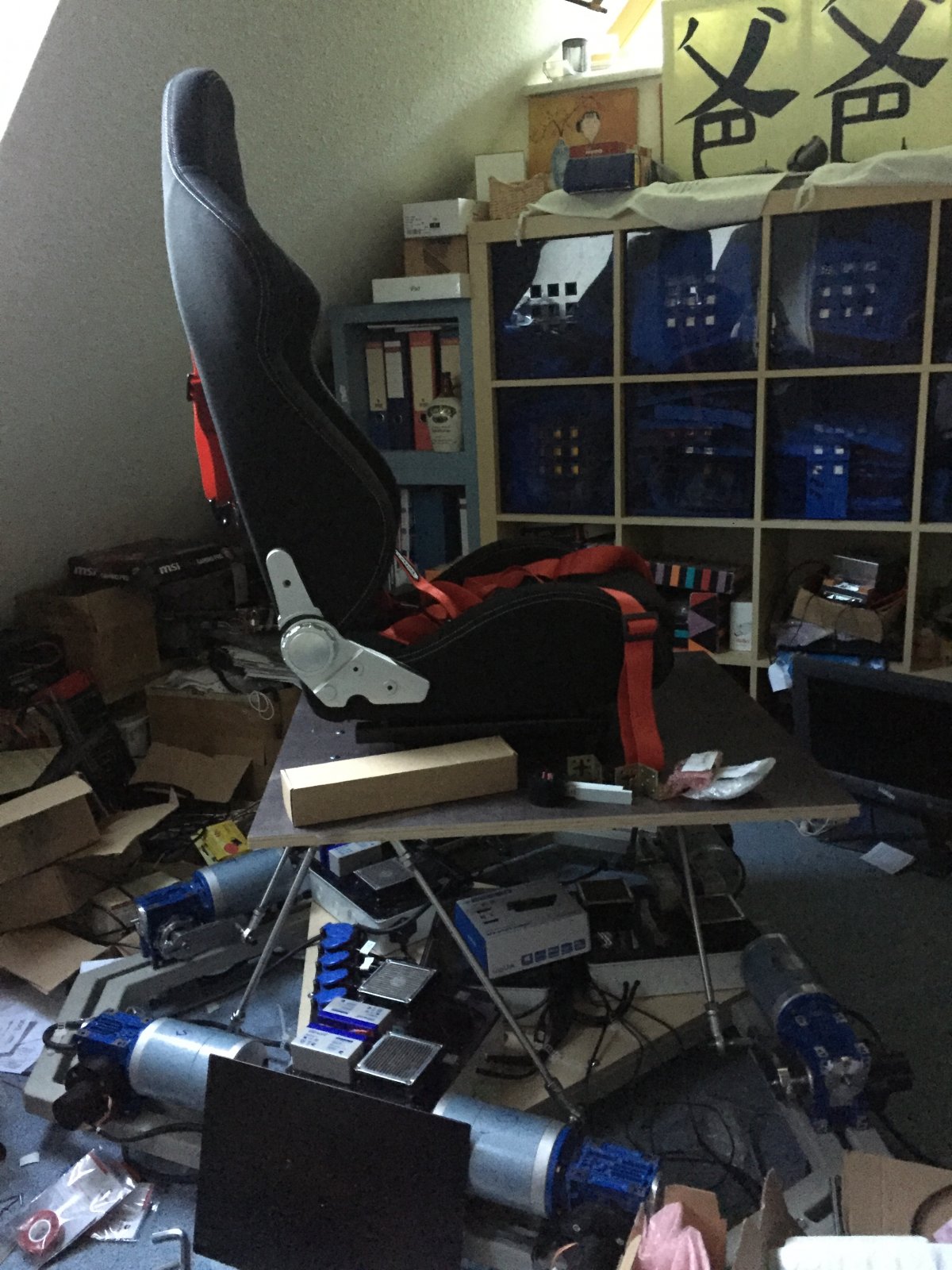

    next level arrived !
    swash plate assembled and under test :cheers

    Seat mounted !

  9. kermitkong
    kermitkong Active Member Gold Contributor
    Apr 12, 2016
    187
    Hardware Development
    1,240Coins
    +275 / 1 / -0
    This is a principle circuit design to explain how this works together. If you have questions please feel free to ask !

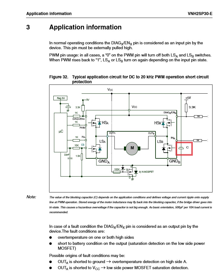

  10. SeatTime
    2,572
    That's fine just wondered how you were doing it. FI on the MMs, capacitors are used on the driver card itself to do the same thing.

    Hi @SeatTime ,
    I've also a 22000uF cap installed,
    But the regen voltage from motors back to the power supply jumps up to 36 volt (without my battery buffer). And this is really bad for the power supply and the motor driver board . I already distroid both of them one time. With the buffer circuit the regen voltage is limited to about 25V this is absolutely fine.

    I See,
    I use the roboclaw 2x60A boards .
    And with my 6 heavy 24v/490W motors I've definitely this issue and the 22000uF or even 44000uF isn't enough. That's the reason why I'm using batteries to store energy temporary.
    And this works quite good now :)

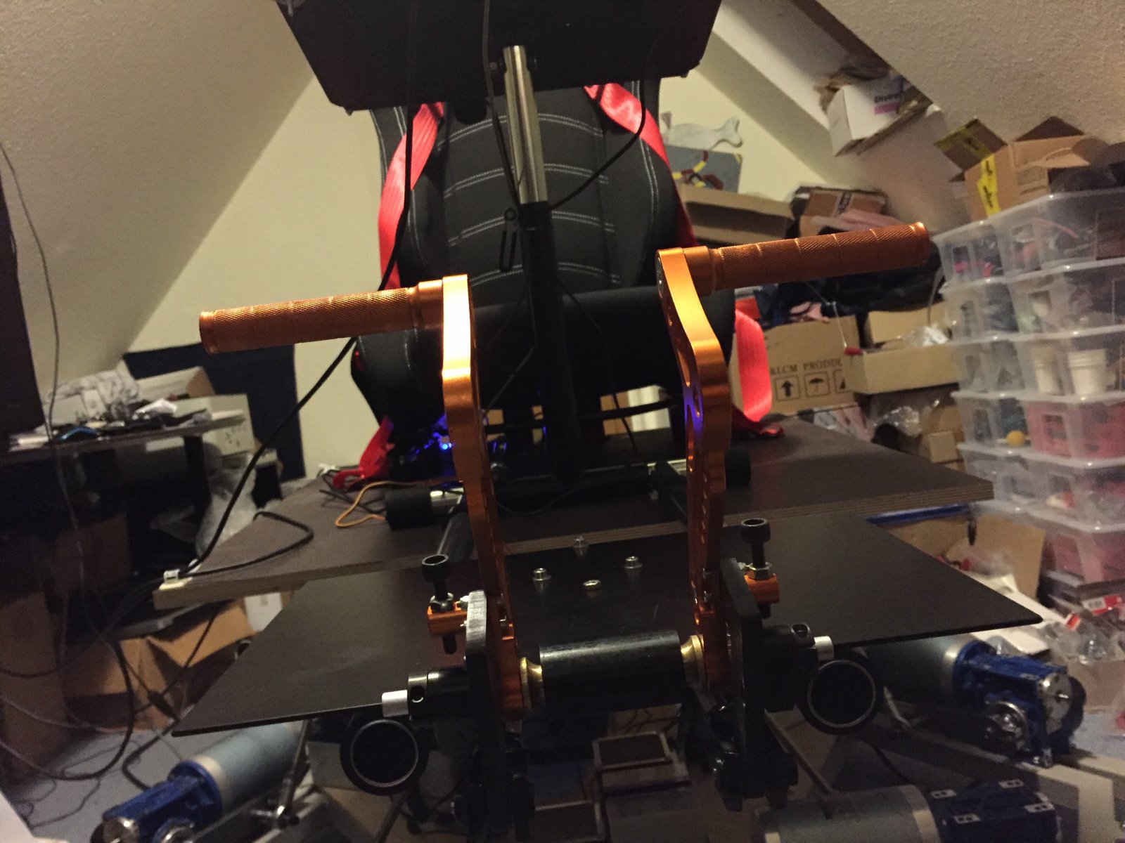

    Since that the Hotas warthog doesn't have gearing on the stick,I installed foot-pedals for gearing (same like in a helicopter ).
