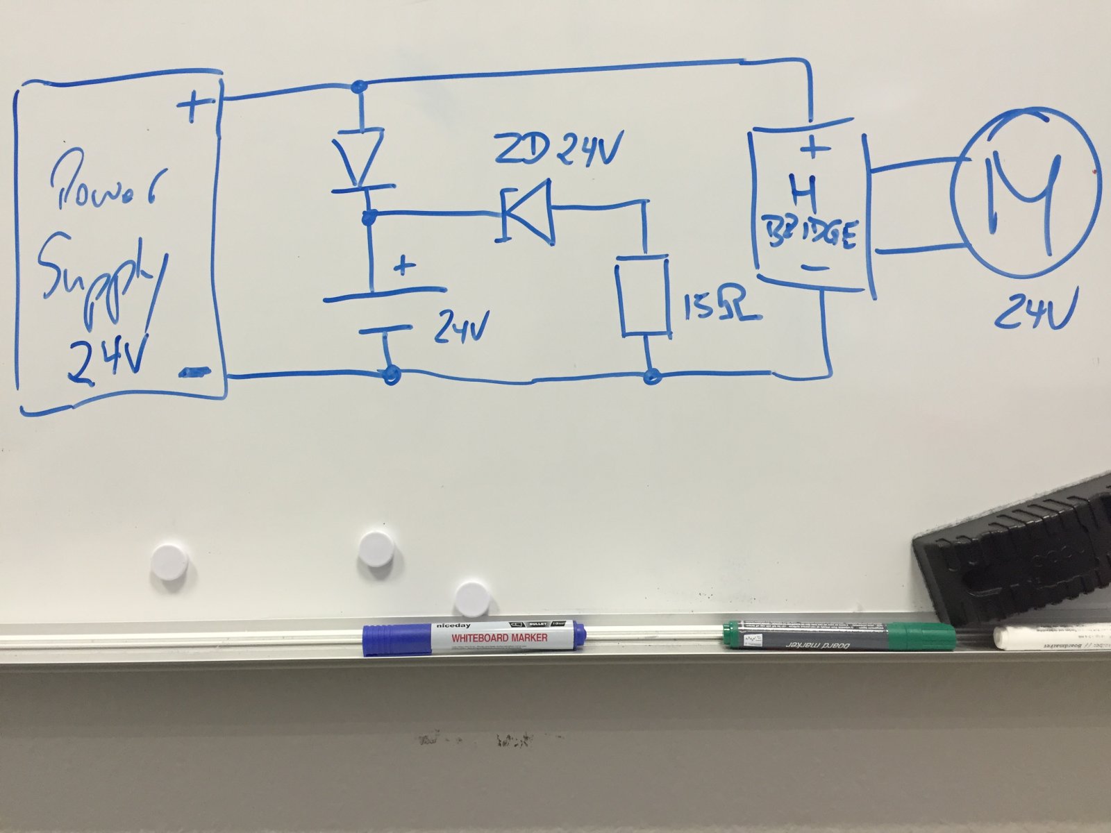

  16. kermitkong
    kermitkong Active Member Gold Contributor
    Apr 12, 2016
    187
    Hardware Development
    1,240Coins
    +275 / 1 / -0
    clean regen-circuit design with component recomendations
    The Battery MUST BE lead-acid type of battery

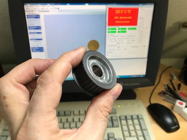

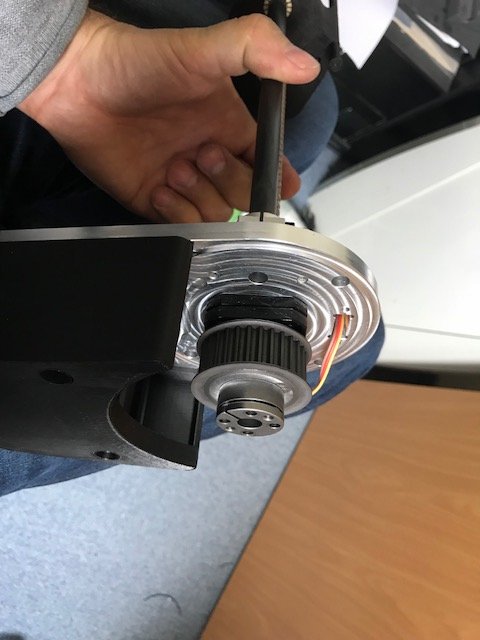

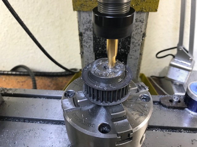

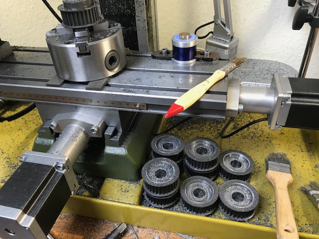

  17. kermitkong
    Apr 12, 2016
    187
    1,240Coins
    +275 / 1 / -0
    here is the belt pulley CNC processing for @kermitkong 's actuator.
    Isn't easy to machine the steel belt pulley's

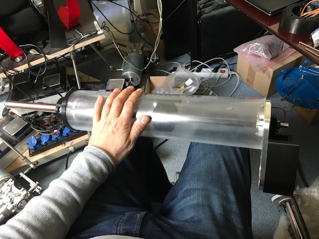

  19. kermitkong
    Apr 12, 2016
    187
    1,240Coins
    +275 / 1 / -0
