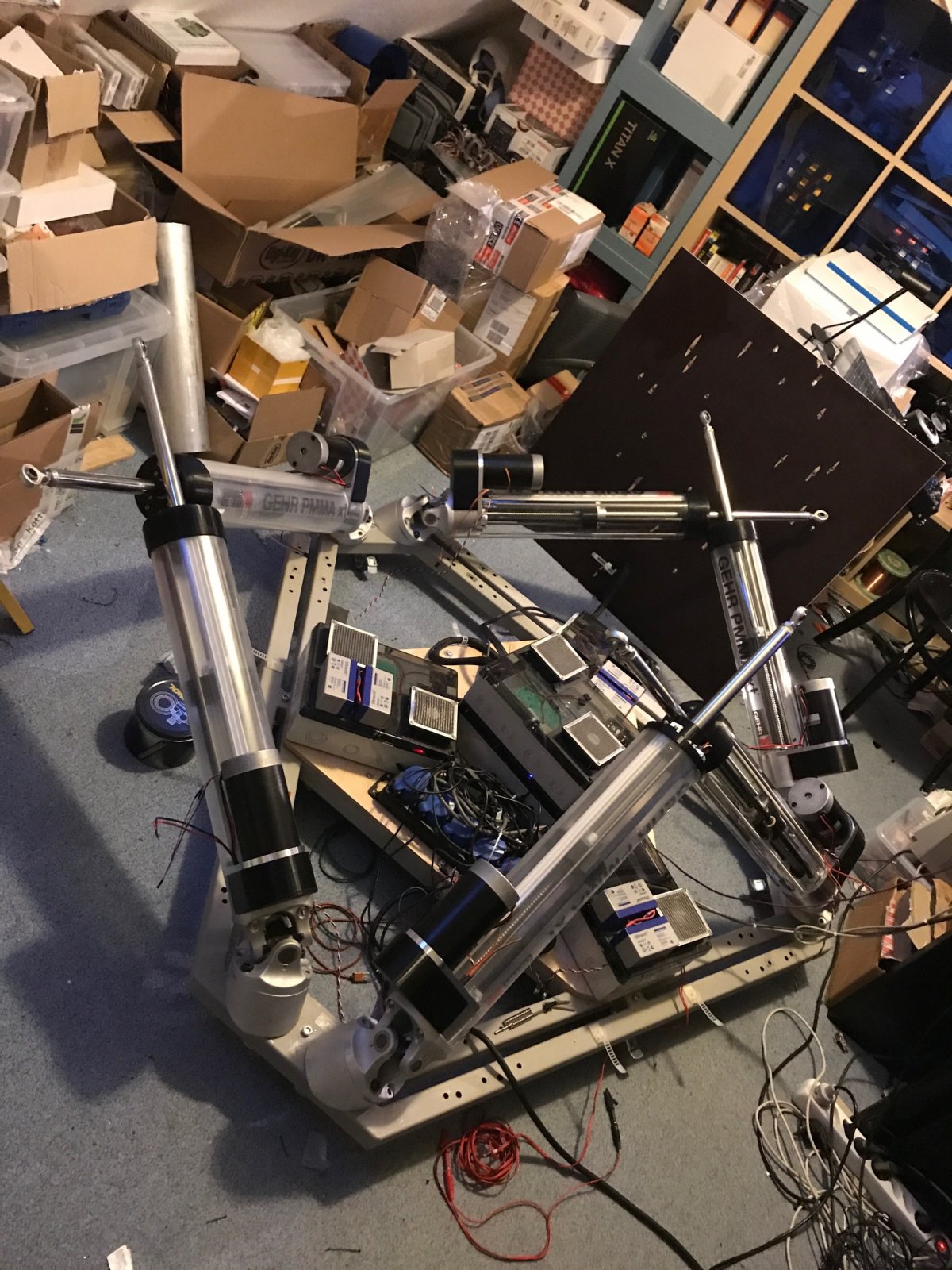

    total mess :grin
    all the actuators mounted. plattform will be mounted tonight.
    looking forward to have the 1st 6DOF test-run soon.

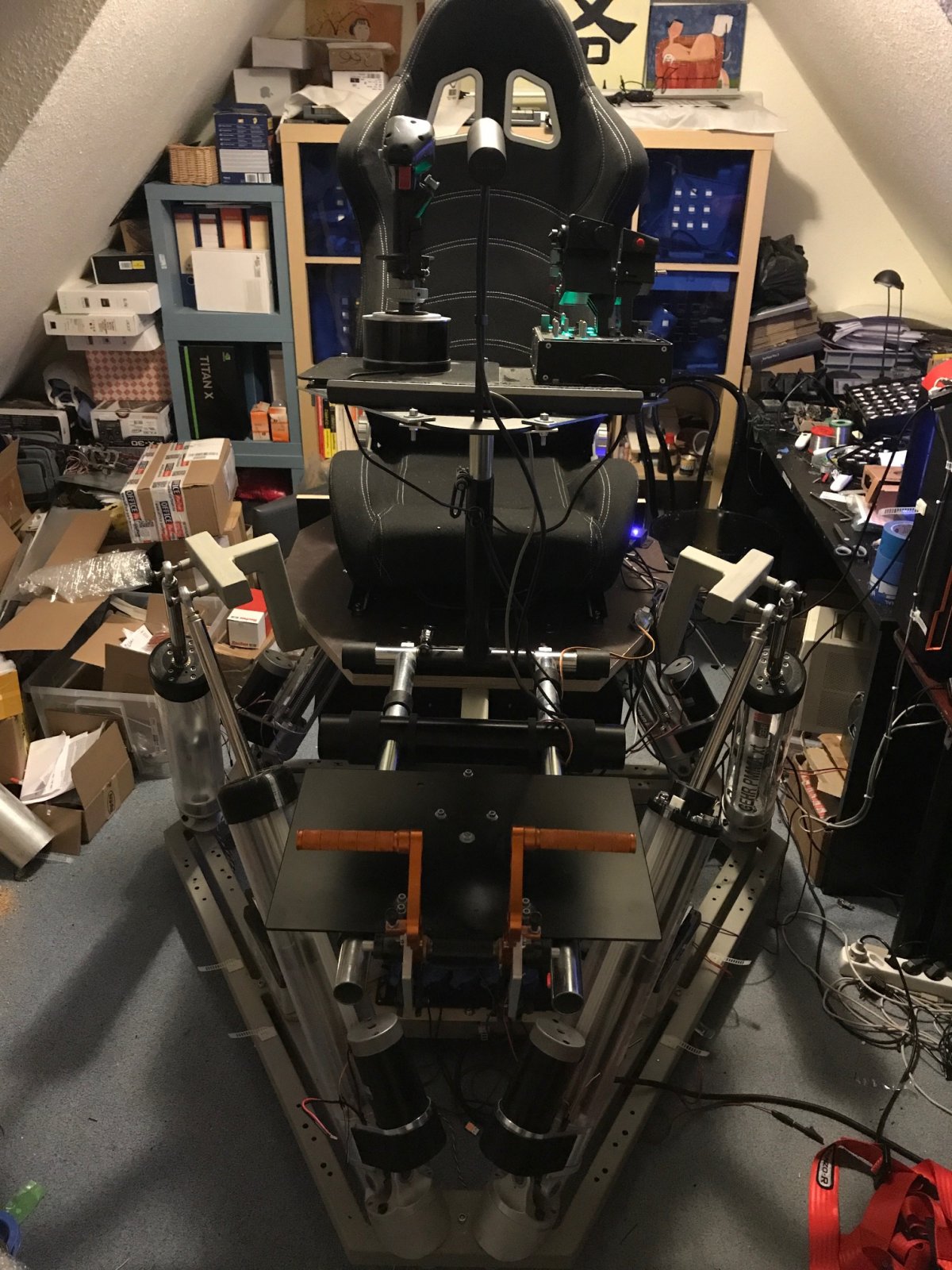

    finally assembled :cheers
    hope i can setup SimTools tomorrow
