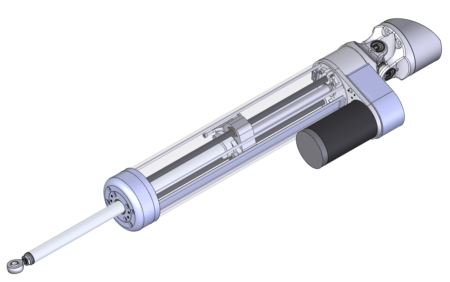

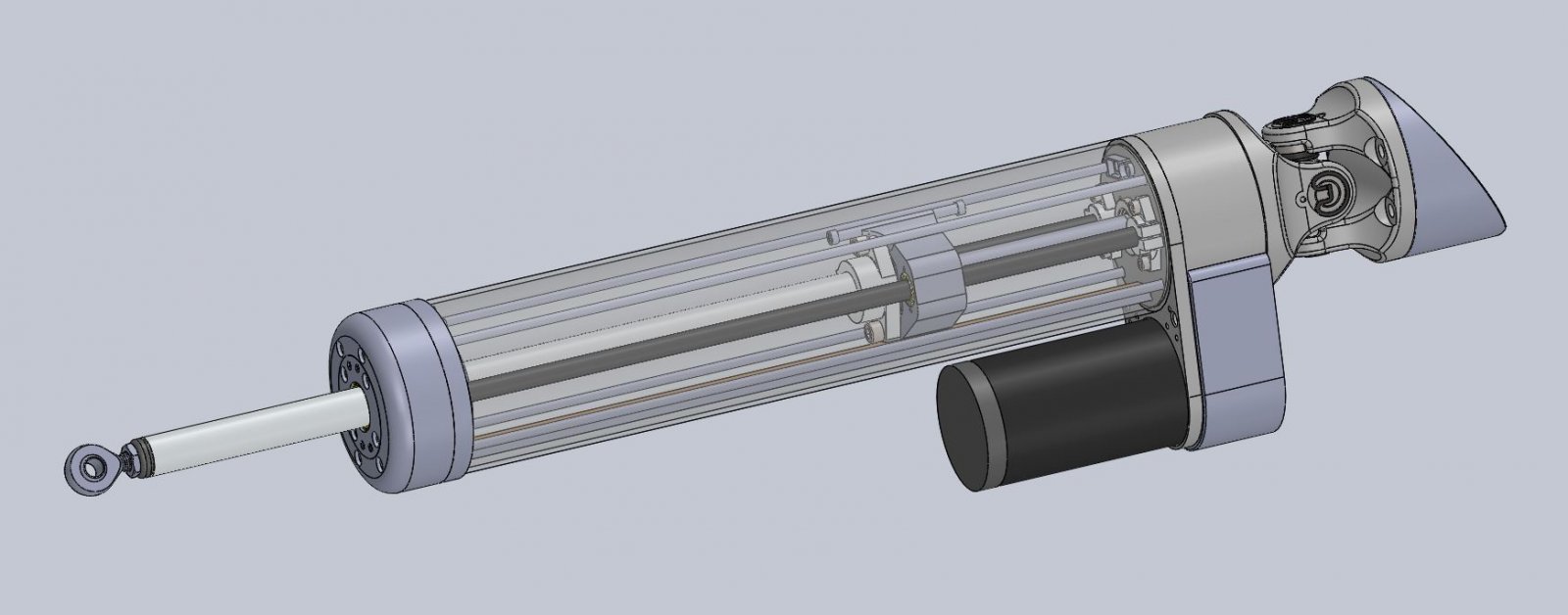

    Hello guys,
    hereby i would like to share my actuator and motionseat design. This design was inspired by Hoddems actuator design.
    I created a OneDrive folder, please feel free and download it if you are interest it.
    The Dataset also includes to Bill-Of-Material (BOM) and a wiring diagram of the motion-seat as well.
    if you have any question, please let me know.
    https://1drv.ms/f/s!AmCwooBbjonByhp8Kd3xmfgRgRxl

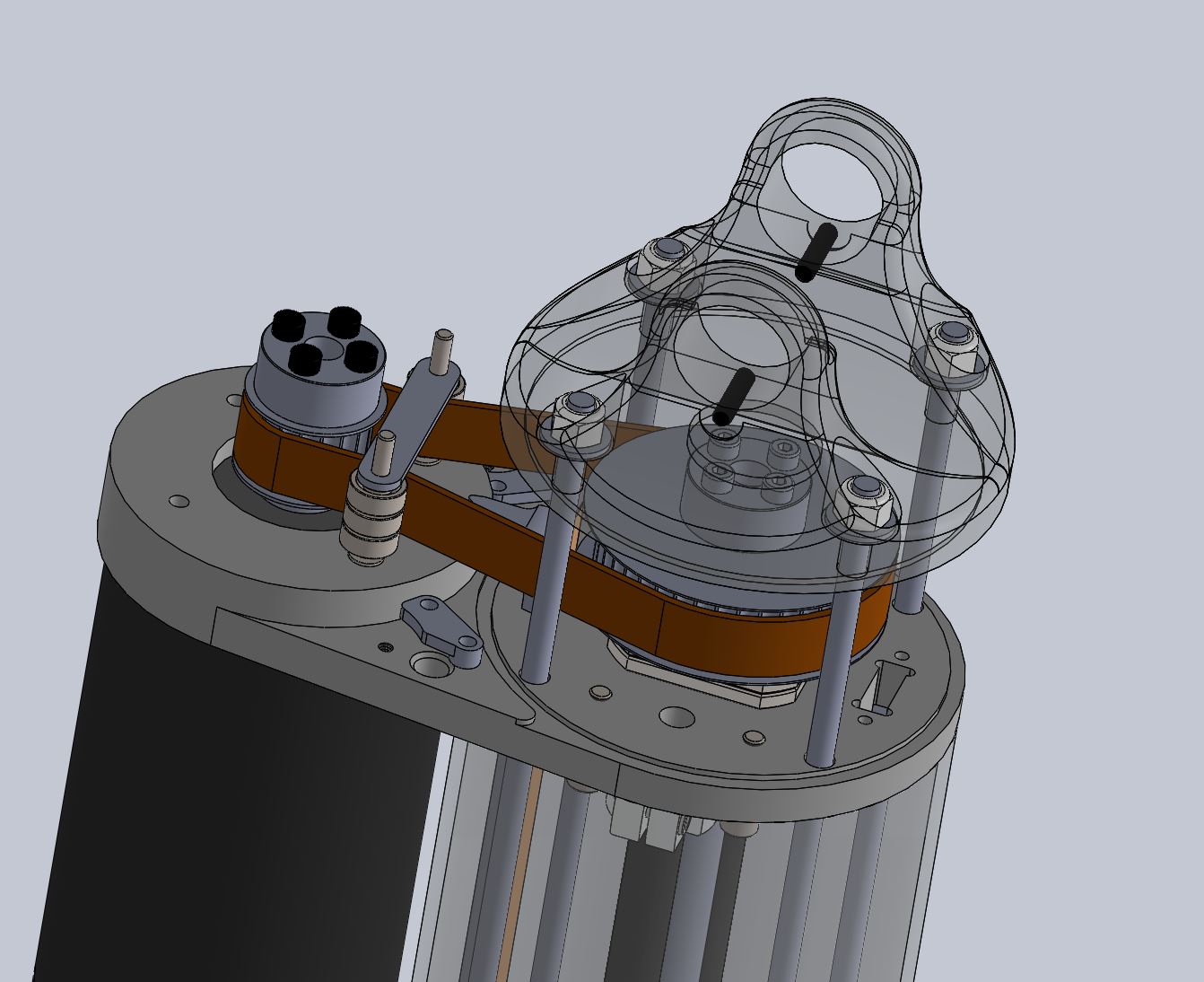

    just another change for my actuators.
    this is only meaningful for elite dangerous or flight simulators in general.
    i reduced the gear ratio from 1:1 to 2:1.
    Before i had 5mm shaft-travel per motor axis turn.
    now i have 2.5mm shaft-travel per motor axis turn.
    the result should be more smoothness, less jerking on the platform.
    The actuator speed is reduced to about 110mm/sec. (before 220mm/sec.)
    This is great for flight simulation, but could be slightly too slow for car racing simulation.
    anyway both option fits into the construction. the 1:1 and the 2:1 setup.
    also added a belt-tightener as you can see in the picture.

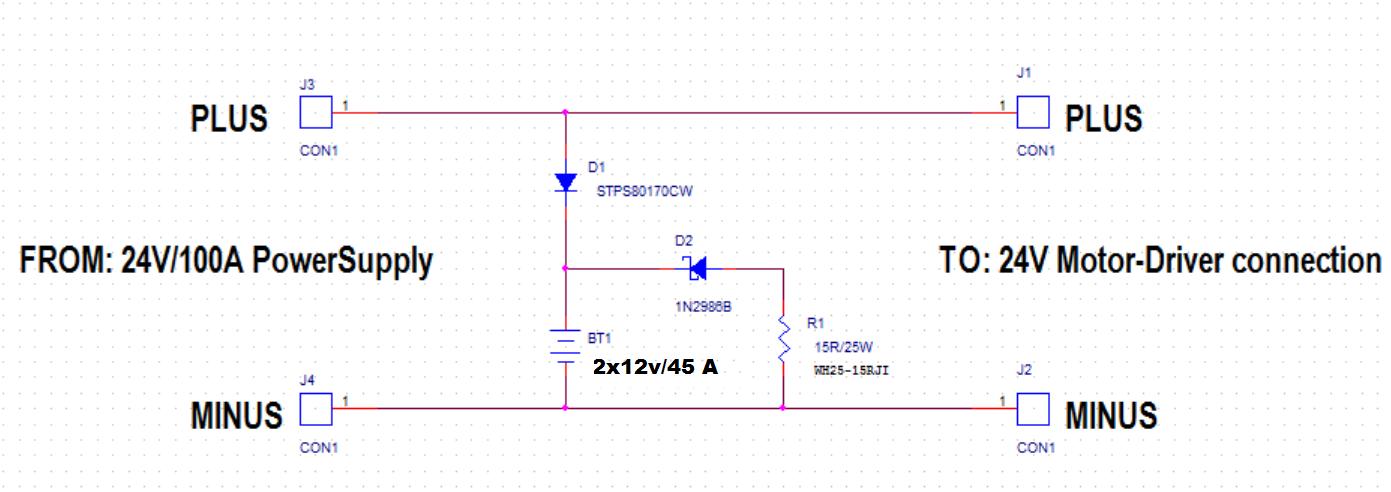

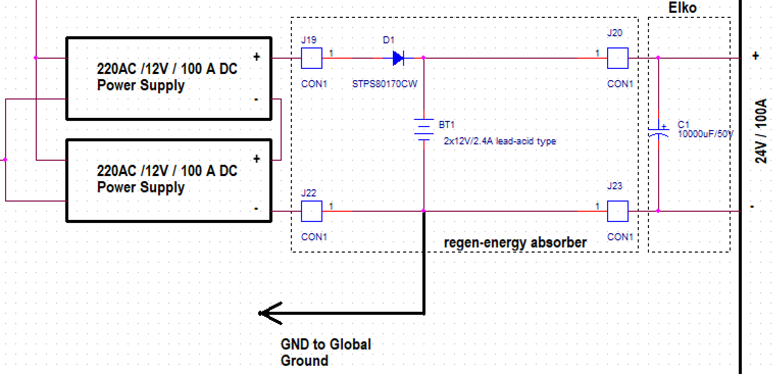

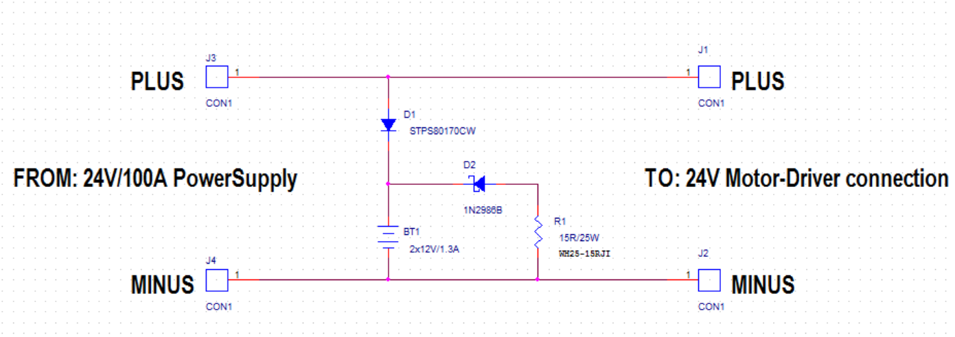

    can you put the diagram and components for the battery connection. do i connect it in parallel with bridge or add some thing in between.

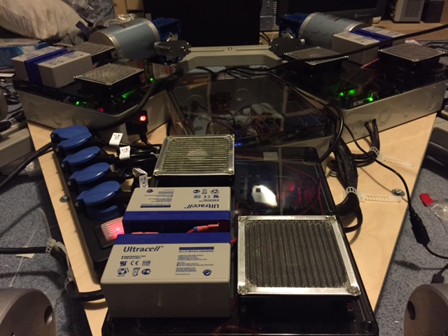

  12. kermitkong
    kermitkong Active Member Gold Contributor
    Apr 12, 2016
    187
    Hardware Development
    1,240Coins
    +275 / 1 / -0
    Hi @fuad ,
    there're two version for the regen energy buffer available.
    This is the version which discharge the battery over time to about 50% capacity.
    This give the smaller battery enough capacity to buffer the energy which comes back from the motors.
    this is a simplified circuit. This configuration has an drop-voltage over D1 which ecceptable low.
    This Version needs more capacity for the batteries compared to the previous to be efficient.

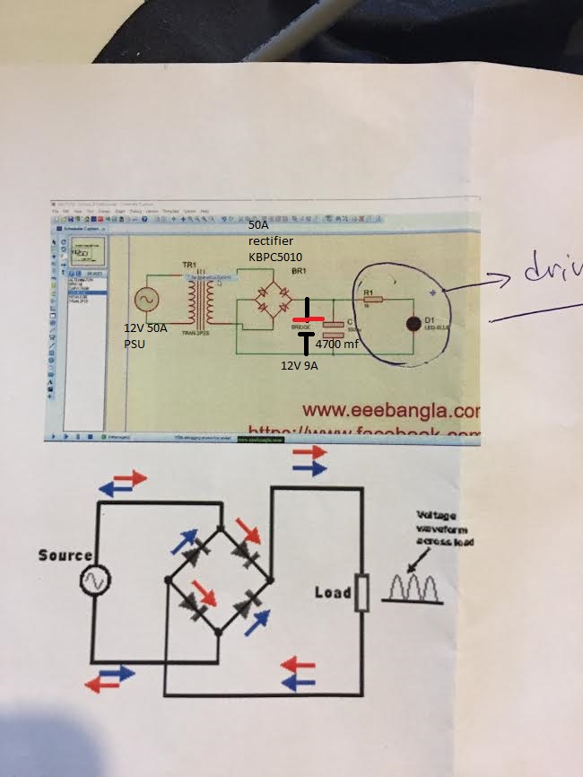

  15. fuad
    fuad New Member
    Sep 9, 2017
    25
    kuwait
    23Coins
    +11 / 0 / -0
    HI @kermitkong i have done the second option but with a sight change since i have rectifier in hand i used it instead of the Diode you provided in your design. kindly check the attached diagram and advice. note i will double the IBT h-Bridge since they cutoff when i use 1 and my motors are 350W they draw lots of amps.... i have tried this solution and it works....
    thank you

    It's possible to use a same circuit whit battery who have 45 A ?
  17. kermitkong
    Apr 12, 2016
    187
    1,240Coins
    +275 / 1 / -0
    hi @thecure
    thats possible, but makes no difference functional wise.
    if you expect a benifit from the larger batteries (more capacity) i would recommend to use the 2nd circuit option.
    This circuit option give you the benefit to use the battery as a buffer to save powersupplies for over current peaks.
    In this case larger batteries like 45A/h capacity is better than lower e.g. 2.4A/h capacity.
  18. kermitkong
    Apr 12, 2016
    187
    1,240Coins
    +275 / 1 / -0
    hi looks good so far, but theres on issue !!!!
    the power supply deliver AC12V*1.414 = DC16.9V that too much to charge the battery.
    The typical charging voltage is 14.5V to 14.7V
    so you have to reduce the voltage. maybe use some diodes to drop the voltage down to about 14.5V ???????
    Best,
    Kermit
