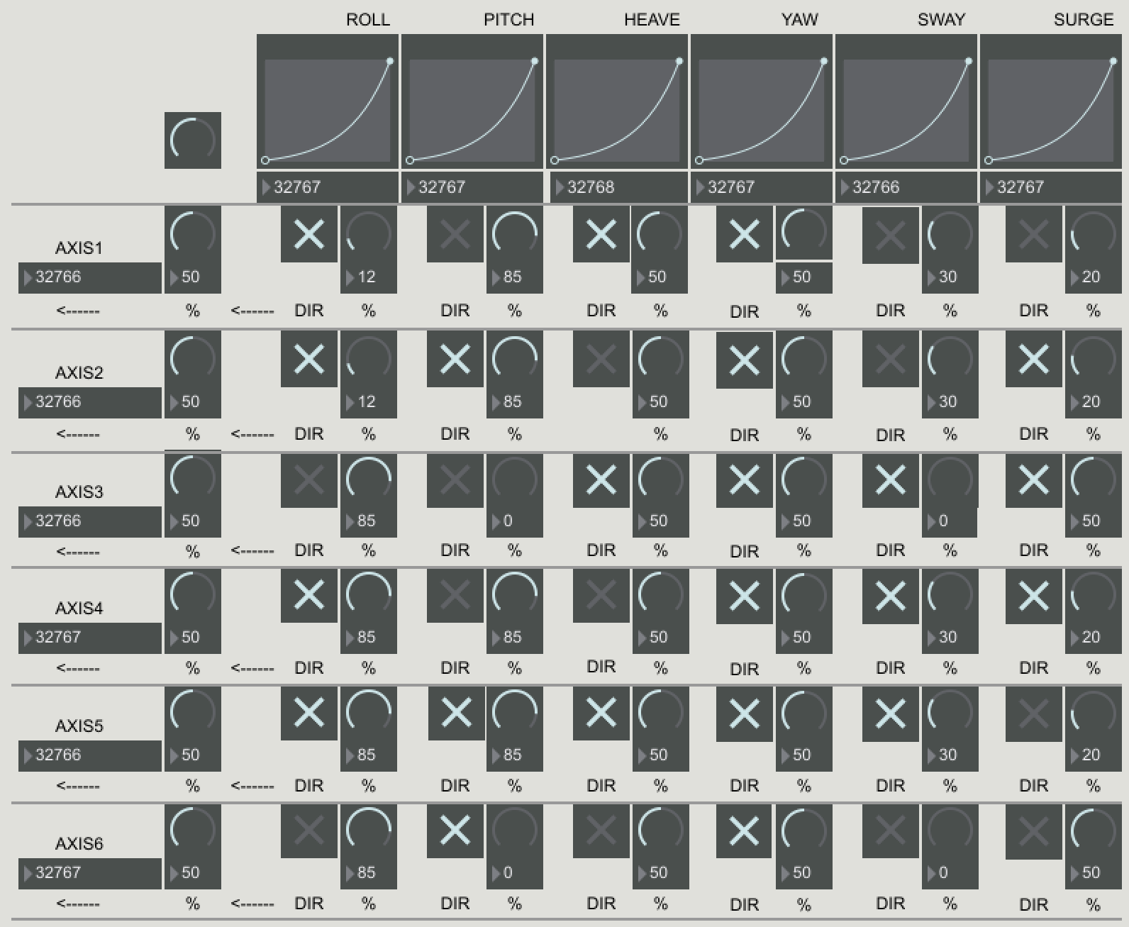

    Hi guys,
    i realized, that i missed some filter and smoothing functions in SimTools which give my actuators a smoother reaction.
    i made a separate Tool, which take all meaningfull axis-values from SimTools via UDP, it is a quick hack, i will check it how does it work and will give feedback to anybody who is interested.

    Hi @kermitkong
    Really nice work with your linear actuators, can't wait to see your rig up and running!! I have been toying with upgrading my 4DOF to a 6DOF with linear actuators.
    One of my biggest gripes is the non-linear motion of motors/gearbox's and that Simtools doesn't have a way of out putting a non-linear curve. I'm still running simtools 2.0.0 and planing to upgrade to 2.2.5 later today.
    The Image of the filter and smoothing functions above, is this a tool you have made yourself?
    I very interested to know, it appears that with this tool you can apply a non linear curve to each motion.
    Is this correct?
    :cheers
  10. kermitkong
    kermitkong Active Member Gold Contributor
    Apr 12, 2016
    187
    Hardware Development
    1,238Coins
    +275 / 1 / -0
    Hi @MWB
    Yes, I made this small extra APP to give a non-linear effect to each of the DOF.
    So I collect all the 6DOF before this is processed by the internal 6DOF-mixer via UDP into my APP. Then I add the filter function to each of the DOF (e.g. ROLL) and route this to my own 6DOF Mixer to generate the motor output values. In my case sabertooth serial command compatible.
    This works absolutely nice, now I have a smoothness around low values without loosing the dynamic range to the limits.
    And in elite dangerous the feeing is fantastic, is absolut a real movement feeling ,not to heavy around low changes and with anough BANG for higher changes.
