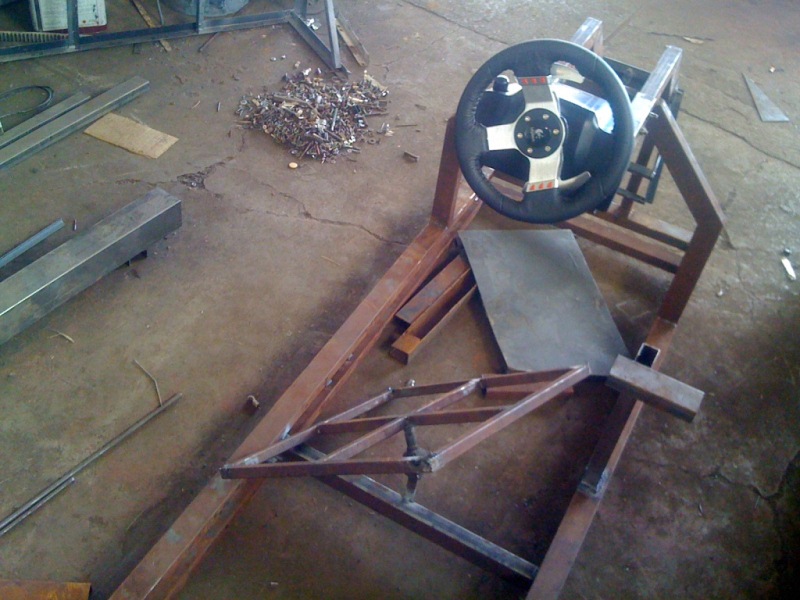

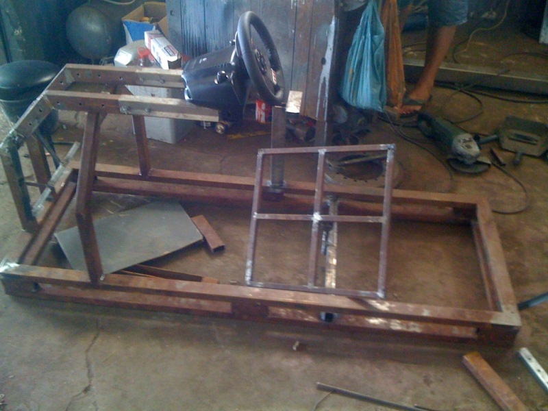

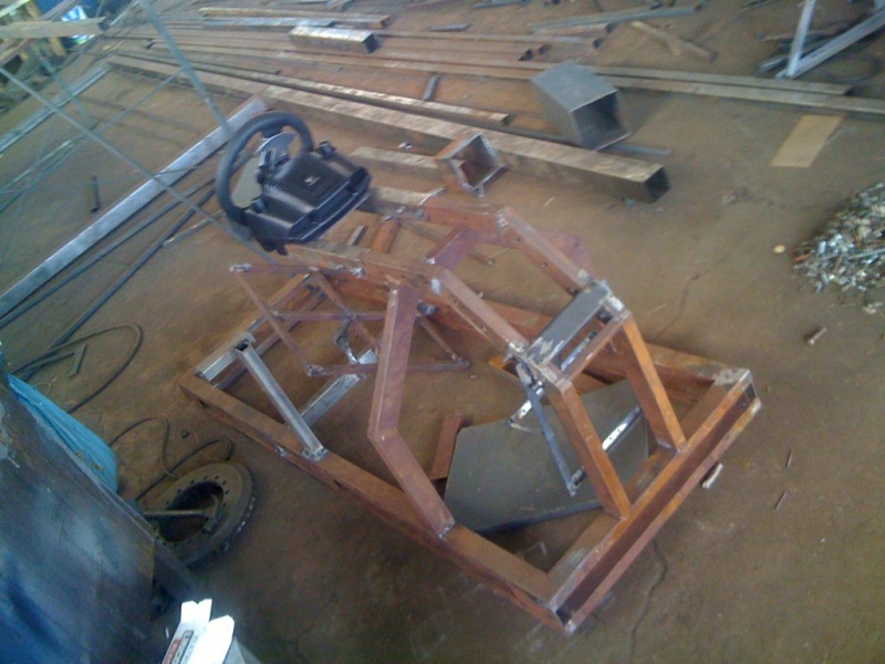

    Here some photos of the production of Cockpit.
    There are a few hours of work, but I hope to finish this weekend.
    Regarding the programming board, I'm still having problems, I'll buy a new serial cable to do another test tomorrow.
    Grateful for the return of all
