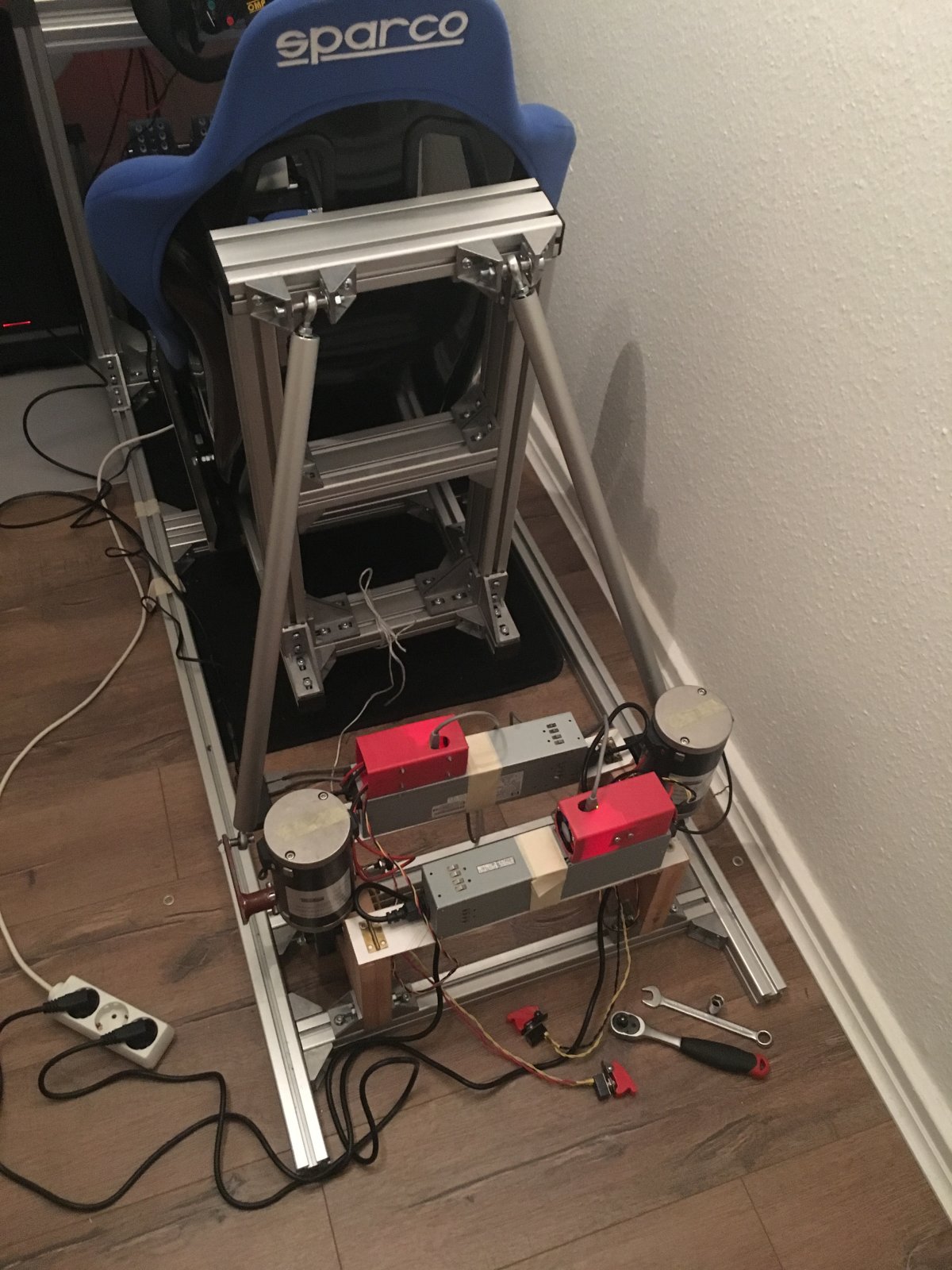

    Since I have been very lazy for one year and a half, I thought I'll dig this out again. I did not update this thread because I did not do anything... There were some reasons, but mainly, I have been lazy :D
    A couple weeks ago I thought it's a good time to finish the build, so I got back to building and since I have done some things since then I thought a little update would be nice.
    What happend since the last post:
    • got 2 bigger worm gear motors and new levers
    • Put things together with the rest of the setup
    • Started configuring simtools and JRKs
    Right now I have 80mm CTC. I will punch in some more holes at 60mm or so and will fiddle with the geometry.
    ToDos:
    • Shorten lever length
    • try some geometry changes
    • build something to connect the motor mounts for more rigidity
    • get something permament to put PSU and JRKs on
    • Tidy everything up a little
    • spend some more time in simtools
    This is how far it is right now: IMG_2721.JPG

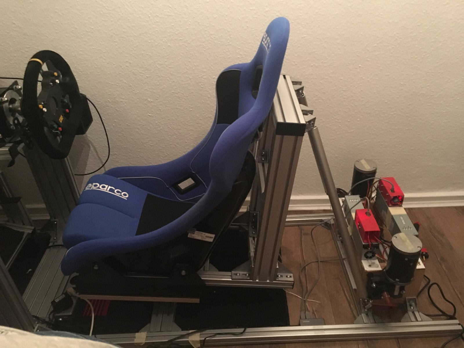

    Since my last post I changed the geometry a lot. I moved the cardan joint around to a better position, taking a lot of load off the motors. The pivot point I had before was a guesstimate, made during the building process and it has been of by about 12cm. With moving the cardan I reduced the load from about 35-40kg to basically 0 in neutral position. I changed the CTC to 50mm as well.
    At the moment I run the JRKs with 400 for acceleration and max, whatever it is called because of the PSU problem I have ( explained below). Here is a Video of it runs:
    I had some trouble with one of the motors. The JRK on that side was significantly hotter and the PSU shutdown from time to time. I opend the motors and turned the anchors by hand, with everything else (except power) attached. I did not feel any difference so I put them back together. One of them was easy to put together, something felt of with the other one. I saw there where two sping washers in the second motor and took one out. That solved the temepature difference problem :)
    Sadly the one PSU still shuts down, I ordered a new one.
    Right now I am fairly satisfied with how it works, and think I am done with building and geometry. I still need a lot of tuning in simtools I think. That is on the list as soon as I get the PSU problem fixed.
