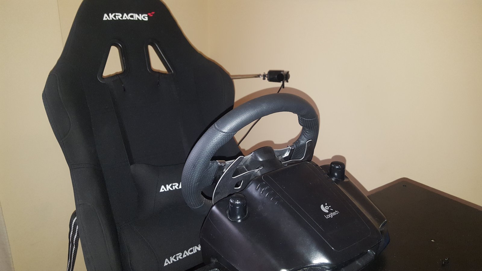

    I've found a workaround on CV1, at least works for me. I've played like this a lot and maybe I get one tracking jump per 1 hour of playing.
    I had the same problem as others, my sim has a lot of pitching degrees and this mostly happened on flying games.
    I placed the camera to my left side, 40cm away from my head, and the camera pointing to my face. I had to re calibrate guardian system, placing the other camera to the oposite side (just for calibration). When playing I unplug the other camera.
    It's attached to a selfie stick, I shrink the stick when not using. Attached with two plastic clamps throught the seat belt holes.
    I hope this could help you.

    Don't forget to set the height measure, not yours standing but seated in the sim.

    Thank you very much El Batalitas that works perfectly for me !
    I did put the camera on my left side about the height of my head and no problem anymore on my 6dof ring .
    No need motion cancellation software ( wich is unusable now ) .
    I precise that i use oculus cv1 and had the same anoying problem as manu people .
    This very strange because i thought after reading many forums it was caused by gyroscop and accelerometer of the occulus wich are used with the camera.
    But finaly i think that when my camera was in front of me there was a longitudinal comparaison of the camera rottation and the rift rottation too .. As the problem was happening in high pitch movement .
    Anyway i recomand. To everybody to try El Batallitas solution !

    It's a lot better than it use to be I've got mine attached to the rig now and it only recentre now and again.
    Seems the closer to your head you can get it the better it is.
