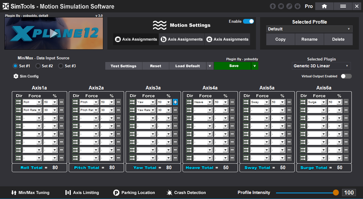

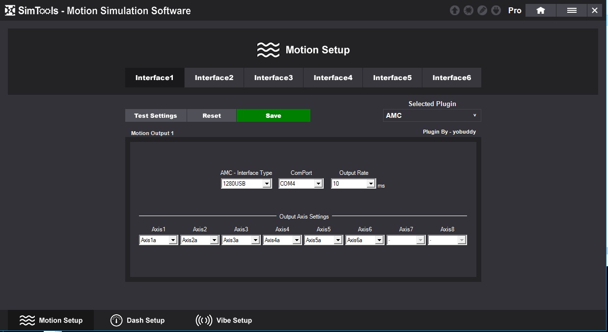

    Yes I got connection with Simtools V3 with the platform via USB AMC NANO interface. I'm able to test the rig on each individual axis but there are no standard axis assigned to the various motion options (pitch, roll etc....) If I assign the motion options to each actuator the test is not resulting in the corresponding motion. Put my problem in AI and this created some XML files with all presets but NO idea where to put those file or how to import them? If I connect it to XP12 the platform is only give a kind of vibration but no corresponding motion outputs.

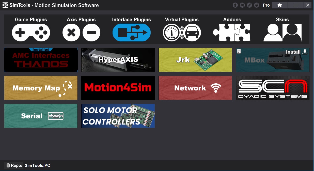

    My platform is responsive with the AMC interface although the interface/control box inside looks exactly like the Mbox, But I guess the Mbox suppose to be connected via LAN and not USB as I have.
    With these settings al motion looks the same. Heave should be all actuators up and down but as I test it, it is the same motion as I test roll or pitch.
    It also looks like when the platform is in the the neutral position, some actuators are not a their middle point. Is there a way to calibrate them?

    Hi, I read some where that with the generic 3d interface, you have to use axel1 for only roll actions (roll, roll accelerate, etc), axel2 for only pitch components, axel3 for only yaw actions.
    As it is written on the bottom of each axel column. Dont look at it as an axel but as an action.
    Also, the sequence of axises in the interface setup was different in my situation and I had to start with 4 going down like 432165.

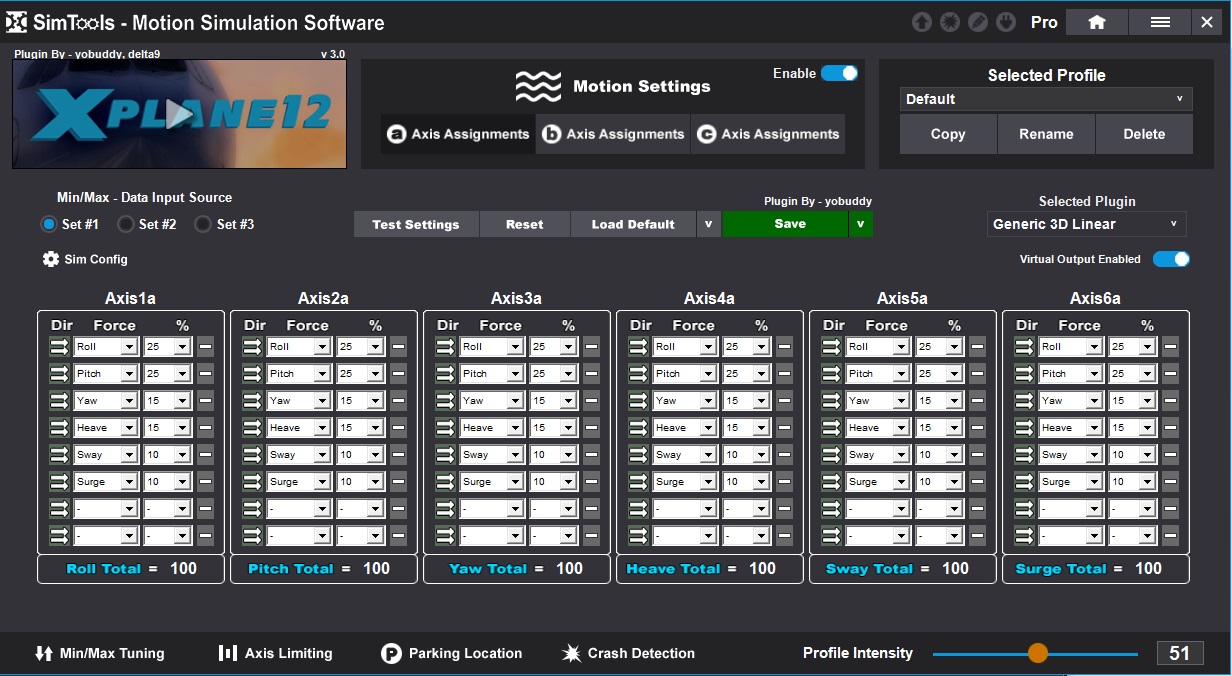

    I don't know if you corrected/changed the settings to what I mentioned before and if that worked (It would have been easier for me if you did) but...
    If you did, there are test options to test the correct movement of every separate actuator in the Dbox interface.
    Then there are test functions per game for axis testing after you filled in the items and % for each action.
    There you can check if the [roll] slider actual does roll movement and if the [heave] slider actually raises your whole platform on your motion platform etc. etc.

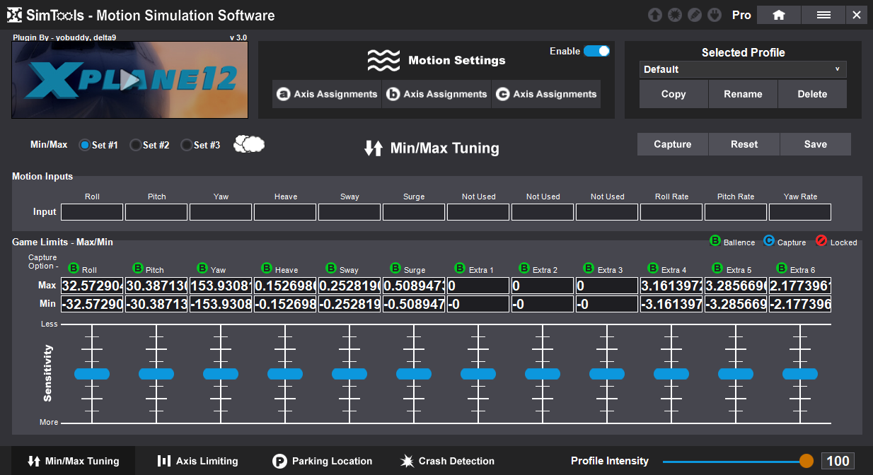

    I did not fly very often with Xplane 12 but here are my initial settings that are good enough to start with.
    For racing games I still prefer the proprietary "GodPlayer" software to interface with my LeaderDream motion platform .
