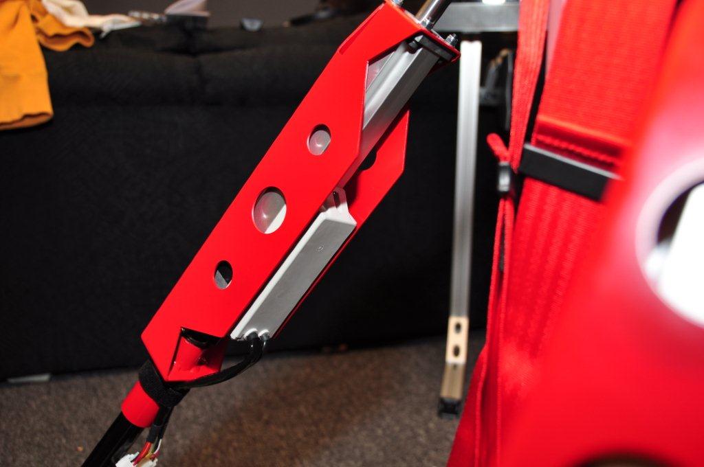

    I wanted to add some more dampening to my actuators so I decide to try the actuator covers from SimXperience that have adjustable inline dampening. When I received the package, I was absolutely impressed by the quality of the product. These things are definately over engineerd and are Tank tough.
    Here is a video of them in action :)
    http://www.youtube.com/watch?v=12zjQN3jEVQ
    The additional dampening made a big difference to the overall feel and makes the car suspension feel more natural. The ability to adjust the feel is a great option as well. Thanks Berney for great service and a solid product.
    ...Mike

    hi mike,
    this is the perfect dämpering for the scn5 very nice work bernard, i love it.

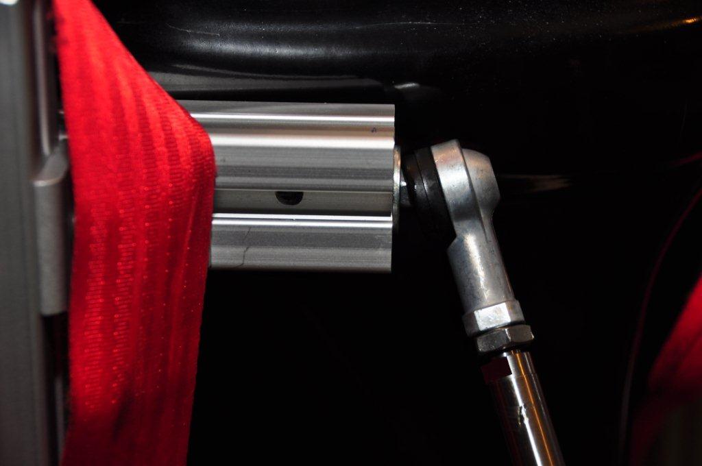

    Thanks ledfoot. Did you just use 2 smaller ball joints under your dampening bar? And did you use the same size rod ends for the upper and lower actuator arm as well as the stabalizer arms? Thanks

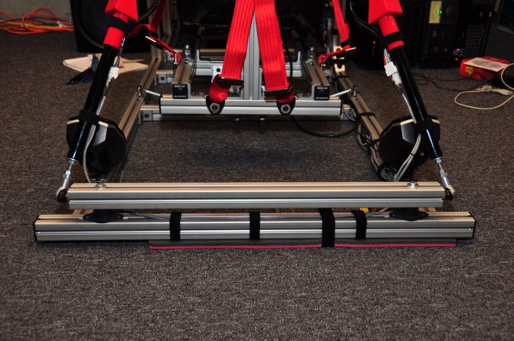

    Hi Brian,
    There are no ball joints under the dampener bar. I use 2 rubber dampeners rated at 115lbs each. The rod ends for the actuator arms are different thread because the SCN5's use 10mm 1.25 thread and the threaded rod at the bottom uses 3/8-24 thread. SimXperience can also supply the necessary rod ends.
    The dampeners were purchased from www.vibrasystems.com.
    ....Mike

    Hi Brian,
    There are no brackets necessary to mount the SCN5's they connect directly to the covers. Take a look in the SCN5's hardware thread for diagrams that outline the kill switch configuration. Just to note, the kill switch does not kill power to the actuators, it only stops them from moving but they are still initialized. if you want to totally kill them, you will need to build a circuit that will totally disable the power supply. I an only using the regular kill switch at the moment.

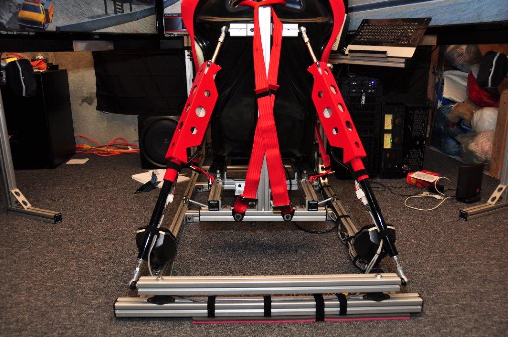

    Just starting to build my own 2dof as we speak. What are the new lengths of both extrusions that are connecting to the actuators on your rig, the one at the base connected to the dampeners and the one connected to the seat? Also, is the distance from that rear bar to the center pivot still similar to the original 'playseat measurements' you posted previously?

    Hi bwawyrk,
    Sorry that I missed your earlier question about the length of the extrusions. Please let me know if you still need those dimmensons.

    Thanks for the specs mike. If you have the time I'd love to see the dimensions.
