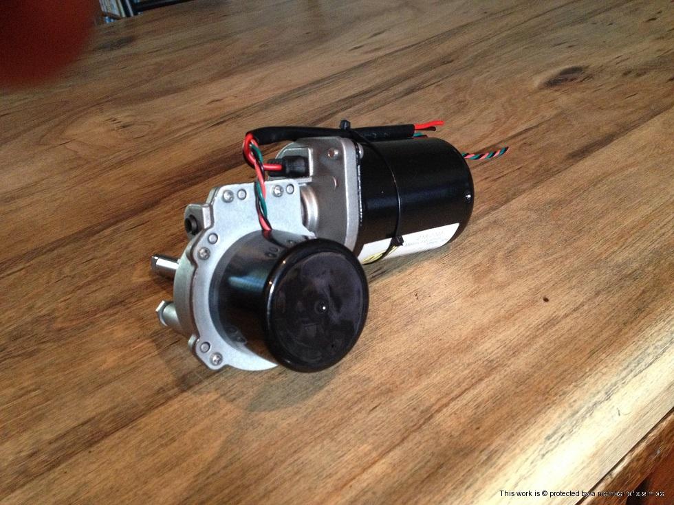

    One of the new motors, with rear mounted feedback and a nice little cover [​IMG]
    Also have on order some 14mm needle bearings with 11mm inner diameter to replace the junk bushings that come in these, and then an extra set to mount on the end of the shaft to catch the load. Er... mechanical load :rolleyes:
