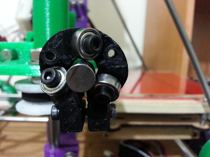

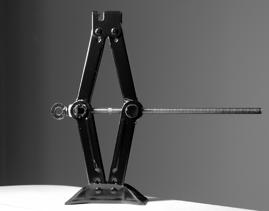

    Hi Speedy please do some google with DIY rollerscrew
    Regards Ad
  13. speedy
    speedy Well-Known Member
    Feb 1, 2012
    1,193
    Alexandria , Egypt
    7,951Coins
    +1,288 / 10 / -0
    Wow @adgun ... it took me a while to figure out what you mean ...
    But now " I see you :thumbs" ... Great idea that will work with these as magic

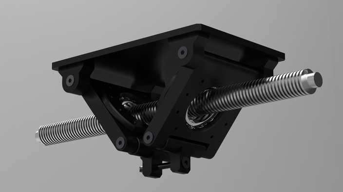

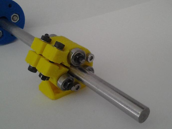

  14. speedy
    Feb 1, 2012
    1,193
    Alexandria , Egypt
    7,951Coins
    +1,288 / 10 / -0
    This one is even better ... Threadless Ballscrew :thumbs

  16. adgun
    adgun Active Member
    Jan 28, 2008
    538
    mechanic
    Netherlands
    5,801Coins
    +138 / 4 / -0
    Hi Speedy i like youre threadless ballscrew, with a hardend shaft GALLING problems are solved also.
    regards Ad

  19. speedy
    Feb 1, 2012
    1,193
    Alexandria , Egypt
    7,951Coins
    +1,288 / 10 / -0
    Any ideas making the Nut without 3d printing ?
  20. noorbeast
    22,208
    154,711Coins
    +11,211 / 57 / -2
    Just a reminder, if you need a 3D printed part but do not own a printer then you could use the world wide directory of those who do and who can print a part for a small fee: https://www.3dhubs.com/
