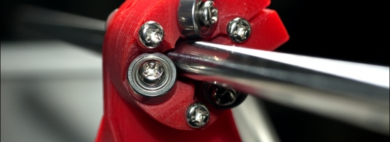

    @speedy (Any ideas making the Nut without 3d printing ?)
    You only need a drillpress that can drill on a angle.
    With plastic you can use a speed bore (for wood) to make the bearing places.
    You dont need to work precise ,with 3 bearings its centering when clamping
    Regards Ad

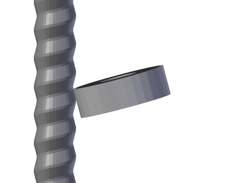

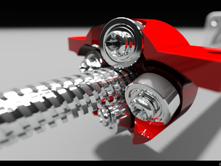

  12. noorbeast
    22,208
    154,711Coins
    +11,211 / 57 / -2
    Just a some suggestions.
    You can download the 3D print file for threadless ball screw here @speedy, if you want to give it a go: http://www.thingiverse.com/thing:112718
    And if you need a 3D printed part but do not own a printer then you could use the world wide directory of those who do and who can print a part for a small fee: https://www.3dhubs.com/
    You can also get a drill press pretty cheap these days if you know what you need and shop around.

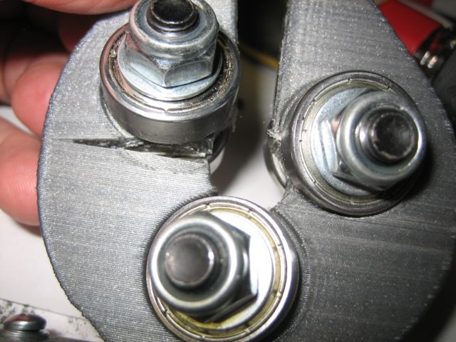

  13. speedy
    speedy Well-Known Member
    Feb 1, 2012
    1,193
    Alexandria , Egypt
    7,951Coins
    +1,288 / 10 / -0
    @noorbeast ... Really cool :thumbs ... The issue with 3d printing is you wont get solid nut that can withstand the force and torque ... it may split and crack easily ... even if the print orientation changed ... it will just crack from another place .
    http://forums.reprap.org/read.php?14,328230,328627#msg-328627
    I just believe it can be made with these metal brackets ...
    And I keep turning my thoughts 70-80 degree to convert it from linear to circular and I fail to figure it out every time :grin

  15. noorbeast
    22,208
    154,711Coins
    +11,211 / 57 / -2
    If splitting is the concern then machining rather than 3D printing would be the better option.
