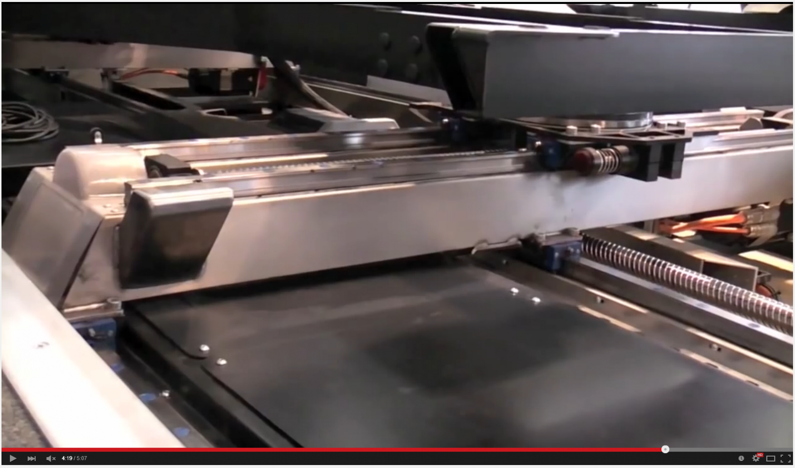

    I'm not quite sure i follow - are you saying your examples are not ballscrews? :confused:
    this one seem to be a combination of ballscrews (ground not rolled screws). V-track rollers to guide it. And rack+pinion...

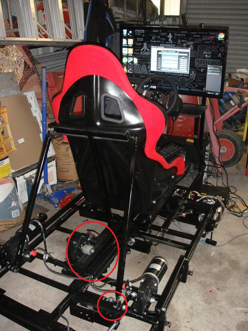

    Just for information, I actually tried rubber wheels on a steel rubber layered track for my traction loss and surge table and on high inertia changes in direction they just slipped (basically burnt rubber as the feedback pot was on a separate wheel :p). Ended up changing to a chain drive system. I had some high tension springs on them as well.
